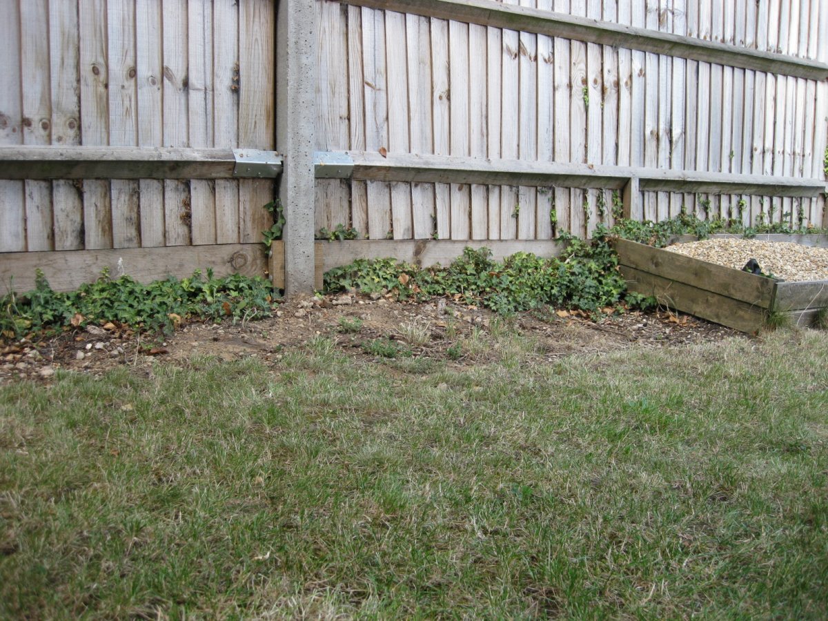

Here is a photo from my garden. I want to get rid of that current box and replace with a raised bed the whole length of the fence using sleepers. The width of of the bed will probably be similar to the box shown in the photo. I would like the top of the raised bed to be level with roughly the top of the gravel board. However this means the gravel board will be in contact with the soil so should I put anything something between the gravel board and soil to prevent rotting?
Thanks.
Thank you.
I'd try and source some waterproof tarp/plastic sheet?
Vertically stapled along the length of the fence, and Stanley knife cut to a desired height, ideally slightly over the fill level of the bed.
Where joints would inevitably be made, simply over lap generously, and stapling tight to stop rain penetration.
Ascetics wise, to get a neat line in your tarp, you could try and fix a long 1x4" lengthways on the fence base, to staple the tarp onto, and the cut a neat line along the top.
