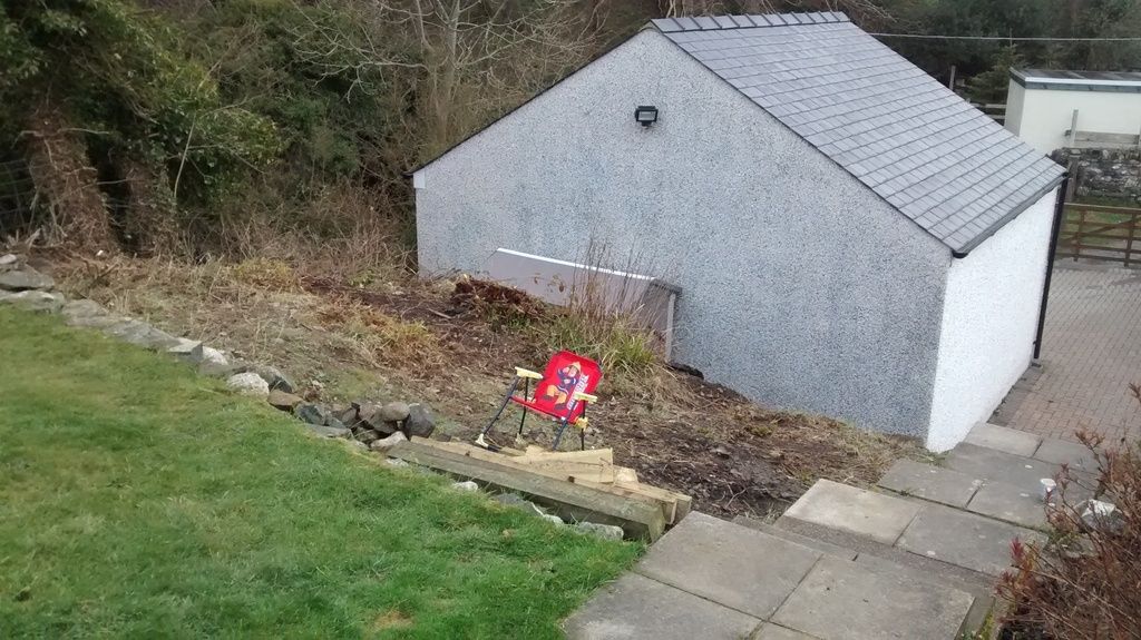

I'll start by showing some pics of the proposed site -

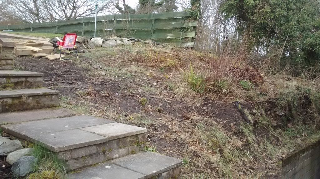

I've never known what to do with the area, it's quite large so could become a handy sitting space to look out over the garden. I'm an electrician by trade but really want to do this project by myself (with a bit of help).

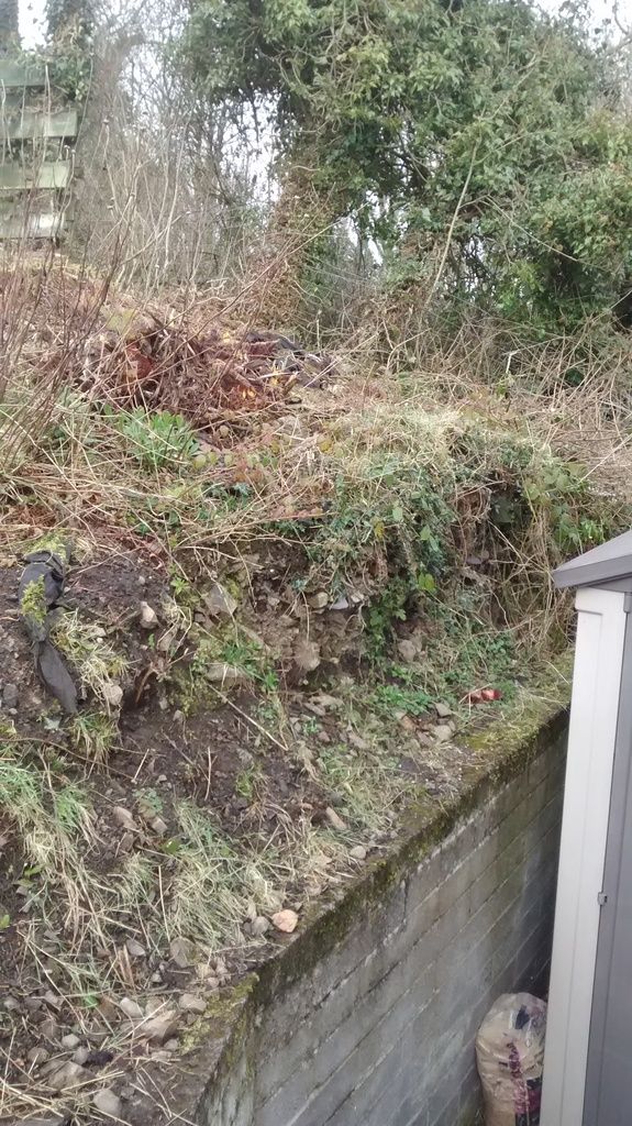

I have one concern though, the garden has previously been 'dug into' to make room for a garage. A retaining wall was then built but as you can see there is an overhang of earth above this retaining wall.
I will need to concrete in some 4x4 posts but I'm not sure how to approach it with the garden just stopping like that, does that make sense? Should I remove this earth first to create an even slope and then dig my posts in?
So first things firtst will be getting the 4x4 posts in, any advice or ideas would be appreciated, what would you do etc :D
Cheers guys.
The ground is going to erode so it needs digging out or retaining.
If you wanted you could use recessed concrete posts with the concrete gravellboards that fit them.
The gravel boards would be used as the the retaining wall and the recess could be used to fit a decking joist.
And as you would have concrete in the ground instead of timber no worries about it rotting.
Personally I'd worry about putting another retaining wall close to, and ultimately transmitting loads to, the existing one. If it all goes t**ts up that shed will be a goner, and the garage might get damaged.
Removal and disposal (what's on the other side of that green fence? ;) ) would be better, IMO.
