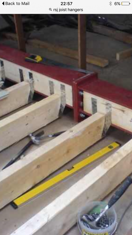

You might be better served to drop two steels in gable to gable then ... You can then hang the new joists from that independently of the existing structure and also support any roof load too.
For all this part way conversion to feasibly add value to your home then a full conversion needs to be looked into for head heights stairs possible position etc ..... Otherwise it's just a posh loft which has different dynamics.
Im part way through my full loft conversion and have had to chip off a few bits of plaster from the laths, no damage to report but mine are in good condition so go carefully.
As for the structure I would seek the advice of a structural engineer, I paid £200 for mine and he saved me a fortune in rsj's by specifying doubled up beams
I considered that option of using two or 3 RSJs from gable to gable, one at the ridge level, with collar ties to strengthen, but ruled out as I would lose too much volume at the lower usable end, that would mean reduced height and less head room and usable space. RSJ is easily going to be roughly 150 to anything around 200mm in height and around 18 foot across, and I would then have to use floor joist across them losing even more height, space is the whole point.

Like this
Oh I did, yes i actually saw that video from which you took that picture, yes that would not lose me too much valuable space, so I will make a few enquiries to see who could supply and fit RSJ sif I took that route .
