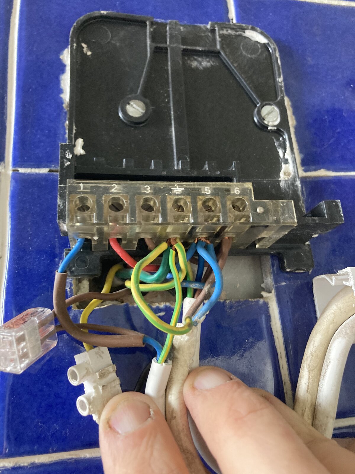

I have come to replace my Randall decrepit controller with a shiny Honeywell.
I have a oil boiler with pumped hot water tank and hall wired thermostat.

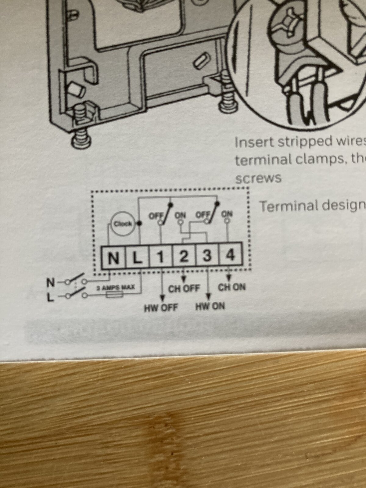

I have looked around for equivalent wiring diagrams but they tend not to match mine.
So can anyone explain what goes where please?
Thank you in advance.
Stuart

Hi Stu,
Going from Randall to Honeywell
6 (Live) to L
5 (Neutral) to N
Earth to a connector block
3 - remove link as it’s not needed in the Honeywell
1 to 3
2 to 4
