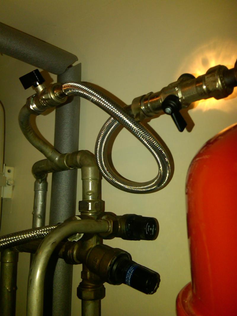

Hi there. My CH System is making lots of noise, and I noticed the pressure guage on the red expansion vessel reads a little above NIL.
I would appreciate advice on how to increase this. There are plenty of valves around, but most seem to remove water to drain.
Please help me. Thanks in advance.
Chris
Thanks Kev. I can see one of those already connected between the red expansion vessel and what looks like a main pipe. I can move the valve at one end but the valve attached to the pipe coming from the red expansion tank i just cannot turn ! any additional advice would be appreciated. and thanks again.
depends on the make age of the loop some only have 1 valve if the other one has an hexagon nut on it dont touch it :cry:
can you post a pic of the setup :idea:

The valve i cannot twist is the one nearest the red tank. the other side of the valve has a black plastic cap with a cross cut into it !
thanks again.
ok remove the screw on the valve and get a small adjustable wrench
work it back and forth but go steady probably just sticking
turn the other valve off while you do ;)
Thanks again kevin. i will let you know how i get on. will need to get a wrench ! although will try a pair of pliers i have. So by opening both valves, this allows water into the CH system, and therefore repressurizes the system. have i got the gist ? thanks.

I can confirm that I have increased the pressure....at last ! Thanks so much, my friend, for all your assistance.....and time. :D
