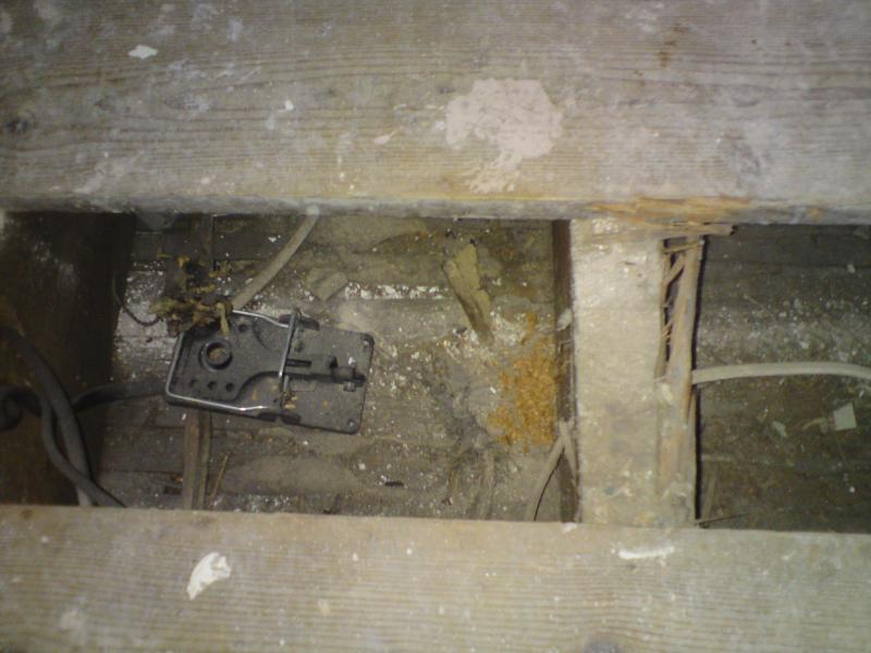

Yes and here is a rat in a trap that was rotted away, his head is missing and there is another rat nearby (also dead) that has eaten his head and presumably died from eating it and poison. Oh what a life.

Aswell as the wiring to be addressed is there an obvious route in for the rats that could be 'plugged' Trev? You're right in saying that could be hard work but things like made up firewalls in the roof space would serve you well in any case. Often in an old terrace the cavities run continuously which doesn't help you. And what's their food source? Any broken pipes/drains about? Not sure what your external environment is like.

The exterminator has been in and left some test bait to determine if the run is 'active', he will go from there. We did put in a fire wall when we moved in to one side, however the other side was bricked. I suspect as you say that the cavity is continuous (or at least open enough for a Rat) downstairs is suspended wooden floor so it wouldn't surprise me if they can get all the way along under the houses too.. could be interesting, I suspect it would be very difficult to make the loft rat proof..
