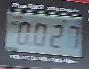

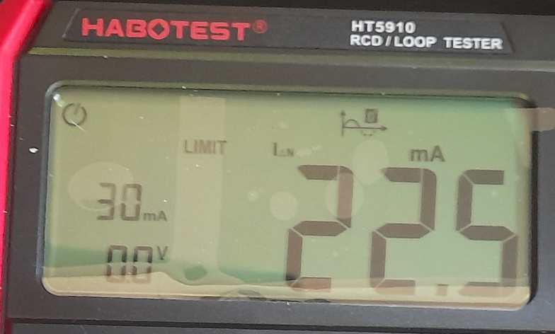

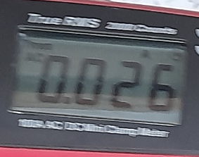

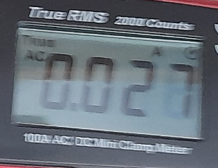

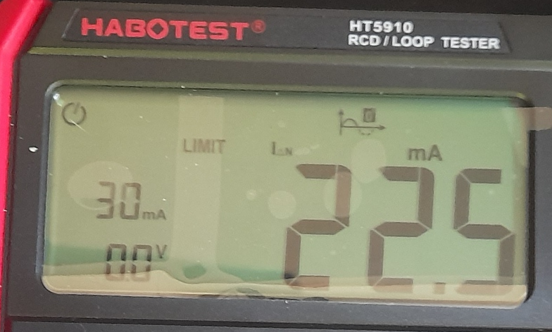

Checked after power restored. Ramp test 1747313441037.png 22.5 mA, before resetting RCBO 1747313514315.png after 1747313571396.png so it seems some leakage on the other 13 RCBOs, but not too worried about that leakage, but when my son is here, seems prudent to do some more tests.
Just glad the freezers were on an UPS so no time pressure to find the fault. Since the dishwasher was not running, seems likely a neutral - earth fault.

Checked after power restored. Ramp test <...> 22.5 mA, before resetting RCBO <...> after <...> so it seems some leakage on the other 13 RCBOs ....
I don't fully understand what you are saying here. Don't forget that a 30 mA RCD (RCCB or RCBO) may operate with residual currents as low as 15 mA, so a ramp test result between 15 mA and 30 mA does not necessarily mean that there is any 'leakage' on the circuit.

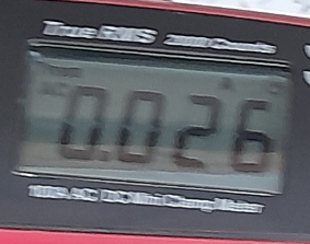

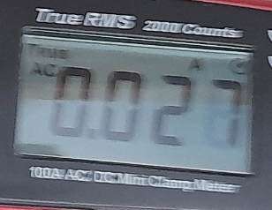

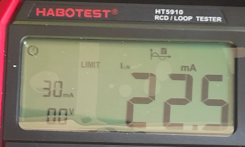

Checked after power restored. Ramp test View attachment 381624 22.5 mA, before resetting RCBO View attachment 381625 after View attachment 381626 so it seems some leakage on the other 13 RCBOs, but not too worried about that leakage, but when my son is here, seems prudent to do some more tests.
