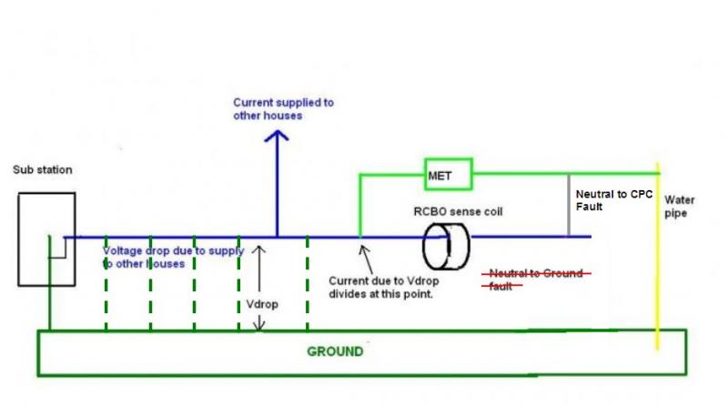

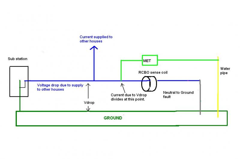

Try the same but with the RCBO's live output disconnected. If it still trips then it can only be current on the neutral through the RCBO sense coil and that has to involve a neutral to ground current. That current could be flowing from a neutral to a CPC fault and then via a CPC to ground connection such as a bonded metallic service pipe.
Although the path to ground via the water pipe or other bonded service is very low impedance any current due to Vdrop will still be shared with the path through the sense coil and this can easily result in more than 30 milliAmps passing through the sense coil. ( I have measured over 100 milliAmps flowing from a CPC (derived from incoming neutral) down to an earth rod )
One thing that comes to mind, is the MET actually connected to the incoming neutral ?
If not then a neutral ground or neutral CPC fault would put all the current from Vdrop through the sense coil.
I'm a little confused, since this almost seems like a response to the exchanges Bernard and I are having in the 'other thread'. Anyway, in terms of this thread, a couple of points.
Firstly, you have drawn a TN-C-S system, but without the PME. If one adds the multiple earth connections (see below) the PD between the incoming neutral (hence MET/CPCs) and true earth will be consdierably less than the voltage drop in the supply neutral cable (your "Vdrop").
Secondly, and most importantly, your diagram relies on a N-to-True Earth resulting in operation of the RCBO. However, there is no way that plugging in a test appliance could create that (if anything, it would create an N-CPC fault, as illustrated below). If it were a 'permanent' N-True Earth fault (i.e. in fixed wiring), the RCBO would obviously be permanently tripped. The only way I can see your hypothesis being relevent would be if there were a permanent N-True Earth fault on the circuit resulting in a current <30mA flowing through the RCD AND Martin was using a test appliance which introduced a further N-CPC fault, tipping the current imbalance in the RCBO beyond the 30mA threshold. That seems very unlikely but is, in any event, the reason I suggested he tried with a different (simple, smaller and resistive) test load.
Kind Regards, John
