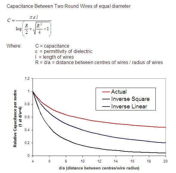

One thought about their figure of 150pF/M. I've just stuck a capacitance meter across an old, regular 6.8M long piece of 2.5 T&E. L-E measured 880pF and N-E 875pF, so it's coming up at about 130pF/M. Fine, not a bad match for their 150pF/M. But that's for 2 wires in intimate uniform contact along their entire length. ie for the same piece of cable or a radial leg.
The capacitance will tail off with cable separation, I was going to guess that the rate of tail off would be inverse square law but it turns out that parallel wires are an inverse natural log function, so perhaps inverse square like, if my dodgy maths holds up. But either way the capacitance will fall away fairly quickly with even a small distance from cable to cable. So for that reason even if these cables were sandwiched together in conduit, I'd guess their capacitive coupling wouldn't approach 130pF/M. Add to that that they'll probably not be close coupled for that far in a house before they go their seperate ways, so I doubt the effect you see would be inter cable capacitance. Unless the system was so close to the edge that the RCDs were on a hair trigger for other reasons.

[nerd mode] - for nerds only - others please ignore :)
For reasons I explained yesterday, I agree with you that, except in the most marginal of situations, it is incredibly unlikely that there would be enough capacitive coupling between conductors in domestic wiring cables to significantly affect the operation of an RCD or RCBO on a single circuit – as I said, one would be very hard-pressed to get as much as 1 mA such ‘leakage’ on any single circuit. Furthermore, I certainly agree that capacitive coupling between cables in two different domestic circuits is going to be essentially negligible (with any such ‘leakage’ likely to be very much less than 1 mA.
However, in terms of the maths of what you say, I don't think that it is quite right. The relationship between the capacitance between two wires and the distance between them is not quite as simple as ‘inverse natural log’. As can be seen in the equation below, it is the ‘inverse natural log’ of a function of the ratio of wire separation to wire radius. Interestingly, it’s only this ratio that matters, not the absolute dimensions – hence the capacitance between 1 metre lengths of two 1 mm radius conductors with their centres 4 mm apart will be the same as the capacitance between 1 metre lengths of 10 mm radius conductors with their centres 40 mm apart, or 100 mm radius ones 400 mm apart.
Anyway, my point is that, far from being “inverse square like” (as you suggest), the relationship between capacitance and wire separation is actually a surprisingly ‘weak’ one, in fact significantly ‘weaker’ than even a ‘inverse linear’ relationship – as illustrated in the graphs below. For example, if one doubles the separation/radius ratio (e.g. double separation without changing wire diameter) from 4 to 8, the capacitance only falls to about 64% of its original value, whereas it would fall to 25% with an inverse square relationship or to 50% with an inverse linear relationship. Intuitively, I would not have expected an inverse square relationship (since the ‘lines of electrical force’ are all essentially in one dimension), but I would have expected it to be fairly close to inverse linear (which is the case for two, relatively close ‘plates’) – which I suppose it roughly is.
However, as I said, despite all this (which makes capacitances between different cables a bit higher than you were imagining), I certainly don’t think that ‘between-cables’ capacitance is even remotely significant in the context we’re discussing.
[/nerd mode]
