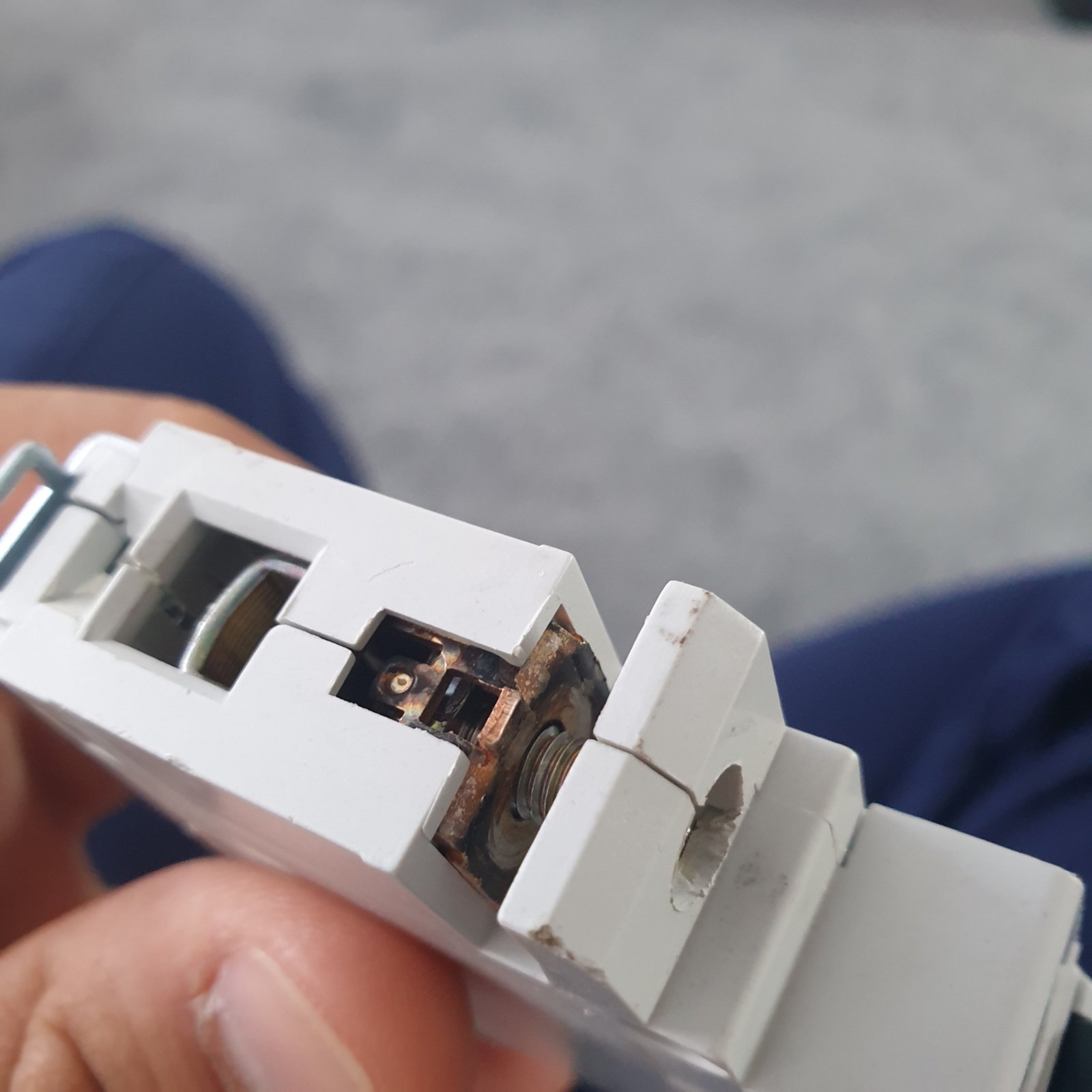

Hello, just an update regarding this. RCD went again today, washing machine on aswell as fridge and seperate freezer. It tripped when the washing machine has 5 mins left of spin cycle.
Bingo we though . Unplugged but rcd not turning back on. All other items unplugged and the same occured
My regular Electrician called again, he came over the started at the consumer unit. Below is what he found. Bear in mind that this was newly installed last year and i have the paperwork
He firstly tested the legs of the live, earth and neutral and said he cant see anything wrong with the wiring and then discussed testing the rcd. We had a long chat about about why the mcb tripped the other day and now rcd

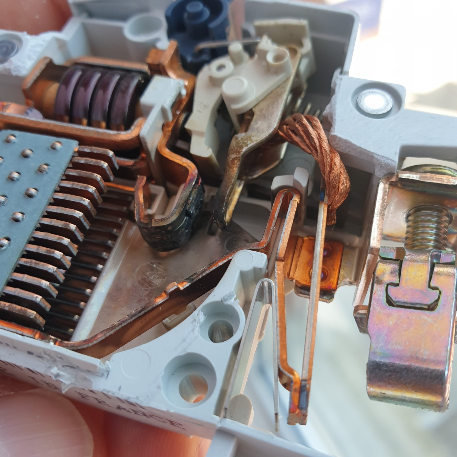

He went to terminate the cables and in the b32 mcb for the sockets he found the bottom screw more or less completely undone. He removed the offending mcb from the board and examined it. He showed it to me and showed me where it had overheated and discoloured the copper.

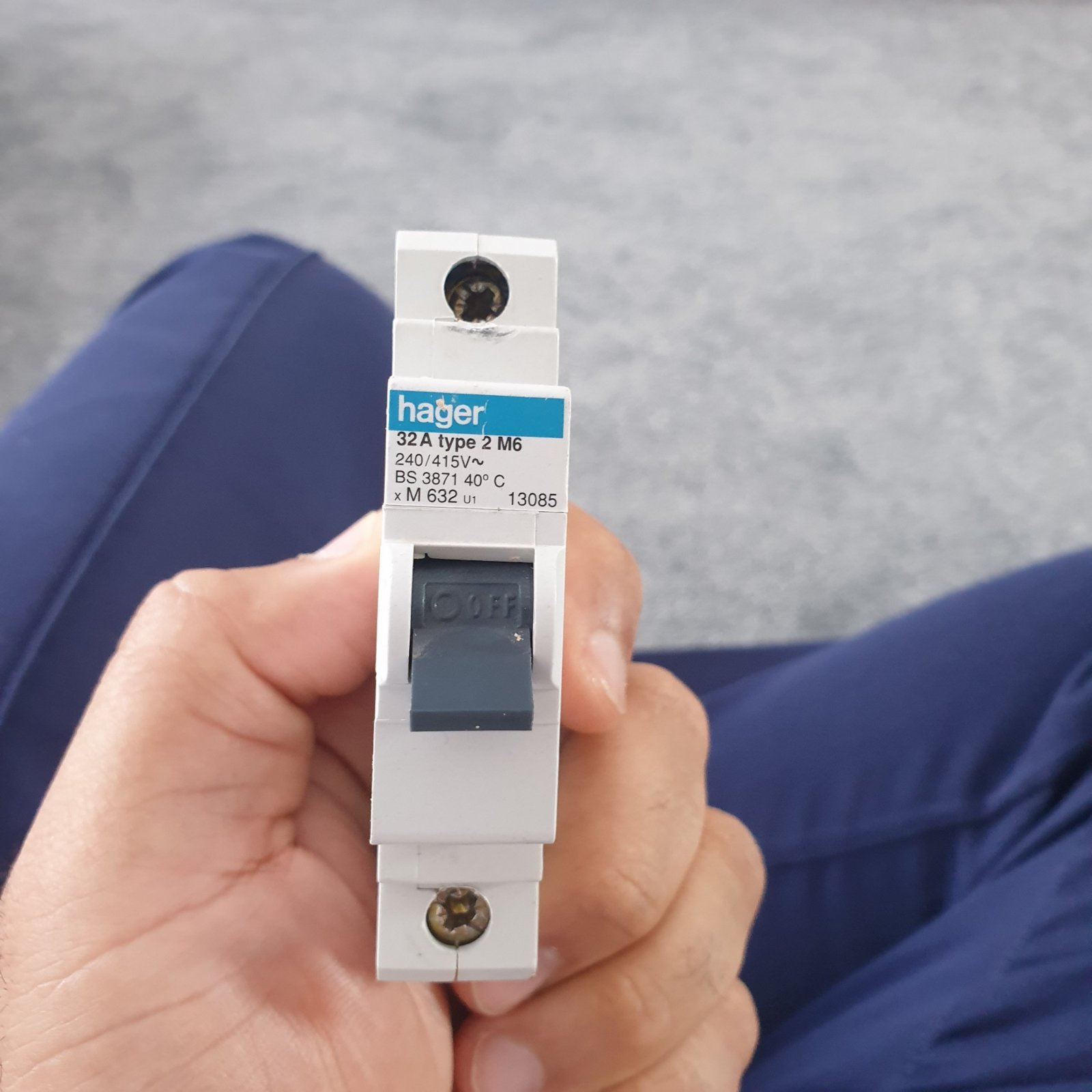

He also said that the board is new and someone has thrown in a random old mcb. He said it was a type 2 and it needs to be a type b
He also said he he thinks the one that was installed was meant for a 3 phase board and not this.
He initially tightened it then put a meter on it and said he was not happy as the voltage was fluctuating. I did ask what this means, he explained but it went over my head.
He went back to his van and replaced the mcb, asked me to put all appliances on in the kitchen whilst he was there. We duly did and it was fine.
He has left saying that he cant see any issues with the wiring and he strongly feels it was the loose mcb causing this. He left confidently saying he doesnt even think its the appliances.
I dont understand why though a loose connection on the bottom of the mcb would cause either the mcb or rcd to go? I would have thought only the mcb due to overheating? Or is there some other wizzardary to RCDs
i have attached pictures of the MCB, he asked me to open it and see for myself as i was in disbeleif, yes, it is burned at the contacts

An MCB can usually trip from an substantial overload or short circuit (fast) or with a thermal trip (overheating) or magnetic, slower.
In your case, it's likely that the poor connection from the loose terminal screw was overheating, and this eventually raised the MCB enough for a thermal trip.
The "loose screw" is a bugbear that people try hard to avoid, using techniques like checking the tightness of all screws before putting the cover on, or marking each one after tightening with a touch of chalk or something.
thank you, it wasnt even like it was tightening, the screw was literally pi$$ing in the wind so to speak. i understand the mcb tripping from overheating as a result of a loose screw, my curiousity wants to learn how this would make the RCD to trip more than the actual MCB. the electrican said was there would have been an inbalance but this is where i got confused.
It's definitely an older one, BS3871 was replaced by BS EN 60898 in 1991.
The blackening inside is exactly what you would expect to see in a 30+ year old circuit breaker that's been tripped on overload/short circuit a number of times.
Loose connections will cause overheating which can trip the MCB. That won't trip an RCD, as that requires an imbalance between L&N.
RCDs sometimes trip oddly. Sometimes for no reason you can find. Sometimes electronic equipment can cause it. I don't know if the poor connection was sparking or something that could cause it. I used to have an RCBO that tripped several times, until I unplugged the digital timer socket on a table lamp with a CFL. It's now got an LED in it, and has tripped, I think, once in about five years. If it happens again I'll bin it.
I have had RCDs trip due to a loose connection and subsequent buildup of heat.
But I cannot understand why a fault that caused the RCD to trip would affect the physical resistance of the switch mechanism.
Is it one of the brands that has to be pushed further "off" before it will go to "on?"
