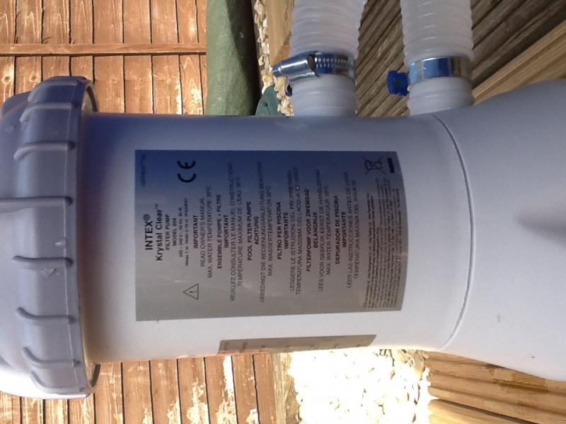

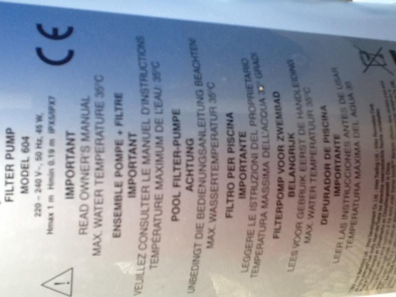

Thank for you're help with this, when I first set this going I thought the fault could be with the RCD I fitted so I was going to replace it and try that, but didn't want to waste money if the fault was of a different nature and that's why I've ended up on this forum, do you have any thoughts as to why the pump runs slower from the weatherproof socket I installed,but runs normal from the conservatory socket fitted by the electrician

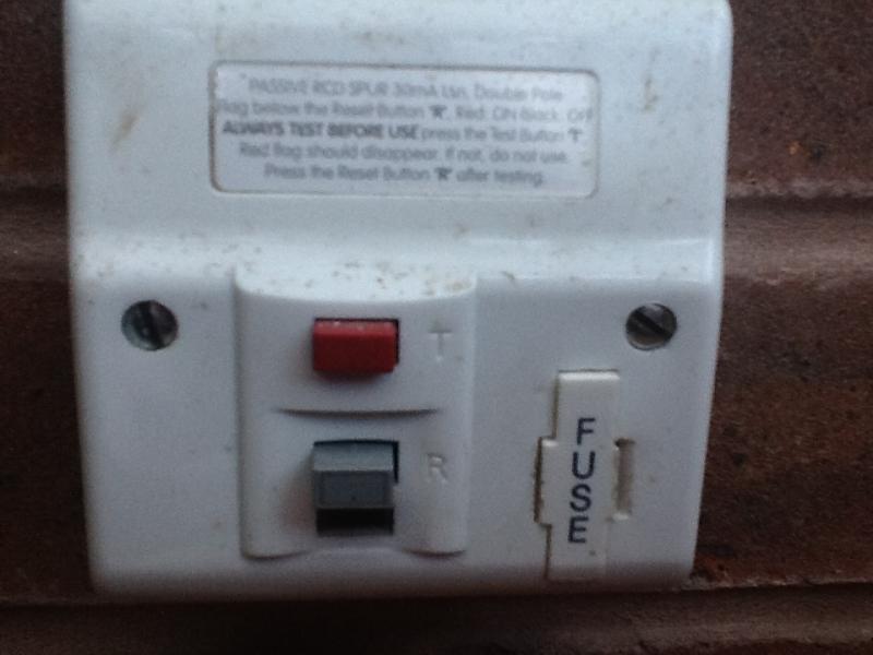

From everything you have said I would think the RCD is faulty.
The pump running slowly is probably a poor contact within the RCD and
as it will not reset after the plug is removed also indicates the RCD is faulty.
It's a passive RCD spur 30mA Double pole flag, don't know the make
It's one I've had a while, it was on another system I was using, which I got rid of so it was spare, I can't remember where I brought it but it was around the £25 mark, I didn't think these type of things degraded over time in performance, maybe that's the case, I'll do what I should have done when it started to trip, I'll buy a new one, and hope that's the problem, i hope i haven't wasted anybody's time with this.
Nothing lasts for ever.
I'll buy a new one,
You don't need one as there is an RCD in the CU.
No point having two in series - except belt and braces - with a fault they should both trip.
Just connect the outside socket to the inside socket.

Thank you again, the reason I put the RCD on was to be able to switch the pump on or off from inside the house, and now since you guys have pointed a few things out to me, it's obvious what I was doing was over the top anyway, so I guess I could just put a switch in, or the cheaper option as you've said, wire it to the back of the socket and if I have done something wrong then it will trip at the CU.
Thanks again
Well, 2 hours ago i fitted a 13amp Crabtree FCU and the pump is running normal and there's no problems, £3.61 from Screwfix, I should have done that days ago - thanks to all who contributed !!!!!!!!
