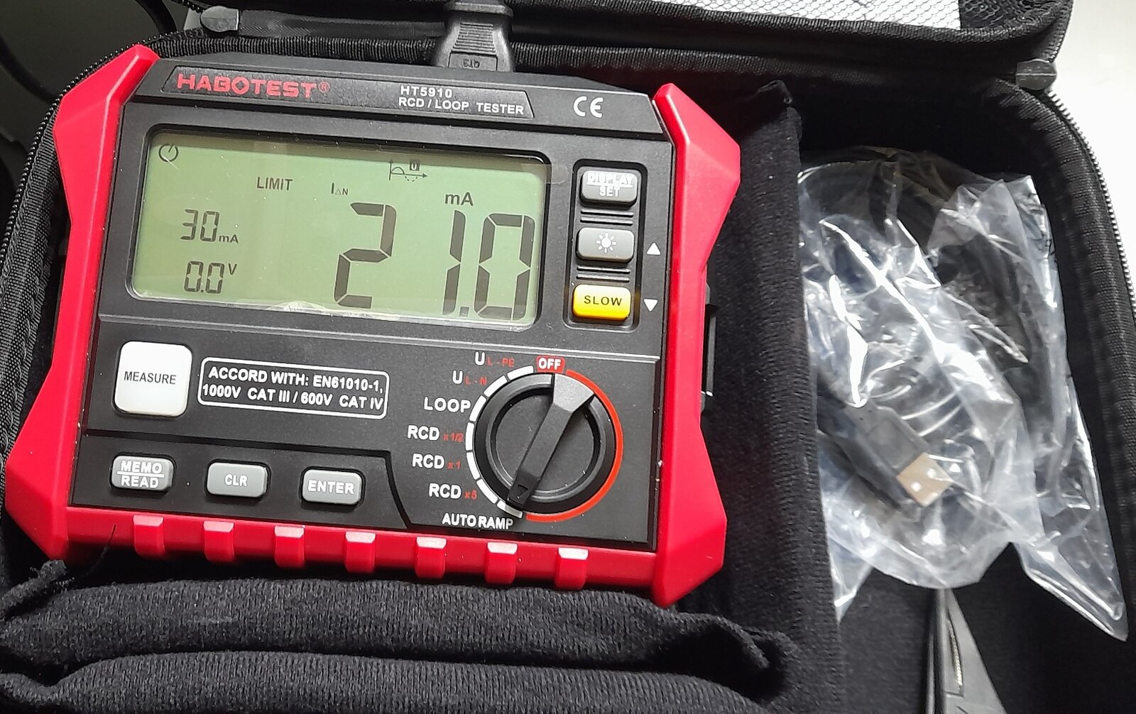

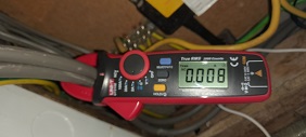

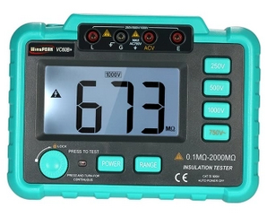

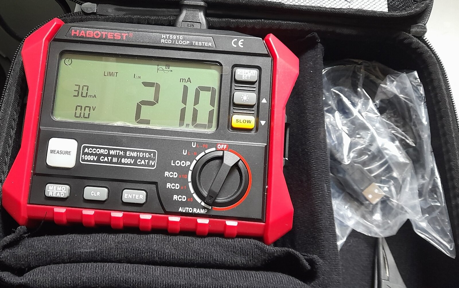

So three tools, the clamp-on Diffrence line neutral 8 Feb 24 reduced.jpg shows what is leaking, there is always some leakage, due to using AC, which means some capacitive and inductive linking, but it will only help if it has not tripped, the insulation tester VC60B.jpg will test when no power, but it uses DC, so it can give false sense of security, and of course the RCD can be faulty so the last one RCD tester ramp.jpg tests the RCD, and shows at what point it trips, your looking at £200 worth of test gear, and also some skill is needed to use it, I have all shown, and I did have the RCBO which covers front kitchen sockets trip, I did the normal unplug all I could, of course it was the last items, which included the dish-washer, I assumed that was the faulty item, so tested it, not fault found, so tested RCBO no fault found, and tested total leakage as you can see just 8 mA, plugged it back in, and it has now been running at least 2 months with no further trips, so even with the equipment and skill, I have no idea why the RCBO tripped.

So three tools, the clamp-on View attachment 401453 shows what is leaking, there is always some leakage, due to using AC, which means some capacitive and inductive linking, but it will only help if it has not tripped, the insulation tester View attachment 401451 will test when no power, but it uses DC, so it can give false sense of security, and of course the RCD can be faulty so the last one View attachment 401452 tests the RCD, and shows at what point it trips, your looking at £200 worth of test gear, and also some skill is needed to use it, I have all shown, and I did have the RCBO which covers front kitchen sockets trip, I did the normal unplug all I could, of course it was the last items, which included the dish-washer, I assumed that was the faulty item, so tested it, not fault found, so tested RCBO no fault found, and tested total leakage as you can see just 8 mA, plugged it back in, and it has now been running at least 2 months with no further trips, so even with the equipment and skill, I have no idea why the RCBO tripped.
