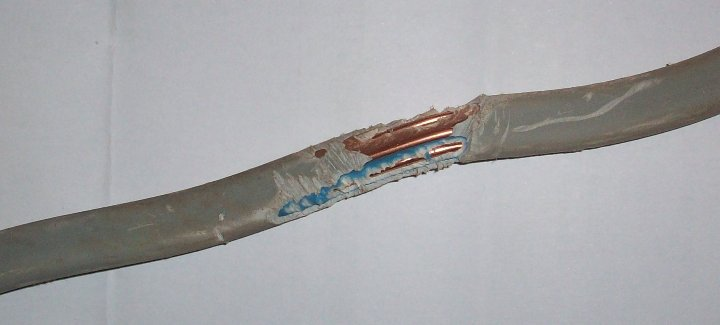

Also had mice in the past but no sign of them for a while since I poisoned them six months ago.
Certainly not impossible .....

As the problems crops up when it's wet, the most likely cause is the outside sockets, but Johns picture proves that everything's possible. As previously said, the rusty boxes aren't an issue, and the cables in the walls won't be, so unless there surface mounted cables that the mice could get to, it's unlikely to be that. If you're up to it, I'd take off the front of the outside sockets, and check they are dry, and see if there's any cable damage outside. The next thing would be to take off the fused spur, and disconnect the wires from the back, but that might be best for the electrician to do, but it is possible that the cable going through the wall have been damaged, and that might be the cause.
