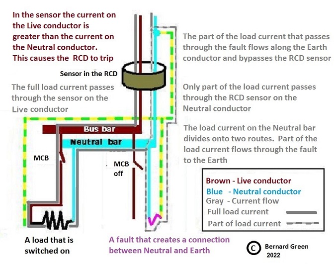

A neutral to eatrth fault can still trip the RCD even with no load on that circuit.
It will likely happen when there is a relatively large load in use in the rest of the property.
The way I think of it is that a fraction of the current "returning" from the large load on the neutral side ends up going to earth through the fault in the rcd protected circuit, rather than taking the nornal route out through the incoming mains.
If that fraction of current ends up being over 30mA then RCD trips.
I'd be looking at the wiring to the unconnected extractor first.
I don't think Zs or R1+R2 would help with a neutral/earth fault. An IR test might tell you something. I'm not a sparky though.

so you’re saying high loads that can leak current before the rcd can cause the rcd to trip even though it’s before the rcd?
The "leak" is from Neutral to Earth via the fault. There is no fault in the load.
The fault provides a route for some of the current from the load to bypass the Neutral conductor in the RCD sensor.
No, not really. We are saying that a fault after (or downstream) of the RCD may only trip the RCD when a high load is in use elsewhere in the property.
ah yes coming back on the earth through the neutral causing an imbalance. So if i megger N-E from the rcd this may find the fault?
I agree with Bernard.
I would be very surprised from your description if it wasn't a neutral to earth fault after the RCD. Sure, it could be a bad RCD but you said it tested fine so I find that unlikely.
One thing not mentioned yet is that a neutral to earth fault usually means a low resistance or short between CPC and neutral wires, but it could also just be a neutral wire touching anything "grounded".
I would disconnect the lights and extractor wiring from the RCD and do a normal insulation resistance test between neutral and CPC etc. on all the cables downstream of the RCD and take it from there.
