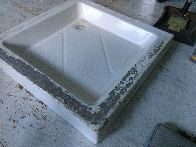

Hi.
I picked up a used shower base that has lost some of its coating as you will see from the attachment. What can i use to re-coat it?
Cheers
Personally I think you'll have a hell of a job with that one......if it's fibreglass it's lost the gel coat, if it's acrylic it could just about be possible to sand the roughness down and re-establish a surface with various grades of wet or dry abrasive paper.
John :)
Its not fiberglass. Its some sort of molded concrete. It's heavy as hell. Ok forget about coating what's the toughest paint I can use to at least make it look cosmetically decent? Cheers
It looks like cast concrete (maybe from an industrial application in its past?) I think I'd be looking at a specialised concrete paint, maybe the sort that's used for painting garage floors.
I believe Regal is one of the best products around.
John :)
You could get a company to coat it in resin - but it would cost about 8 times the price of a new tray.
Burnerman, freddiemercurystwin, Thank you for your constructive comments.
I'm definitely going to go for the specialised concrete paint option. Coat it a few times. I know it looks a mess but it was free and there's no damage that warrants it unusable.
