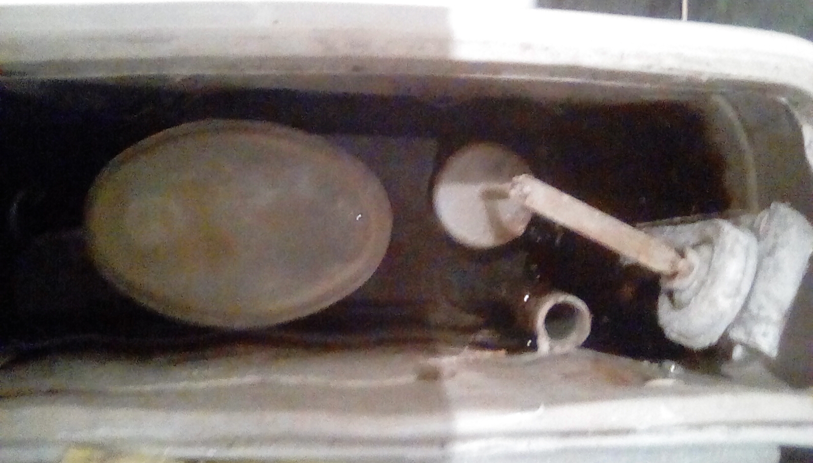

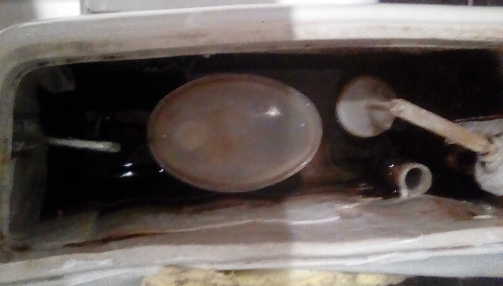

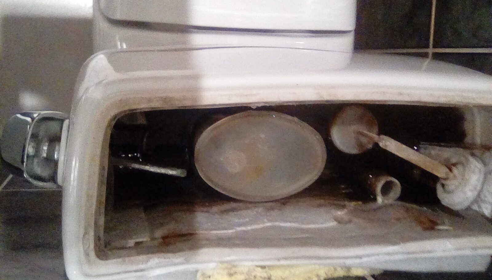

Don,t know if these help.
Ignore first, test
as you can see, even lagged inside to try to stop condensation, no good though.
