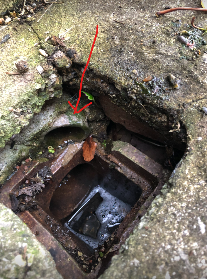

The existing outfall from the asbestos pipe goes into the rainwater gully. The gully is a bit of a mess and will be replaced, but there is only a very short stub of asbestos pipe that a sleeve could be fitted to. I'll try and add a photo later. I think that's why the drainage person suggested the other option in the first instance, as the sleeve option is quite awkward.

This is the pipe outfall. The rainwater gully will be repaired/replaced so either way that has to be carefully taken out. The stub of the asbestos pipe is a little bit shorter now because the company that tested it took a small piece from the end. Could a sleeve go inside to make sure that water was well directed into the gully?
If you treated it as a "repair" you could just smash out the entire maintenance liability of an installation and replace it with modern 110mm uPVC drainage pipe and fittings, with one reliable connection to the main drain, it all looks fairly shallow, and there's nothing technically challenging about it.
