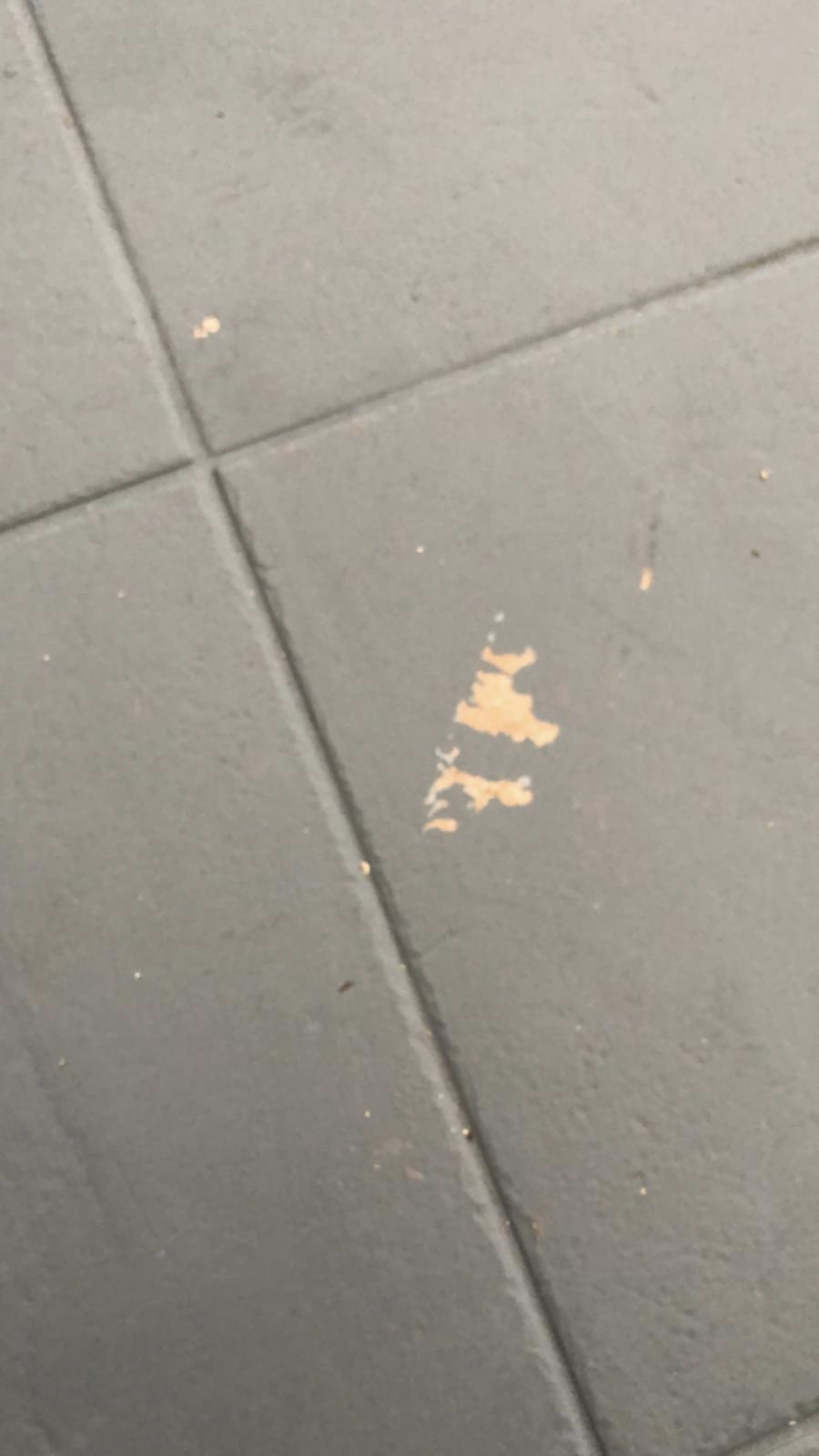

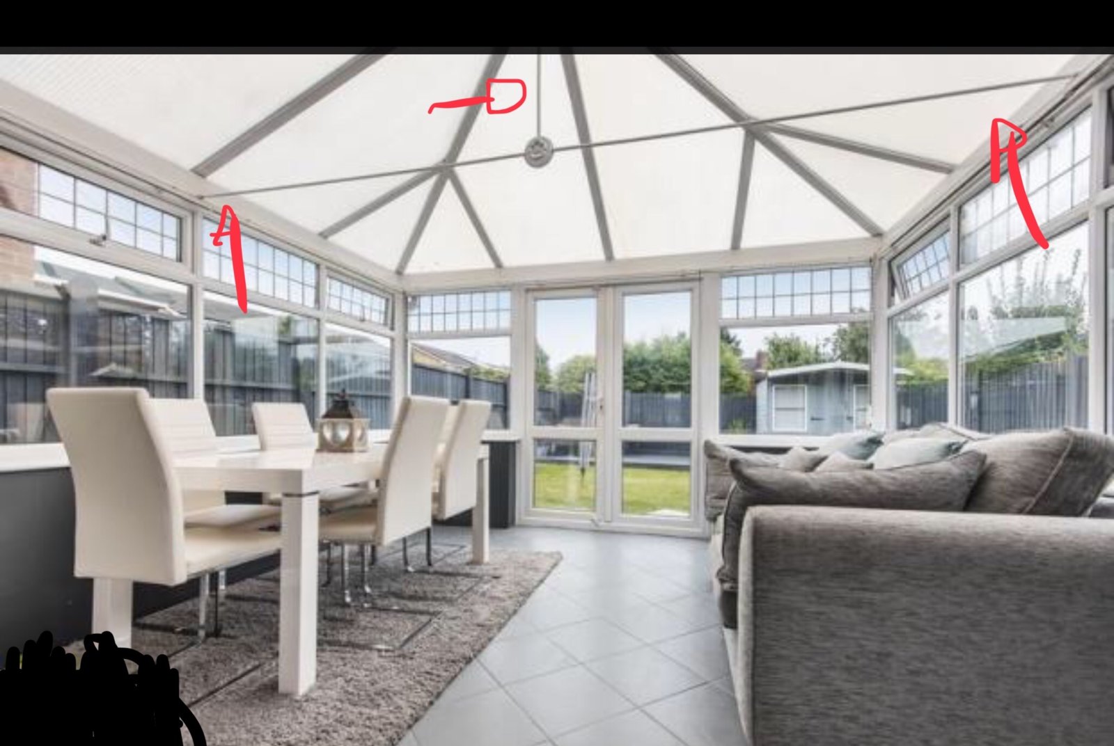

I would like to paint a conservatory tiled floor for a property just bought
It’s been painted by previous owners already but not keen on colour
Bluey grey is what she’s painted it and you can see original tile colour where it’s peeled
Please can somebody advise the best
1. Paint to buy
2. Method to paint (any primer sanding etc roller or brush etc)
As I’ve never done before
Full room pic attached

Scrape off all loose and flaky paint.
Sand all of the surface - boring, but will help to prevent the new paint peeling.
Some floor paints offer a non-slip finish, which is gritty - you may not want that, so be aware.
Oil-based is best for floors IMO.
