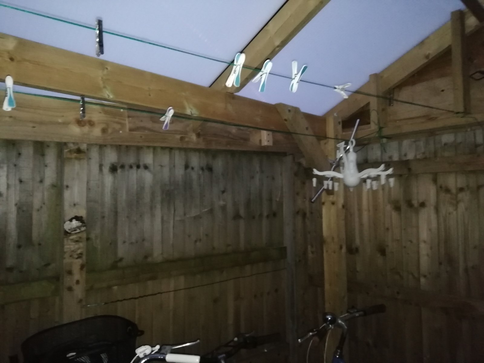

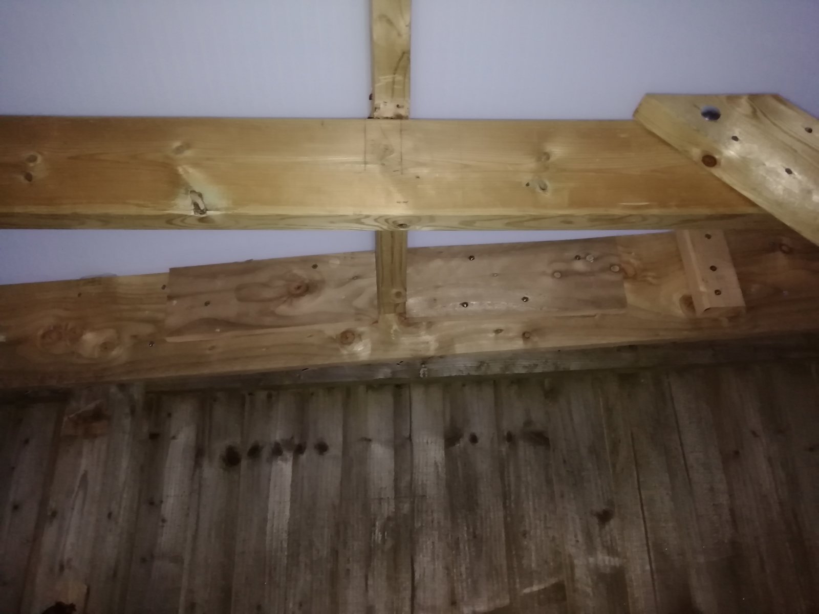

I have finished a basic lean to shelter. One of the rafters bent as it dried before putting polycarbonate sheets on so I had to remove the fixings and set it off it's original position. I tried to bend (fight) it before bracing it. But it still wants to be twisting.
The fascia is the only thing holding it.
Can anyone point me to some drawings or diagrams about tension in wood.
From an arborist perspective I get simple tension and compression, but this is beyond me. Also don't want to cut it in half!

TBH your best bet is probably to replace that piece. In general no amount of drilling and relieving will do much good and worse risks weakening the timber

Thanks for taking the time. Shame, but makes sense. I hope the panels have the margin to take whatever the joist end has done without bowing or pulling clear of a seal edge. Really don't want to remove it.... In a year's time, it should have gone through its cycle of humidity and movement? Would you say that long to see what it's potential is?
It matters little how long you wait. If it is warped now it probably won't ever straighten itself
Granted, yes not straight. But it will oscillate seasonally with highs and lows of ambient humidity? Worst next year not likely to be wildly different from 5 years time. I hope?

It's weird..... looking at it, I can help feeling that with, say, a spade bit, I could drill out a couple of holes somewhere, and it would relax.....or get worse.

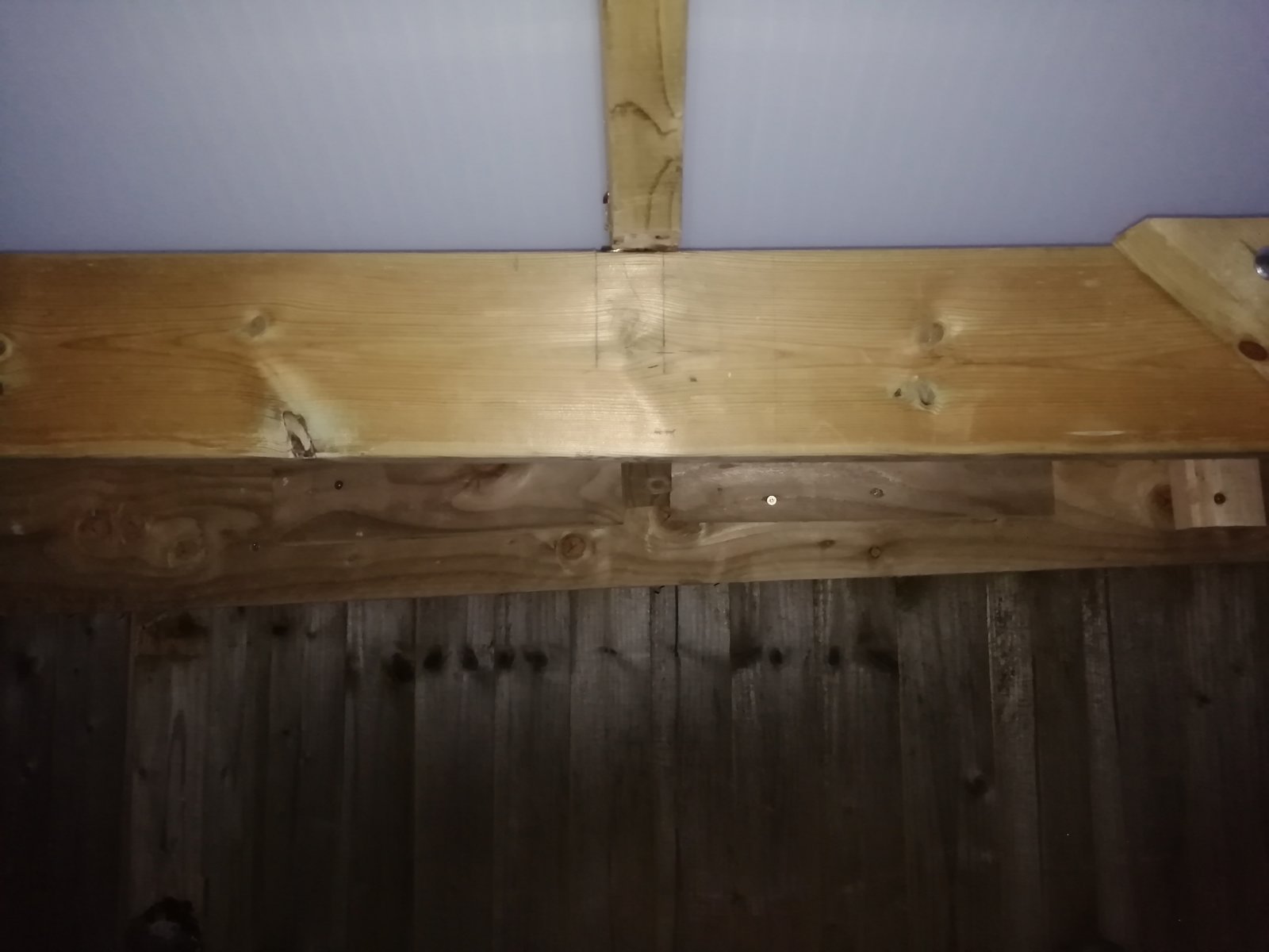

Think I'll mark it and measure it all up with tell marks.. for now.

The only aspect of 'display' I am concerned with is the outside view. I.e. panels buckling or pulled off their seals.
'Desperate not to' is a dramatisation of 'do you think I'll have to?'
I'm sure there are worse timbers sitting in hundreds of home around the country without any ill effect.
