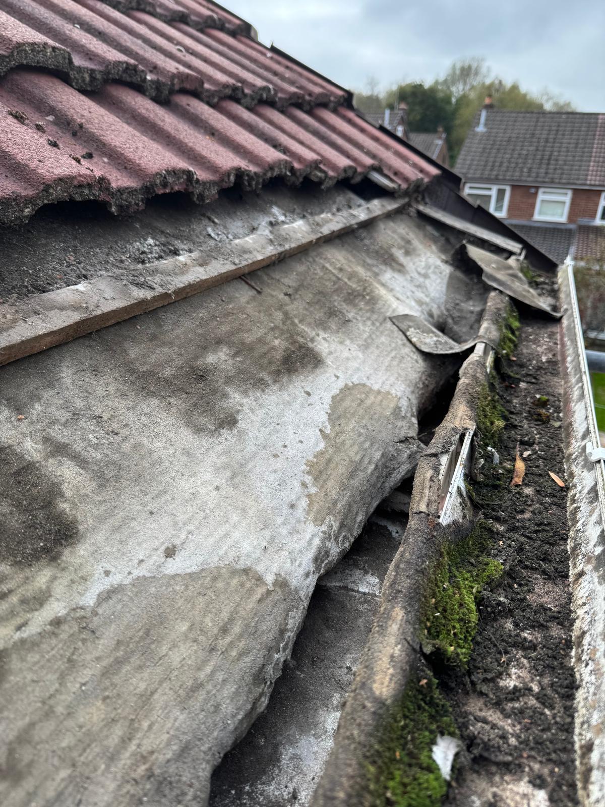

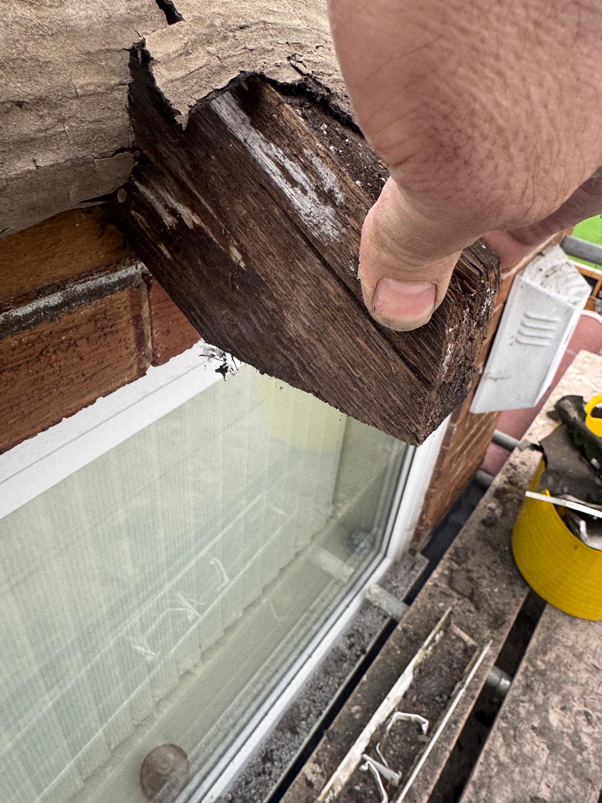

After being let down by the previous Scaffolder, I finally got some installed last night and had a first look at the job today - it's pretty bad....

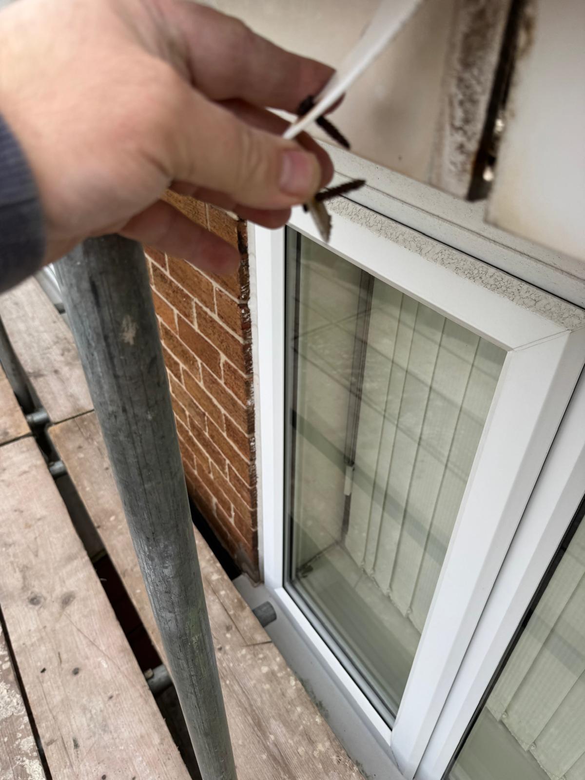

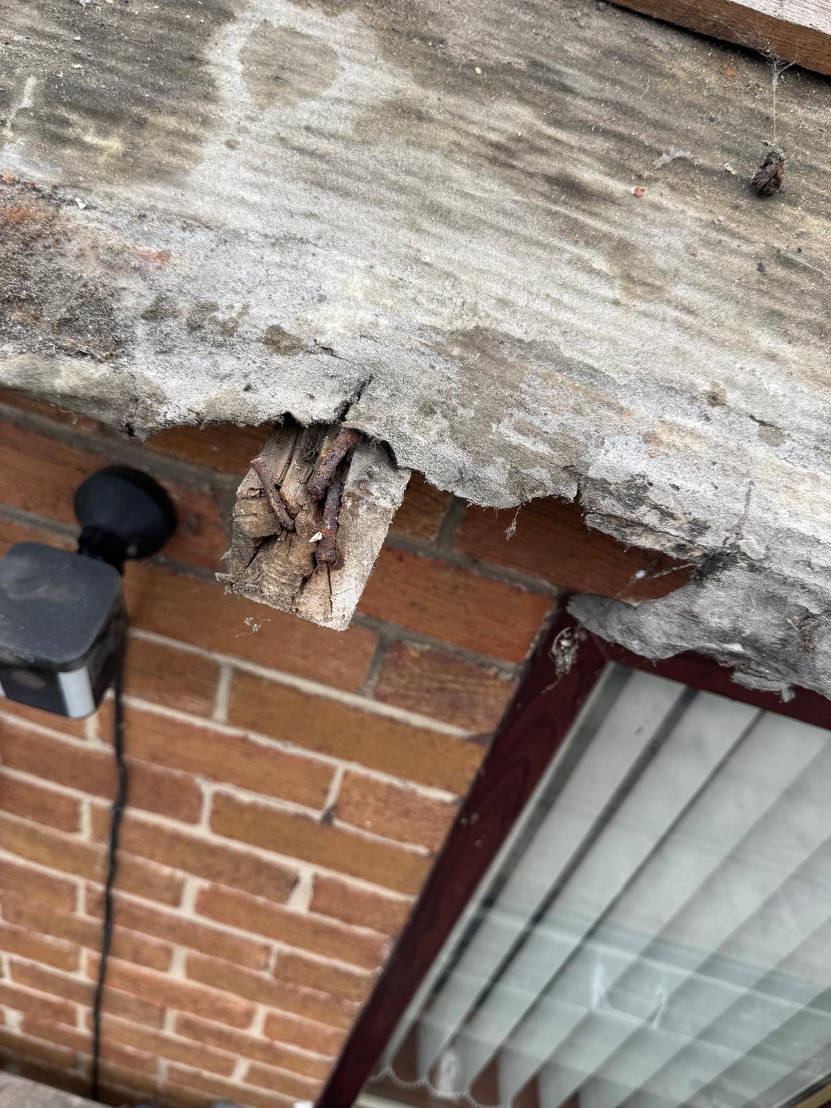

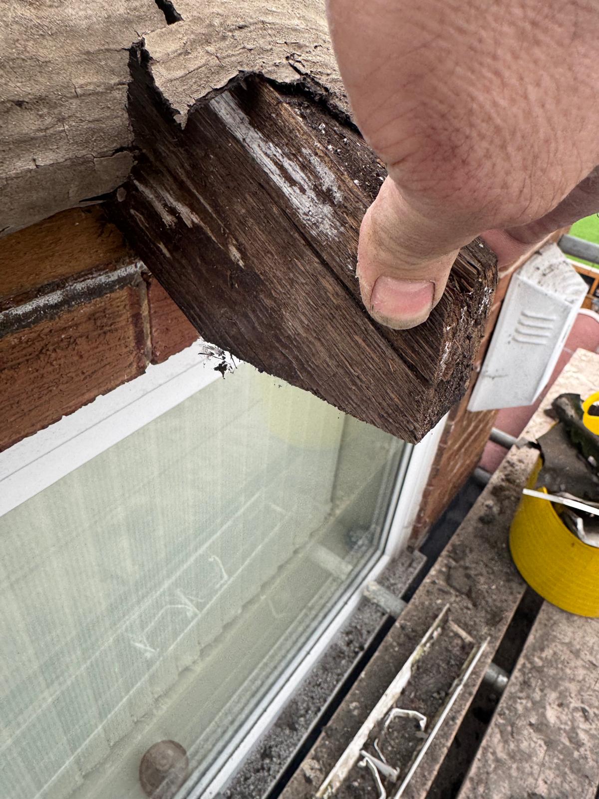

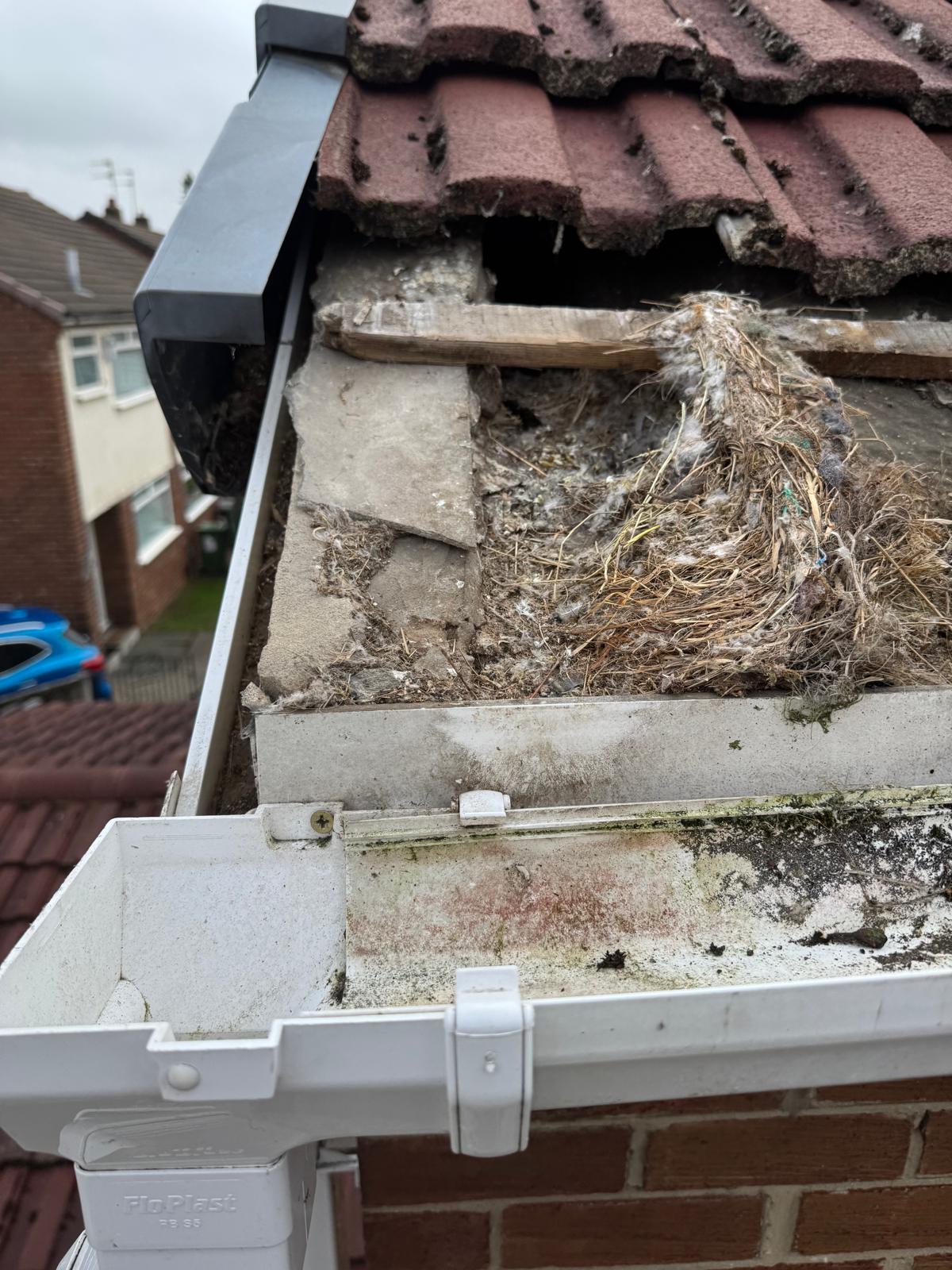

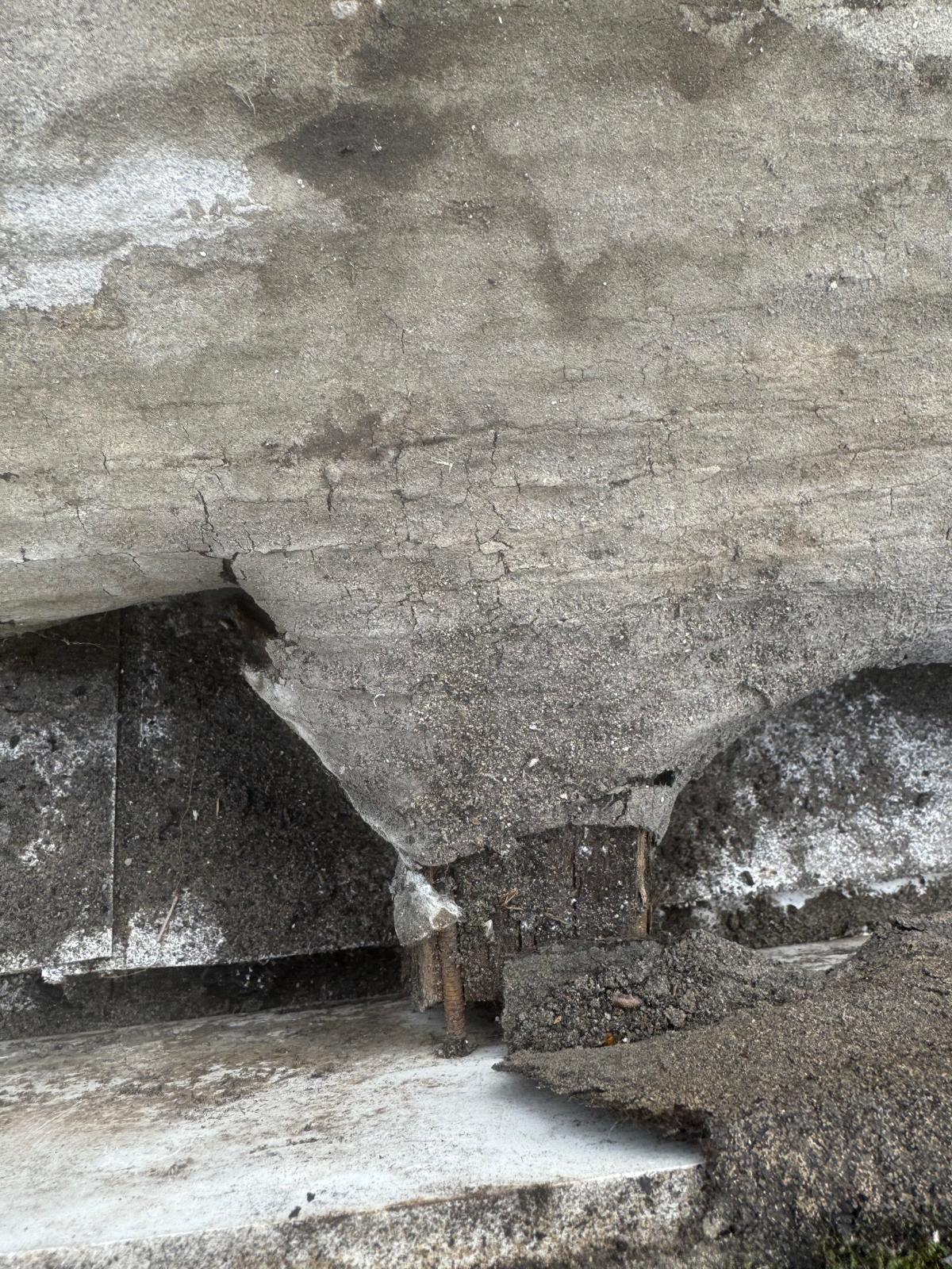

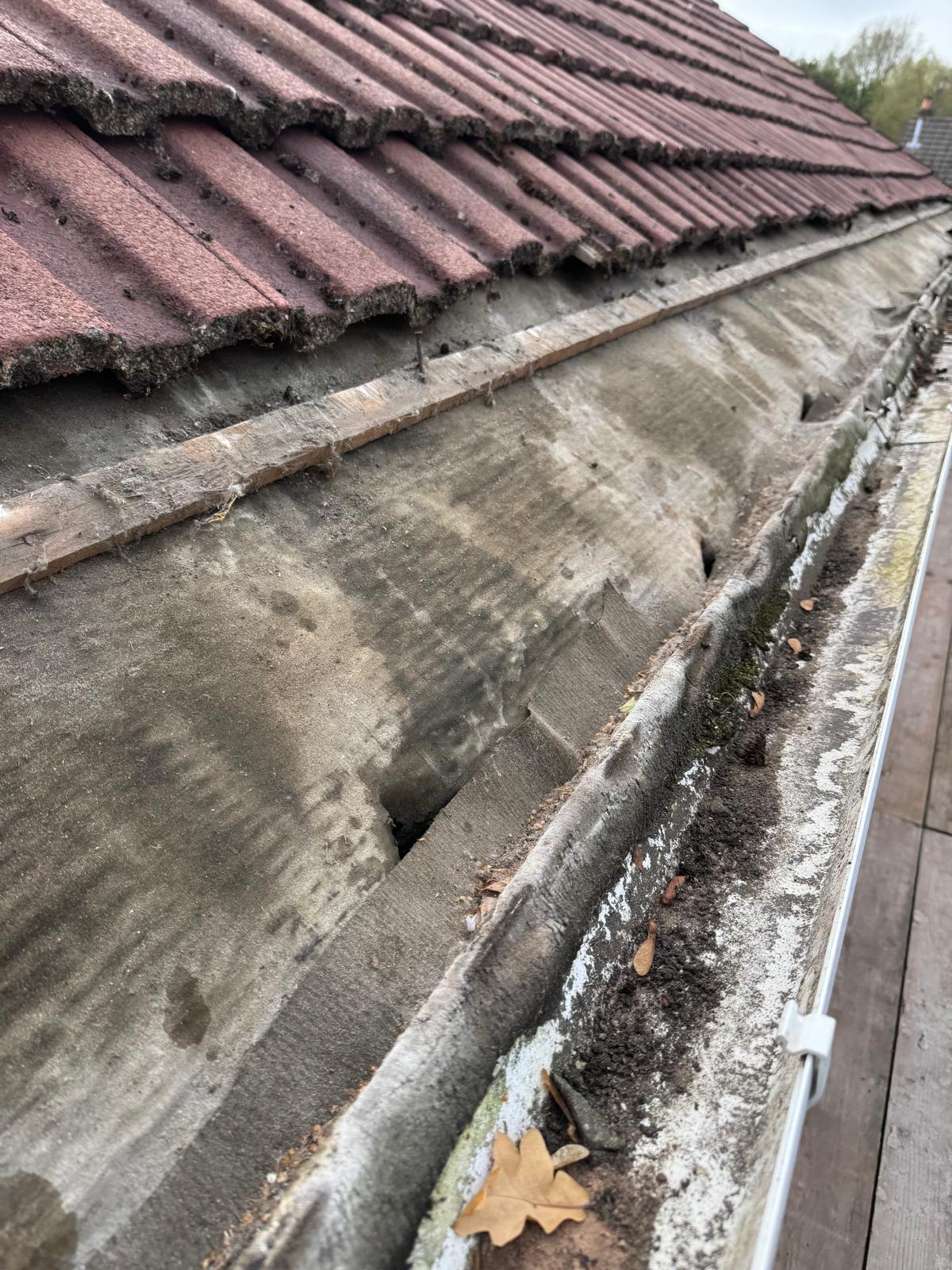

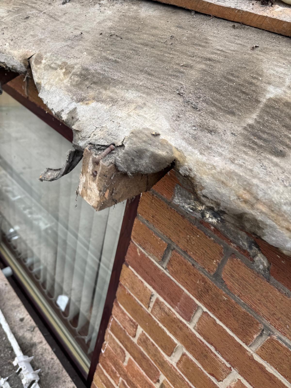

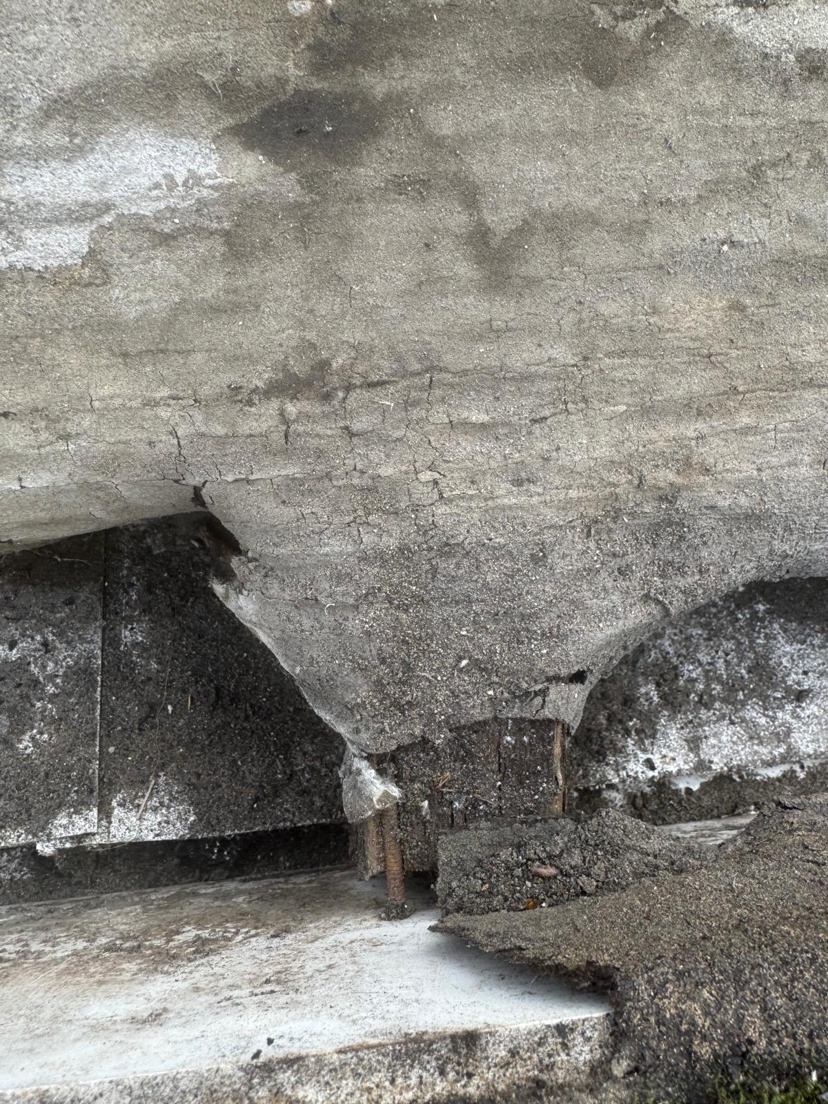

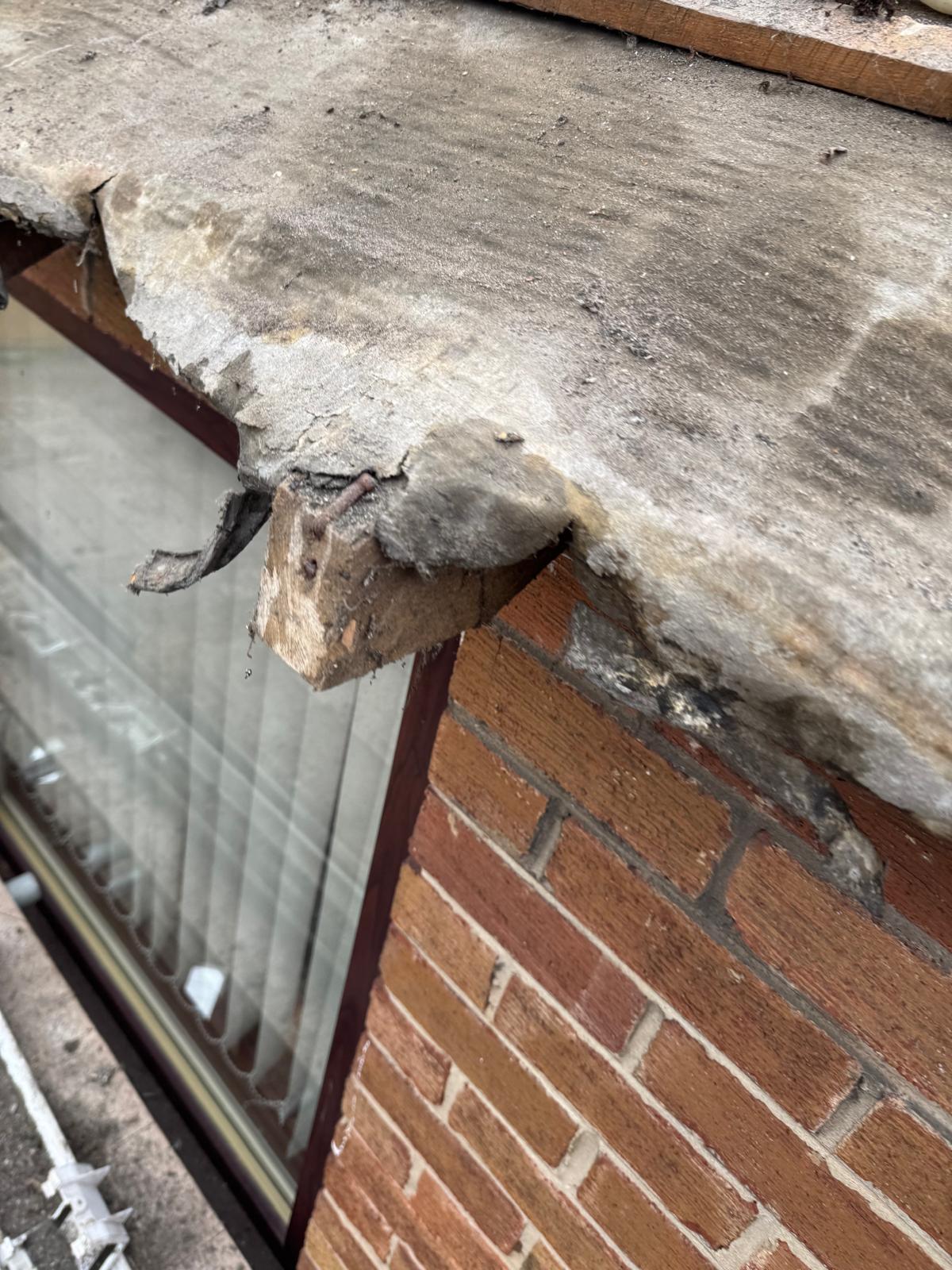

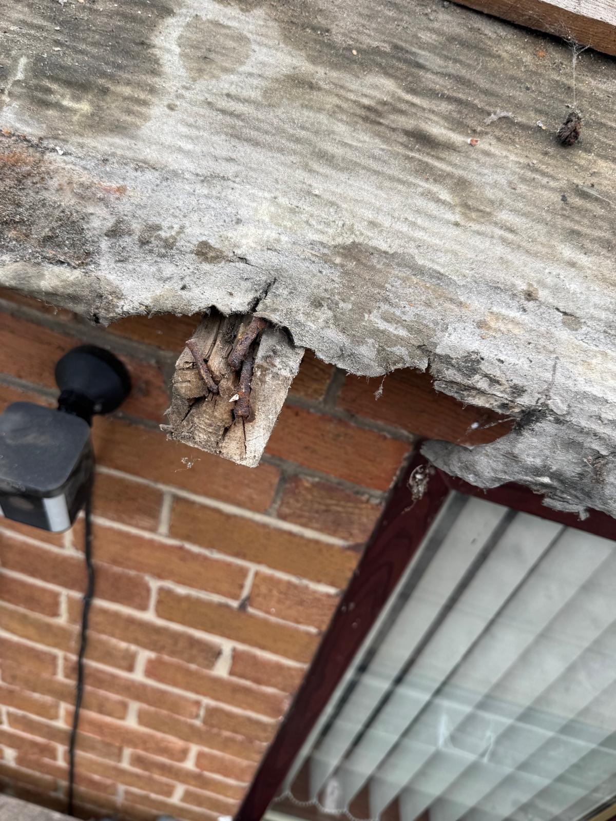

it seems the last company to do it decided to patch the rotted felt end by fitting a short run ON TOP of the felt instead of under, helping to cause more damage on the way. the cause of the warped guttering/fascia is as i thought - the capping board has twisted under the weight of the concrete tiles and twisted out - not helped by the fact the rafter ends are about 50mm and most of the nails they put in are not even in the rafters but over the top!
I'm fitting manthorpe 3 in 1 vents/bird block/felt support trays all along, so i know i need to drop the fascia height by 20mm to accomodate it, but i noticed about half a dozen of the last row of tiles had nails in them, i was wondering if i would be better fitting an extra batten right behind the new fascia board to hold the felt down, increase the support for the fascia and reduce the runoff on the last row of tiles? if so, should i resort back to nails in the last row of tiles or get clips to hold them down onto the new batten?

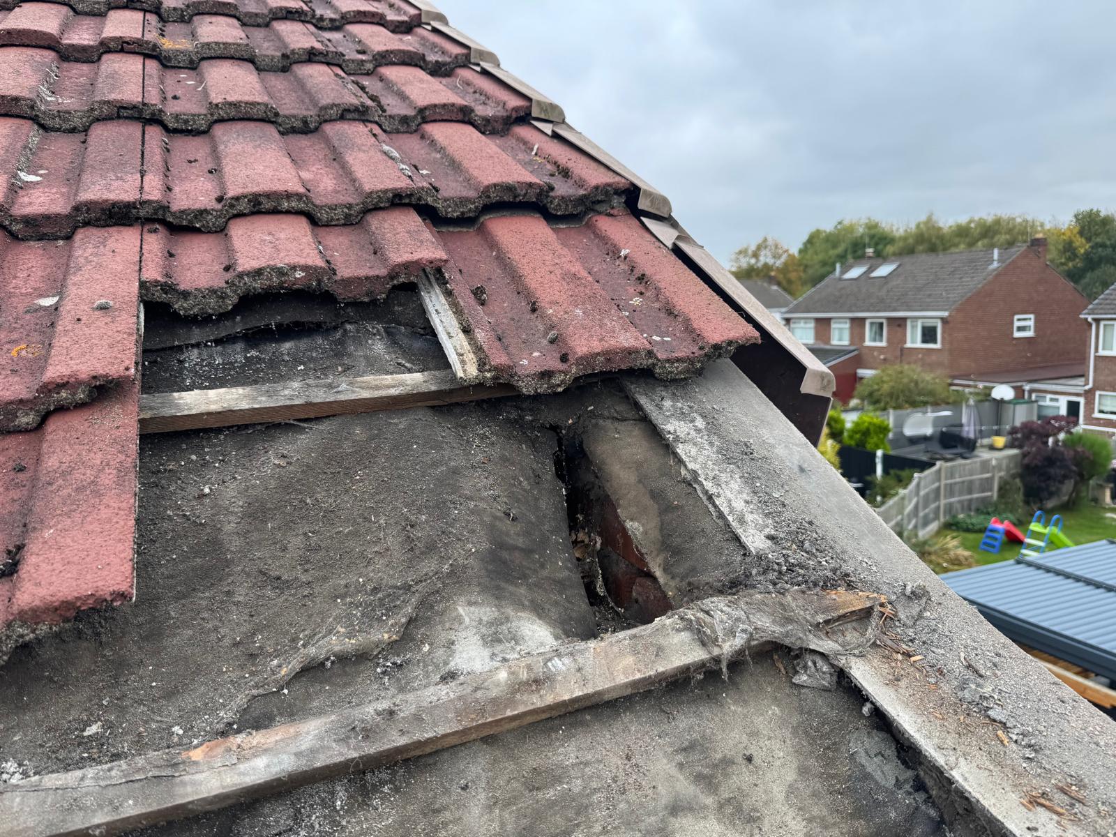

My second question is about the felt that has fallen completely away between the gable end and the last rafter - what is the best way to resecure this, baring in mind the dry verg has been installed by cowboys who just used the original battens and installed 100mm screws to hold the dry verge sections in place (now rotted)

Given the delapidated state of things you would do best to surround the semi's with scaffolding, and then work around the roof - not just the rear elevation?
Whatever, dont attempt to work on the verges without scaff. And always work with another adult present.
I wouldn't go buying materials until you have a much clearer idea of what you need.

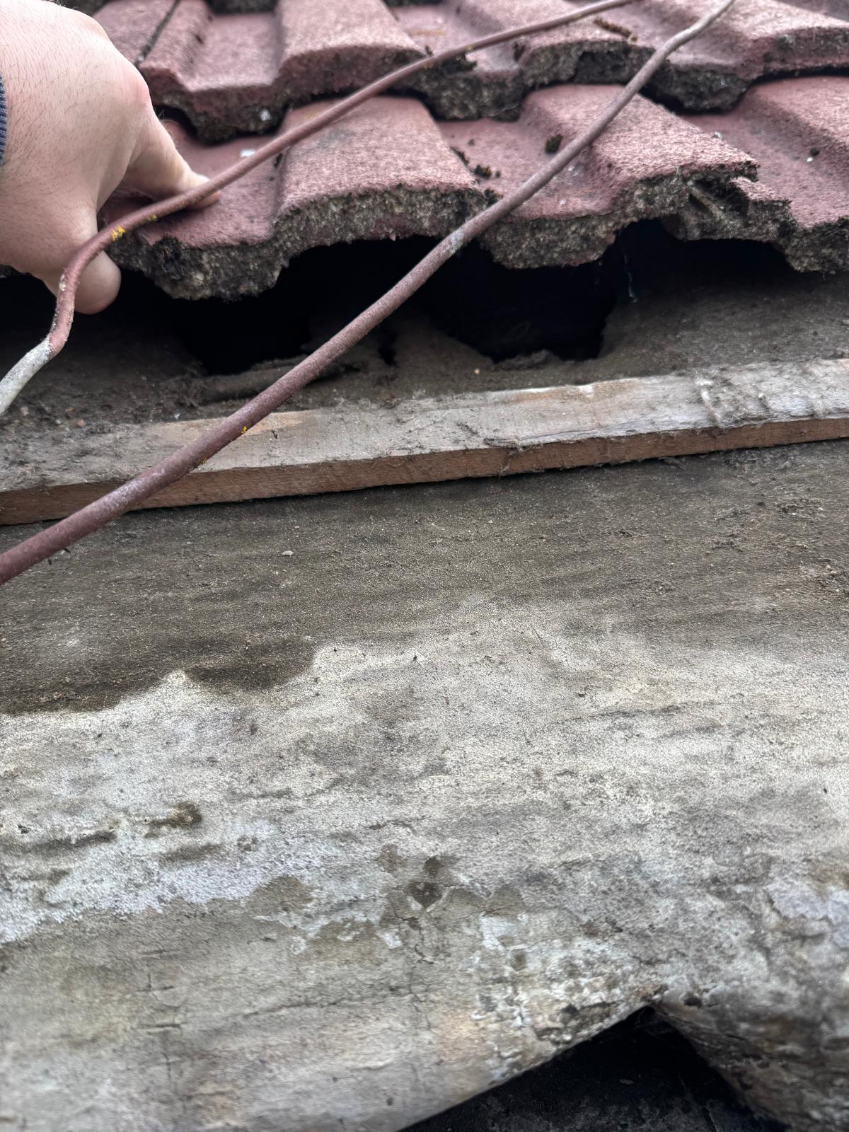

The eaves tile course shown will have to be pushed higher before sliding in a fresh roll of felt.
The last batten shown will have to be lifted.
Two vertical (maybe even three) lines of verge tiles will have to be stripped back from eaves to ridge.
You need to remove as much defective & incorrectly installed work as possible - & then post pics of what you've exposed.

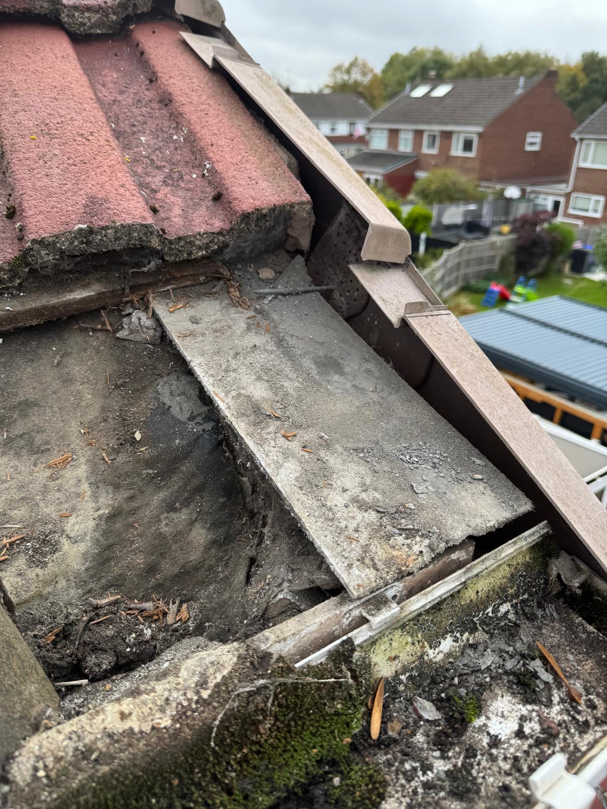

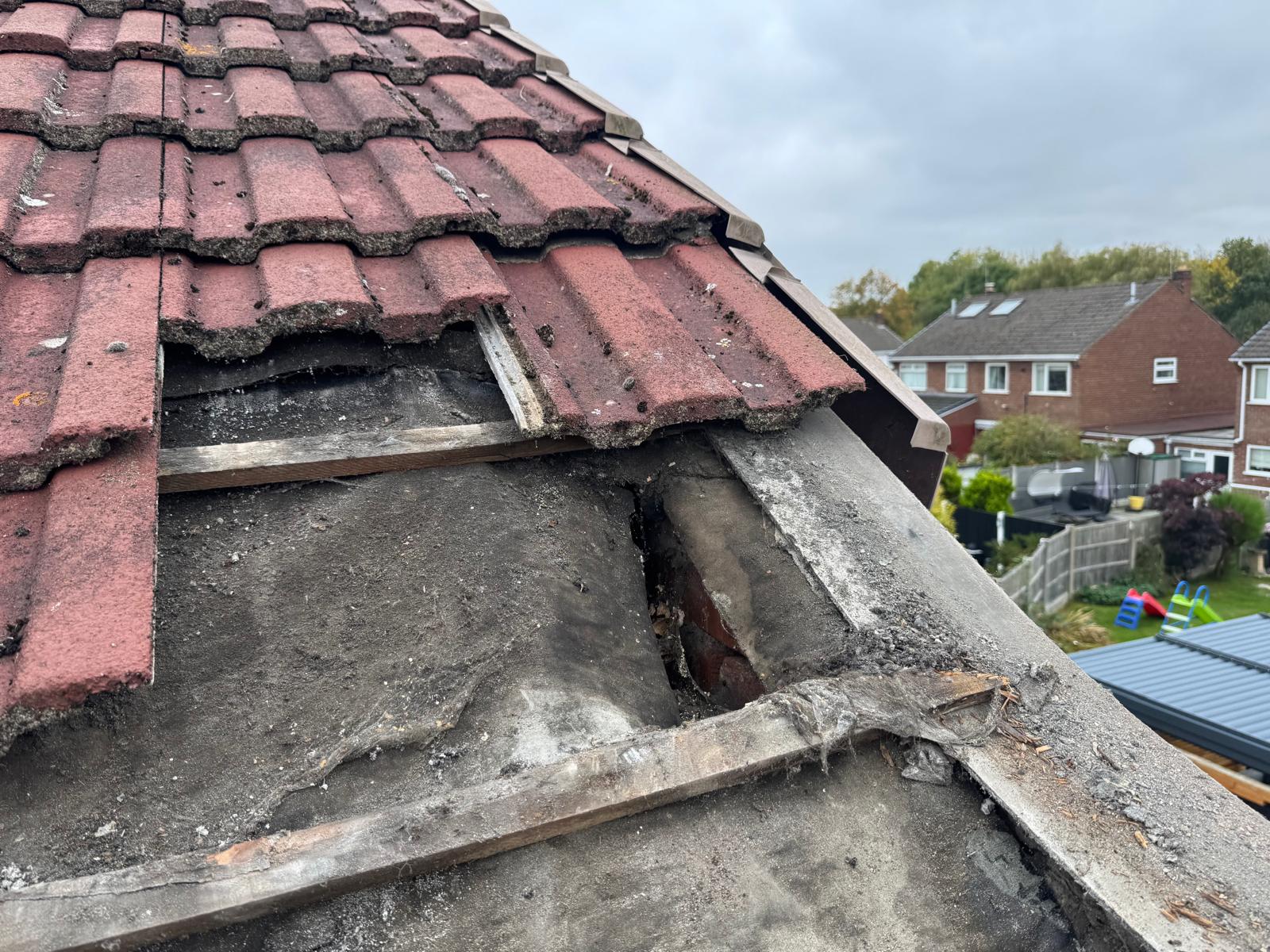

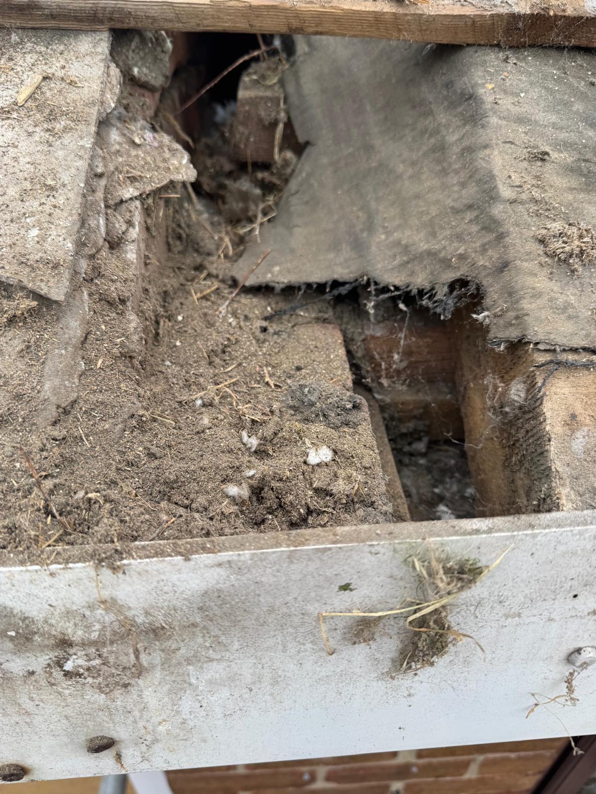

Thanks for the reply. I have taken the second course of tiles out and exposed the felt overlap. Its not the best job… not helped by the joists for the ceiling of the attic conversions in both houses protruding through through the felt having been pushed out too far.
The immediate concerns are the ends of the battens have rotted through, instead of extending the battens when installing the dry verge they just used 150mm screws which probably split the wood. On the other end, they just stuck screws into the old mortar so the dry verge was not even held!
The other concern is the felt has dropped off the gable end leaving a gap a fair way up which birds have made worse as the dry verge wasn’t capped off properly - not helped by no fixings in the last section.

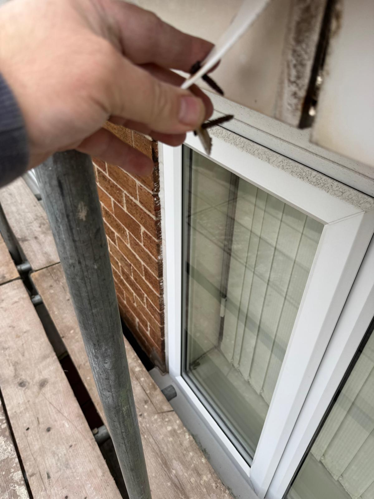

It appears they didn’t feel it necessary to remove the old fascia nails and just hammered them flat into the rafter ends, a few of which are now rotting.

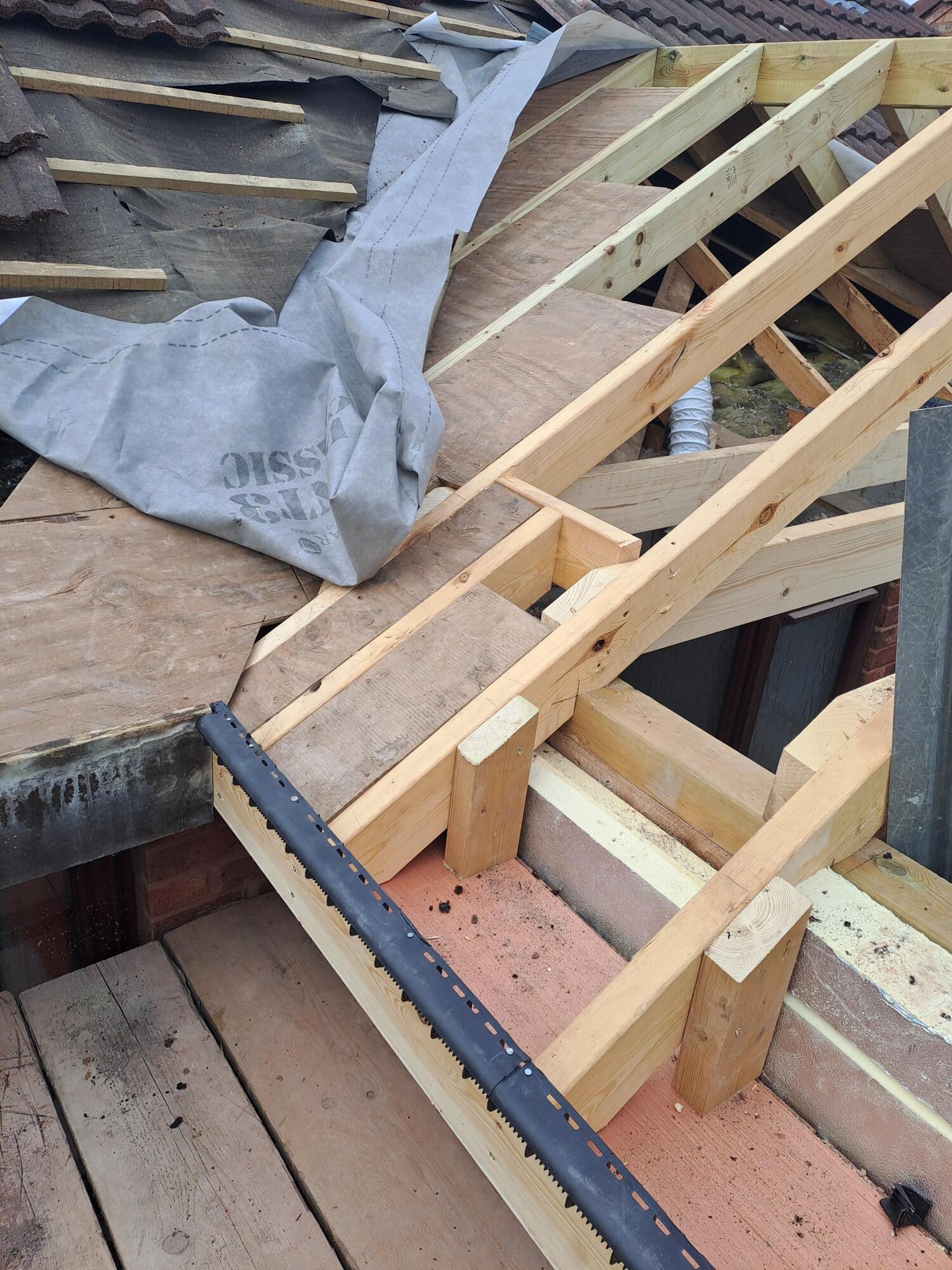

The plan now is replace the first run of felt with membrane, and replace the battens so they correctly overhang for the dry verge to be fixed. I’m not sure whether to fix a vertical batten on the gable end to secure the new membrane or just rely on the horizontal battens instead. I’ve also got some c16 2x4 treated timber to sister some new rafter tails on the worst ones, then screw some full fascia offcuts on the tails where needed to even up the fascia run and provide some more support for pins to secure it (only 1 nail had been used in the 75mm rafter ends before - half of which where not even in the rafters as they were too high)

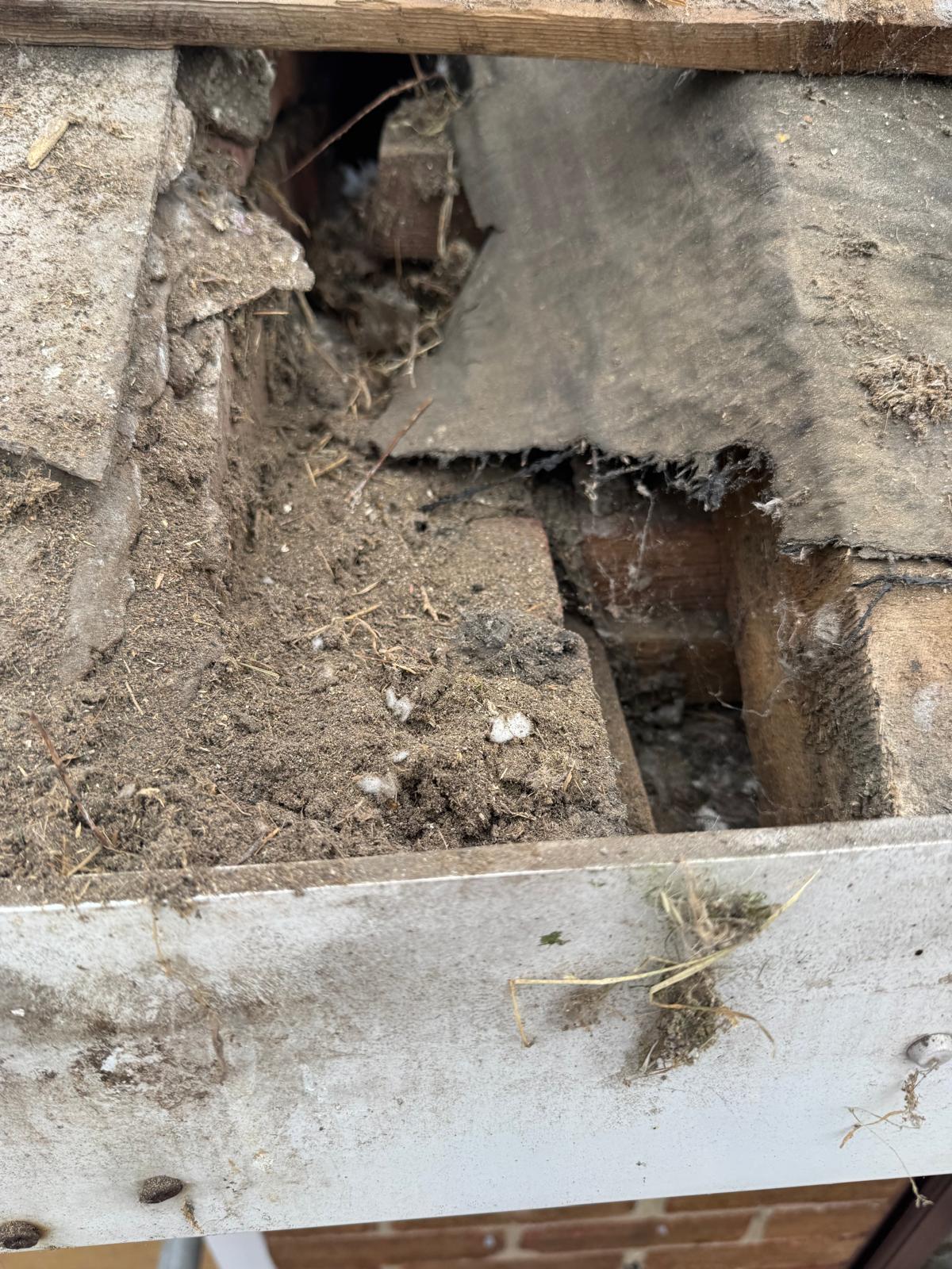

Thanks - i expected it to be as bit rough, but this is next level. the hollow soffit was only held in place with silicons sealant at the wall side ; it just fella away with very little effort, just a proper mess! I don't like doing half a job, so was always planning to fit support trays with integrated vents etc, and guessed a run of felt would need doing - just the securing of the felt to the gable ends is concerning me now tbh! I'm just glad there are no nesting birds in there now - think there's half a bucket of old nests pulled out so far - and i was wrong about wasps being in there!

All is fixable once you have removed about four courses of tiles and the rotten felt. You can sister the lower part of the rafter ends with healthy timber as well as rebuild the soffit and cradling. The verge caps would need a fair bit of graft and tile removal too.
