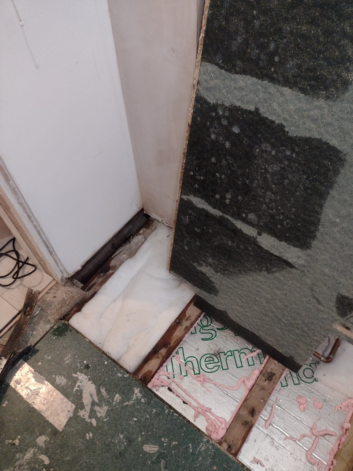

Currently, the room does not have skirting board along one wall.

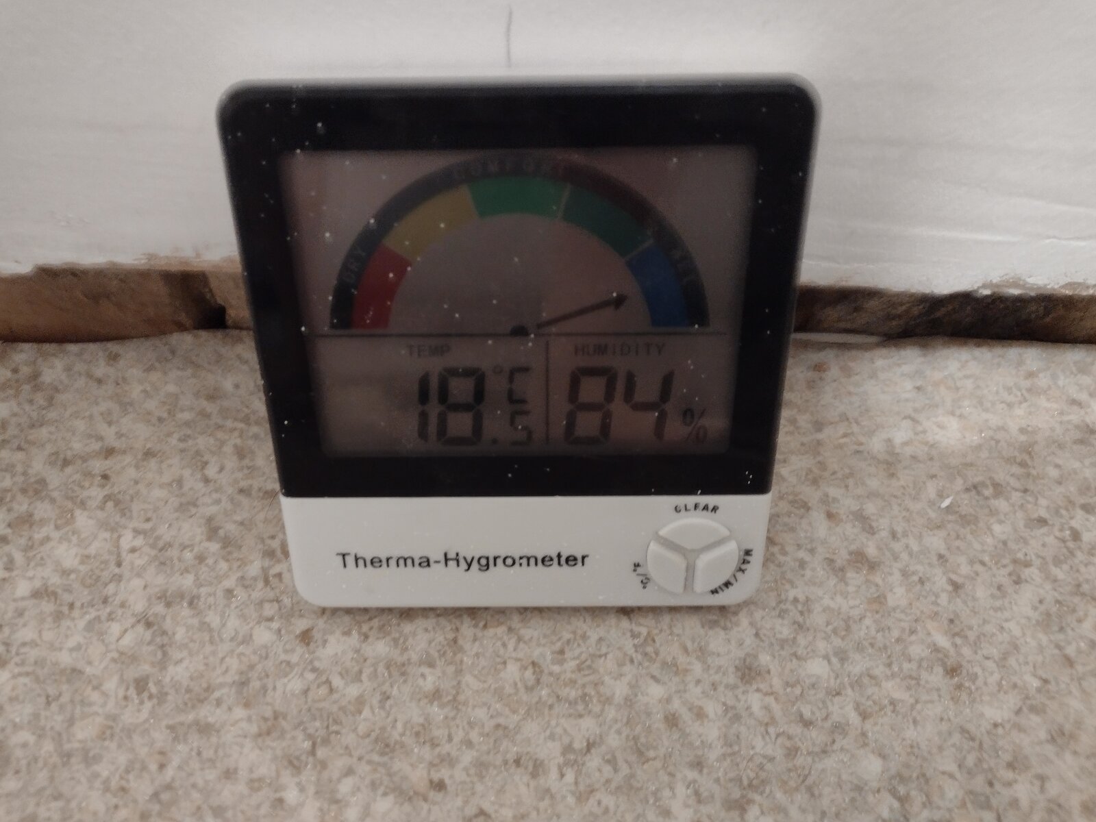

Humidity reading was 84% the other day. I reduced it with dehumidifier to about 50, but it has risen again. Window vents open.

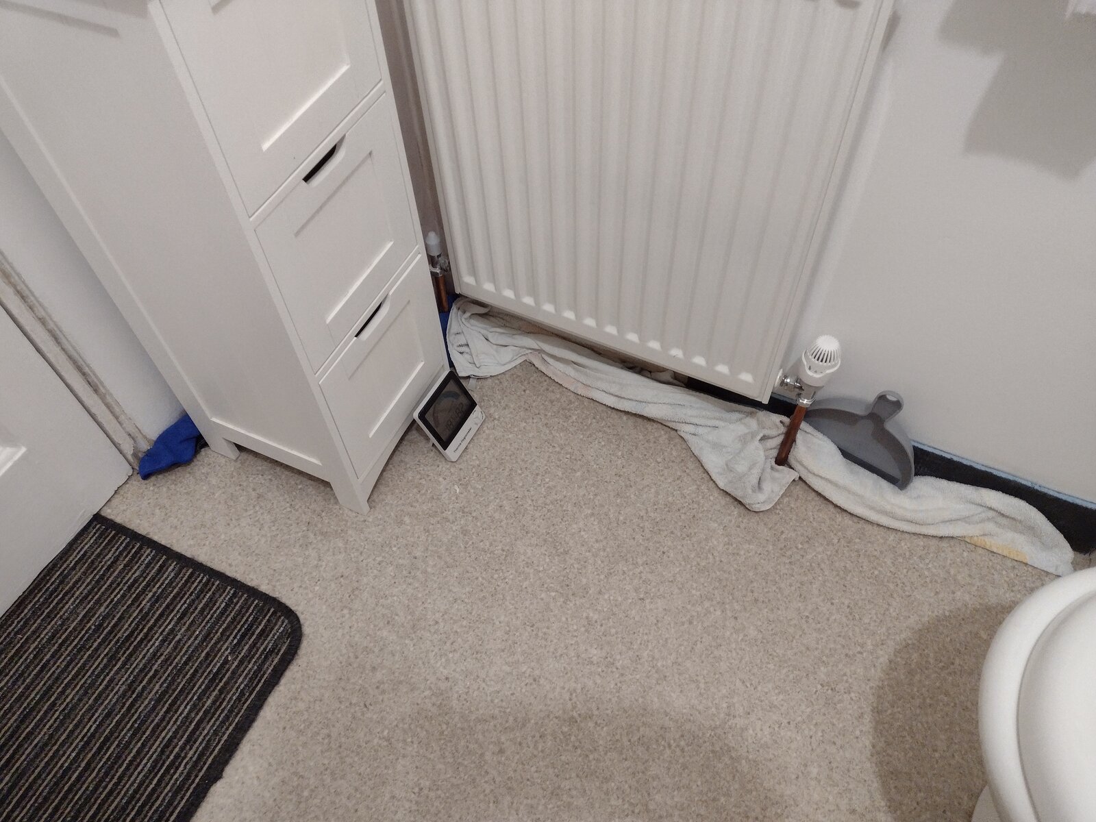

Could the issue be because there is no skirting board? Maybe water vapour just condensing because it's the last cold spot?
I shoved some towels and bits of insulation where the skirting should be, and that seemed to help a bit but humidity has risen to 77 again today. Nobody home, no showers, cooking etc. Just one small dog breathing.

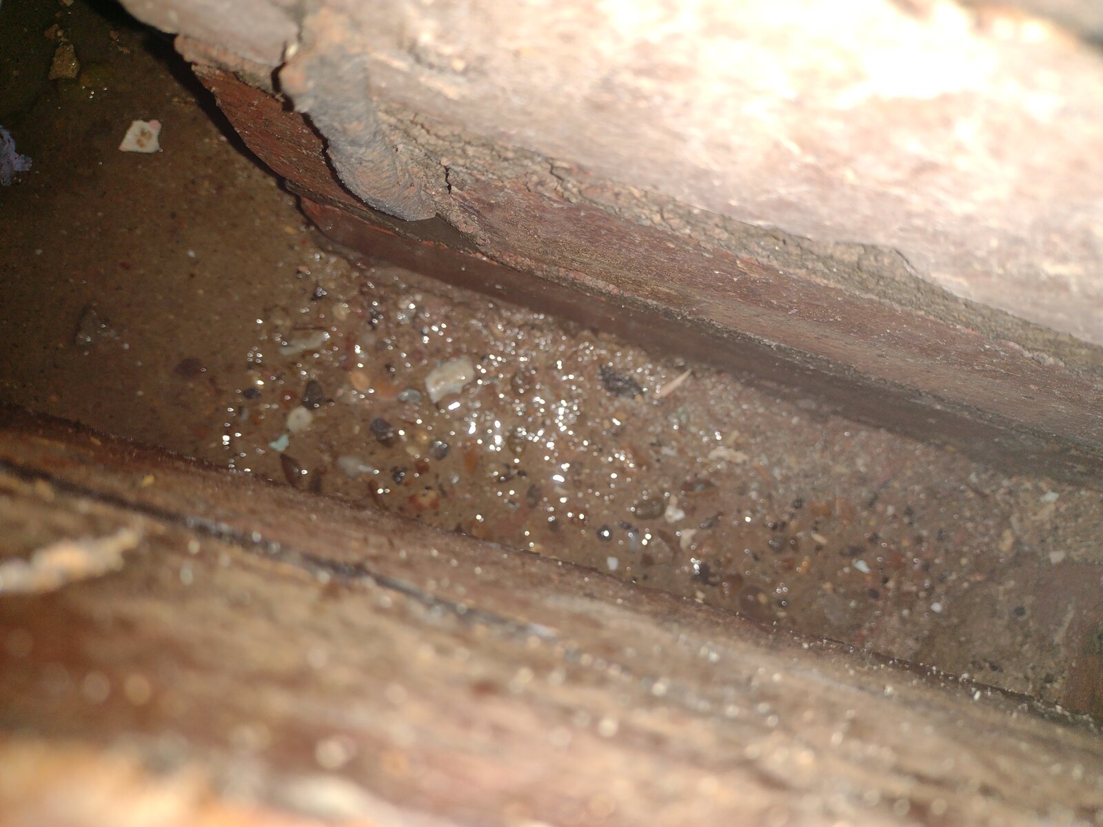

There was a little sign of damp on the concrete sub floor along the outside wall - could this be a cause? Odd, as it has been so dry recently. I did dig a French style drainage channel down the side of the house a few years ago, but did not get to this part of the house as there is a gate and manhole, so left it. But might have to dig more.

Probably the lack of skirting boards then, the window is well fitted, no gaps. Also no bath panel on at the moment, and some gaps under there to the sub floor. Will shove in more insulation.
Leaving the door open lowers humidity pretty well. This morning it was 16C / 81% on the window sill.
Have you placed you humidity “gauge” next to each other to confirm their accuracy .?
Yeah, they are pretty consistent. And the dehumidifier's gauge matched too.

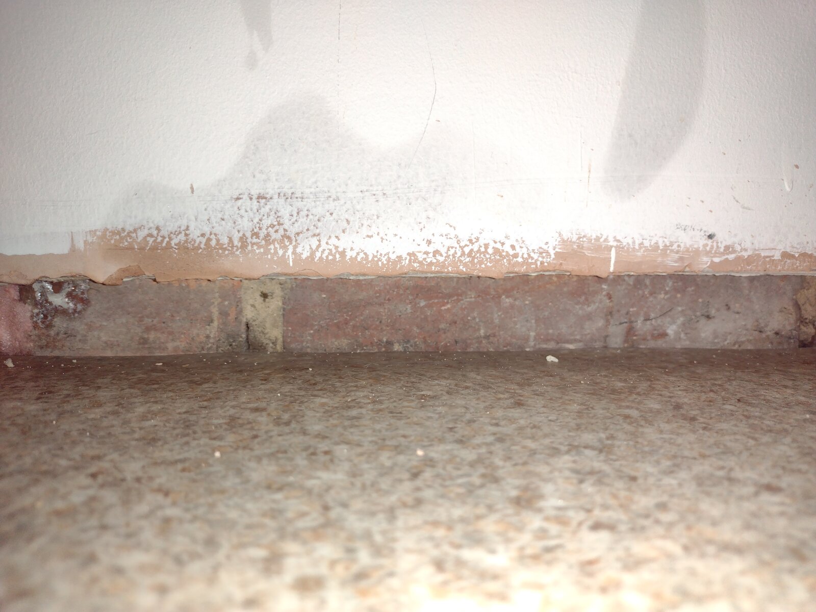

Wall looked at today, and plasterboard feels wet, not just surface condensation. And, both sides of the wall (brick) feel wet, and feels warmer than it should...
And, recently the hot water taps started acting like they're was an air lock, spluttering.
And humidity higher here than in window sill.
Is there a way to know for sure without ripping up my new floor? Maybe call home insurance?

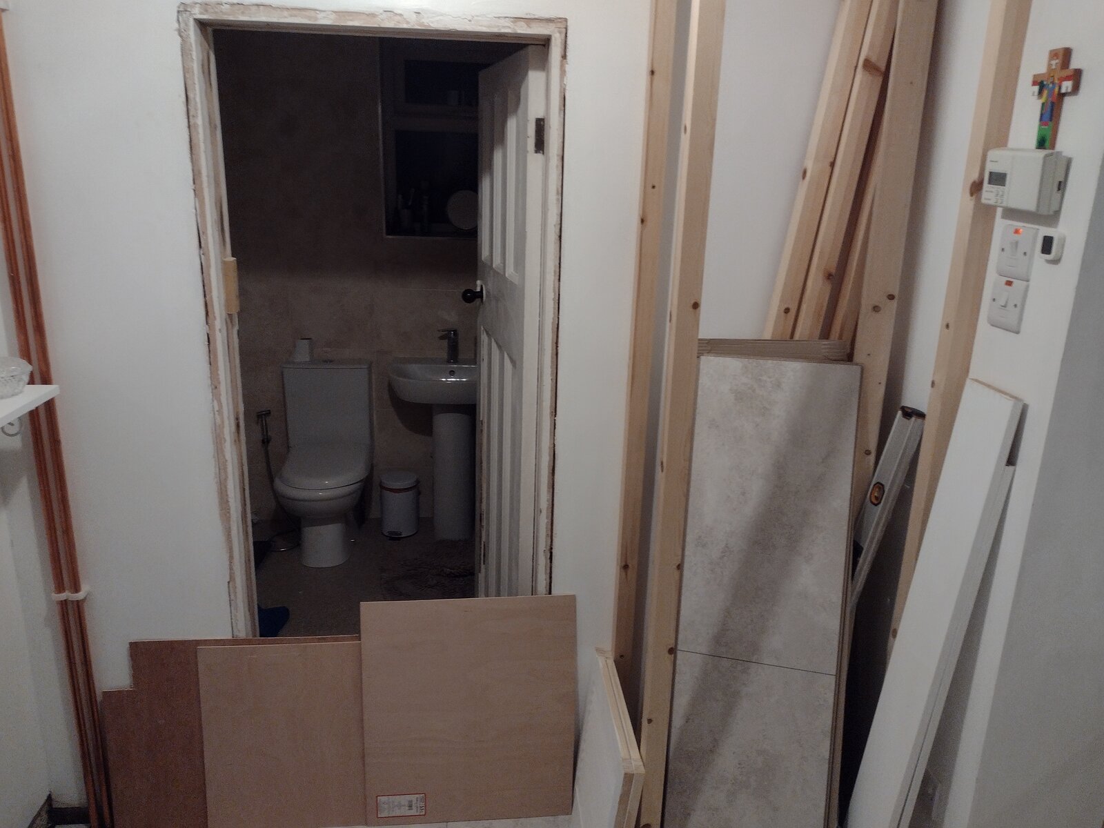

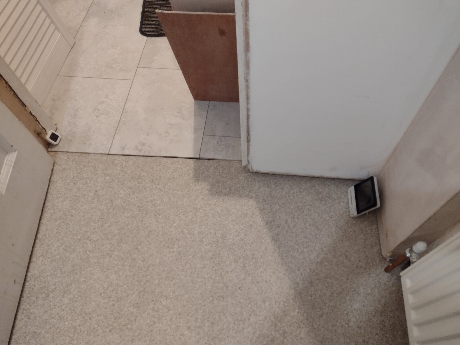

Here there are each side of the open door. Left is 64, right is 81. Hall is 50 on the wall.
This morning the humidity sensor died, it was full of water. I think we can rule out condensation now.
