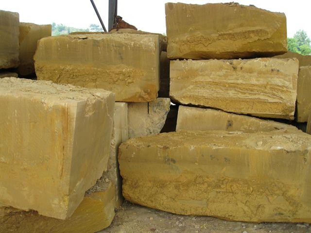

im not sure what you mean by sandstone blocks a pic would help , but i woould of thought you should be able to cousre it with the blockwork behind , failing that you could cut strips of expanding metal and use that , i would also fill the cavity with dryish concrete :D
these are the sandstone blocks I'm on about.

wow those blocks are huge they look man enough on there own !!
having said that putting 9 m2 of concrete behind it is a no no it will simply push the wall over and is not needed any way , your plan of 100 mm is better ,
