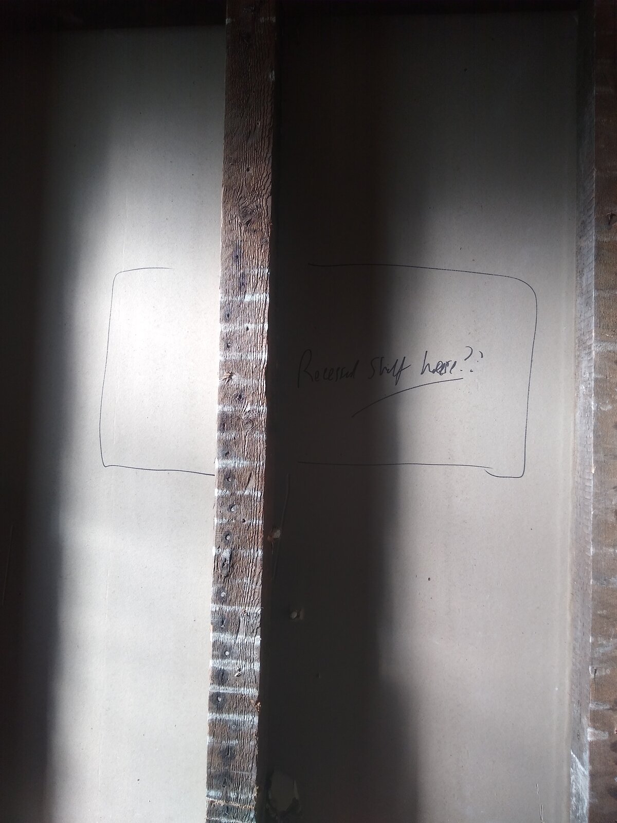

I am putting a recessed shelf in my bathroom andiand where I want it happens to be in the middle of three vertical stuff as per picture below
Does this make it complicated?
Would it be much easier installing between the studs and making shelf smaller width wise?
If so, to keep the depth what can I seal the back of the plasterboard with that's on the other side of stud walll?
The stud depth is only 7.5cm so I don't want to lose any space
Cheers
I would chop out the timber in the middle, to the height of your recess and put in two vertical pieces of timber attached to the studs to the left and right , which you can use for the top and bottom of your recess
As for back? I would use a thin sheet of ply attached to the back of your new timbers , then either paint or tile it

so once the vertical battens have been installed on the left and right vertical stud, i would also need to put timber horizontal across top and bottom also?
not going to be left with much room taking into account tiles and plasterboard also!

Chop middle vertical stud , install horizontal battens to the height you want attached to the left and right vertical studs, then attach vertical studs to give you the width you want the recess to be.
Use ply as the backer against the plasterboard , then either tile or paint

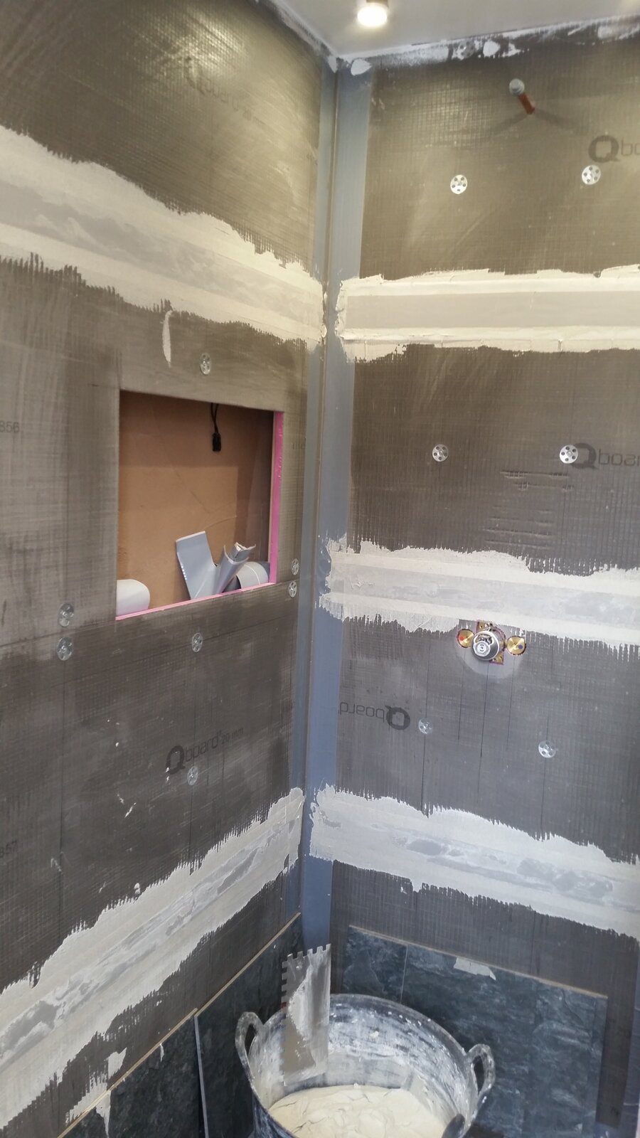

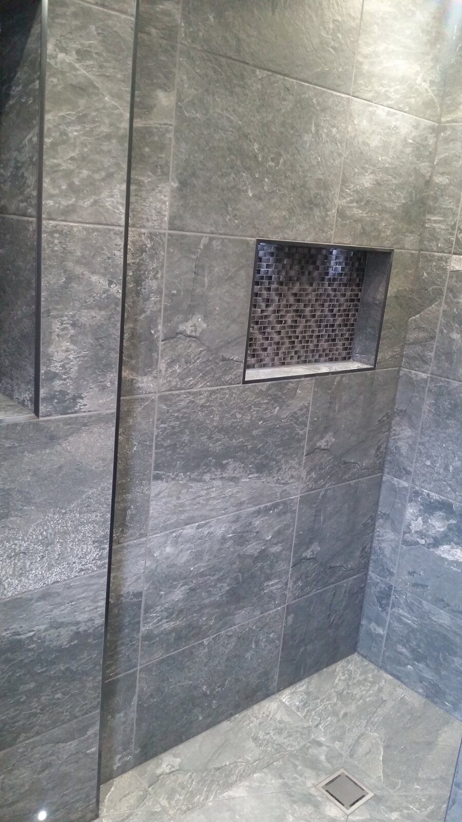

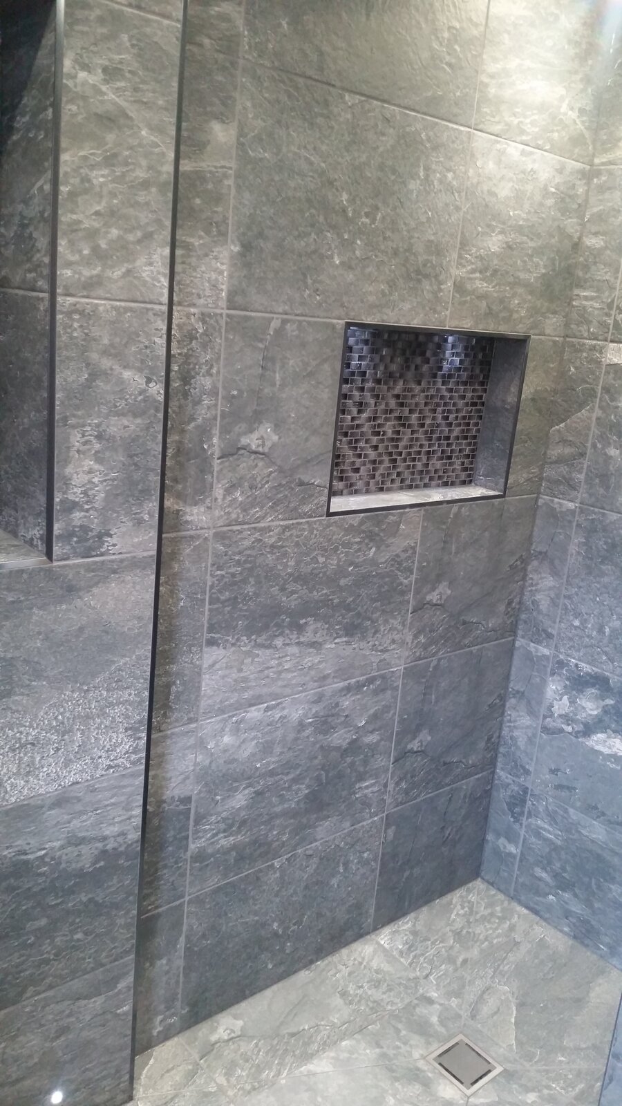

Begin by adding horizontal noggings top and bottom, either side of the middle stud which will form the top and bottom of your alcove shelf (remember to allow for depth of whatever you are overboarding with as well as the depth of your final covering matetial). Next add vertical studwork if required to form the left and right side of your alcove, again remembering to allow for the extra depth like before. Once these are fixed solid cut the middle stud top and bottom to line up with your new top and bottom noggings. You will probably find the plasterboard on the other side of the studwork will be nailed to this piece of studwork. Gently remove this stud and you might get away without causing any damage to the other side, the nails will pull through the board but the skim on the other side may remain intact. Your alcove is now formed. If it's inside the shower or bath area then I'd overboard with a construction board such as Marmox, STS, Q-board etc as these are waterproof. If the alcove is in a non wet area then plasterboard will be fine. Here's a couple of recent pictures of something like this during and after to give you a bit of idea.
