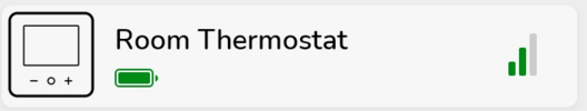

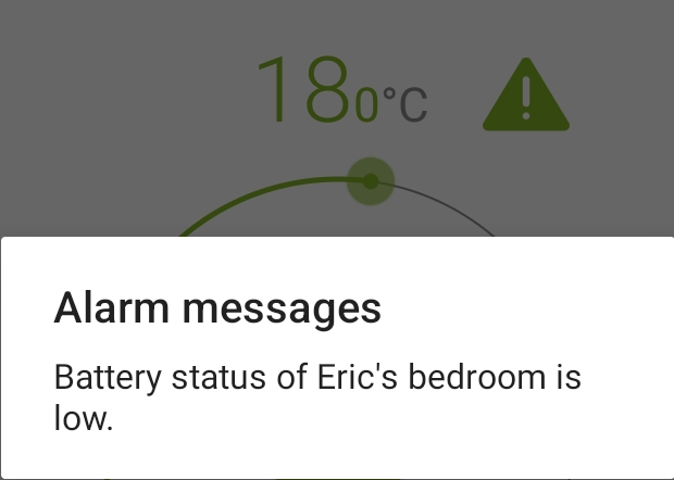

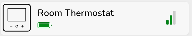

I am sure the units would work without a problem with Ni-Mh, and that the 2.4 or 4.8 volt is ample, but the report on some
actually shows voltage, so I have a good idea, but others
one is left wondering if OK or not, 1728488019938.png 1728488192929.png so I have to use non rechargeable to be sure the battery warning light is actually giving a true report, cat flap is worse, I am sure I am changing the batteries when not really required, but don't want the cats locked out. So 9 x electronic TRV heads, and a wireless room thermostat, although since there is a second one, heating will still work if battery flat, and the cat flap means 24 AA batteries.
I use the rechargeable in Christmas lights etc, and my computer mouse, even the weather station, but for the central heating each year end up changing 20 x AA cells, likely they will last 2 years, but never take the chance.

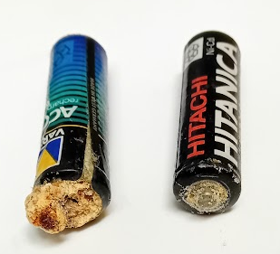

The set of 4 Vartas on the left were in our doorbell until a few days ago when it started making horrible struggling sounds. While looking for replacements I had 2 Hitachis in the box and wondered where the other 6 were, found them lurking in a pair cheap 446 radios which have probably not been used for 10+ years and now rotted/festering in the bin.
