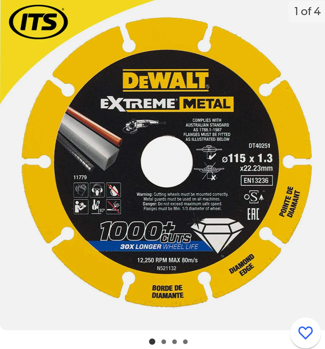

I had a segmented diamond metal cutting blade bend one of the segments to about 60 degrees, not sure how but I was cutting a large RSJ and presumably the grinder had a little twist (obviously caused by the operator), I think it just pushed the blade out of the cut, certainly when I tried to restart cutting (before I examined the blade and saw what had happened) it just kept coming out of the cut so no real drama. Straightened the segment in the vice and it was as good as new.
