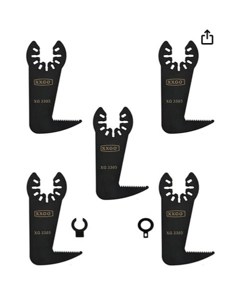

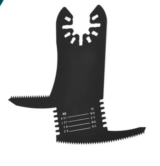

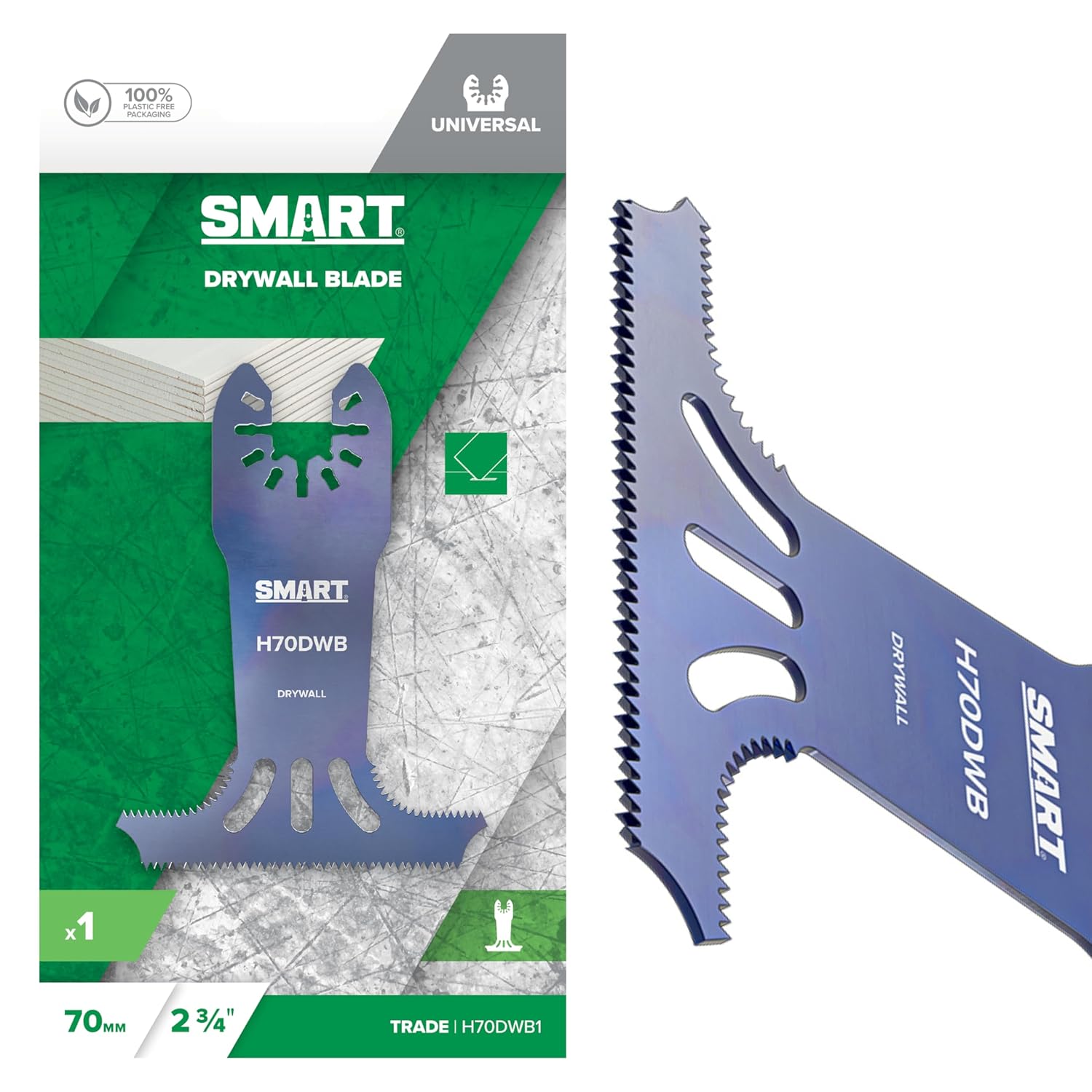

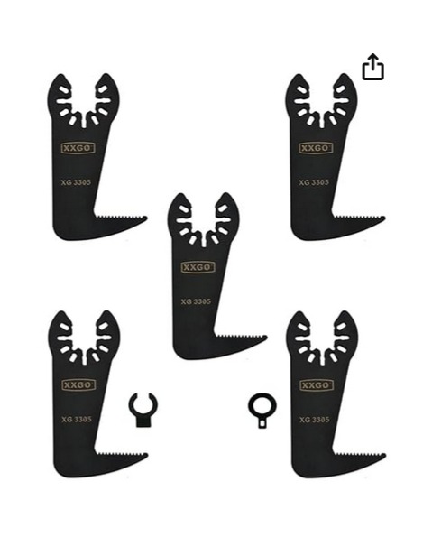

Are you also aware that there are blades specifically designed for cutting PB with a multitool? Here are two types you can find on Amazon and else where:

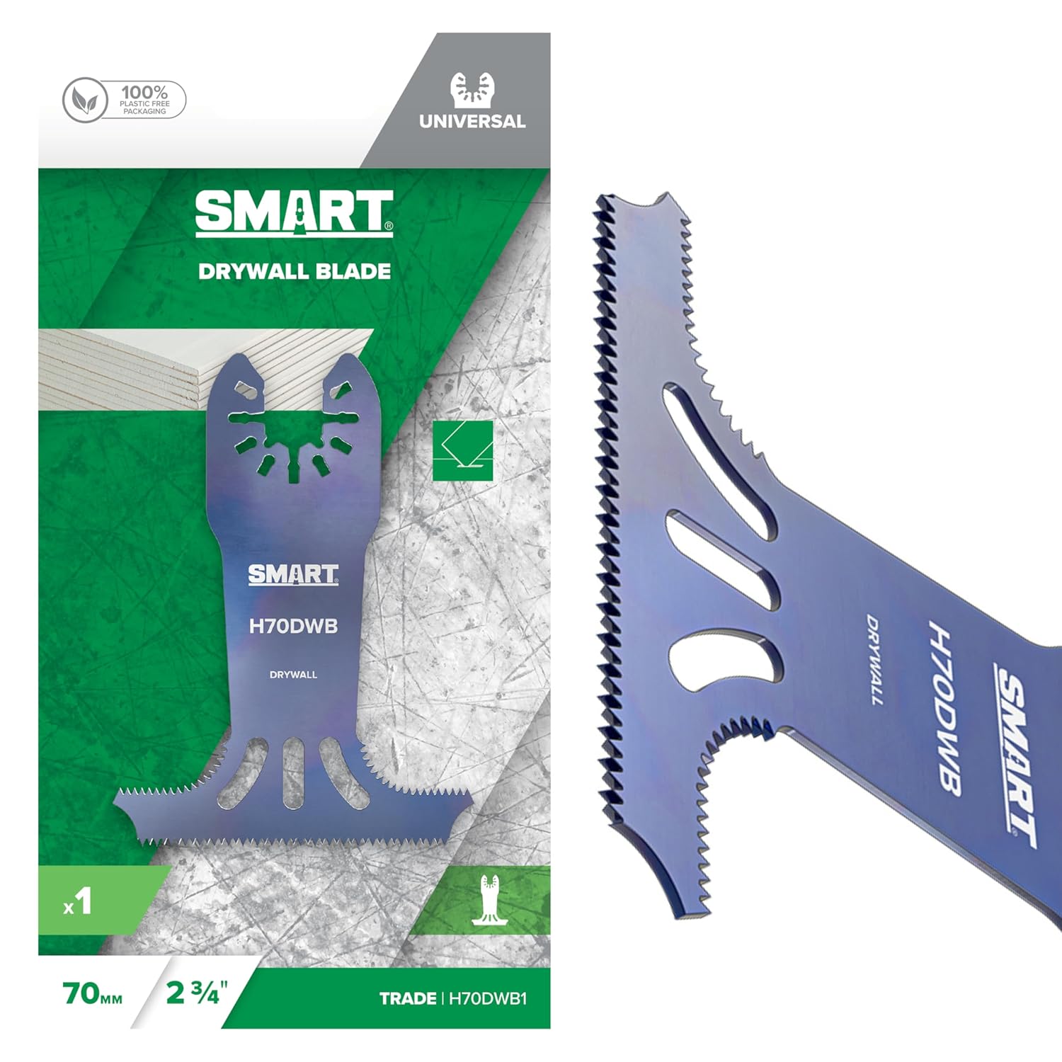

Smart does this type (also from Toolstation?):
I've tried some of the top ones, but not (yet) the Smart blades - great until you hit anything hard, like a stud...

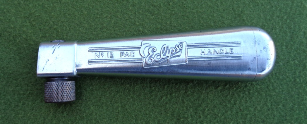

FYI Eclipse used to make a "pad handle" to hold broken hacksaw blades. Holds blades in either direction. They look like a big Stanley utility knife handle, the old #99 model, and are cast metal - called a no.12 pad saw handle and there are several on eBay right now for under a tenner (no longer made AFAIK)

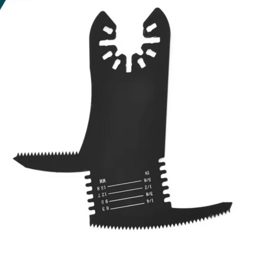

View attachment 382550View attachment 382551

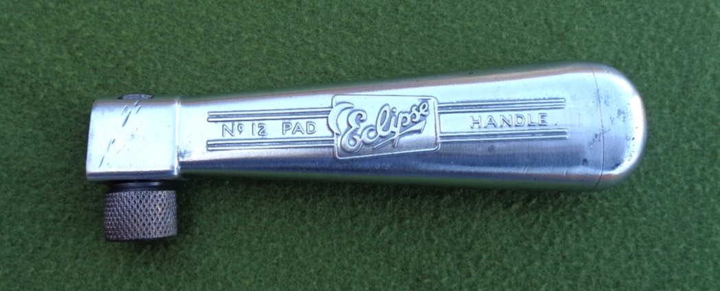

They are the same as mine and the type I was refering to in my post
