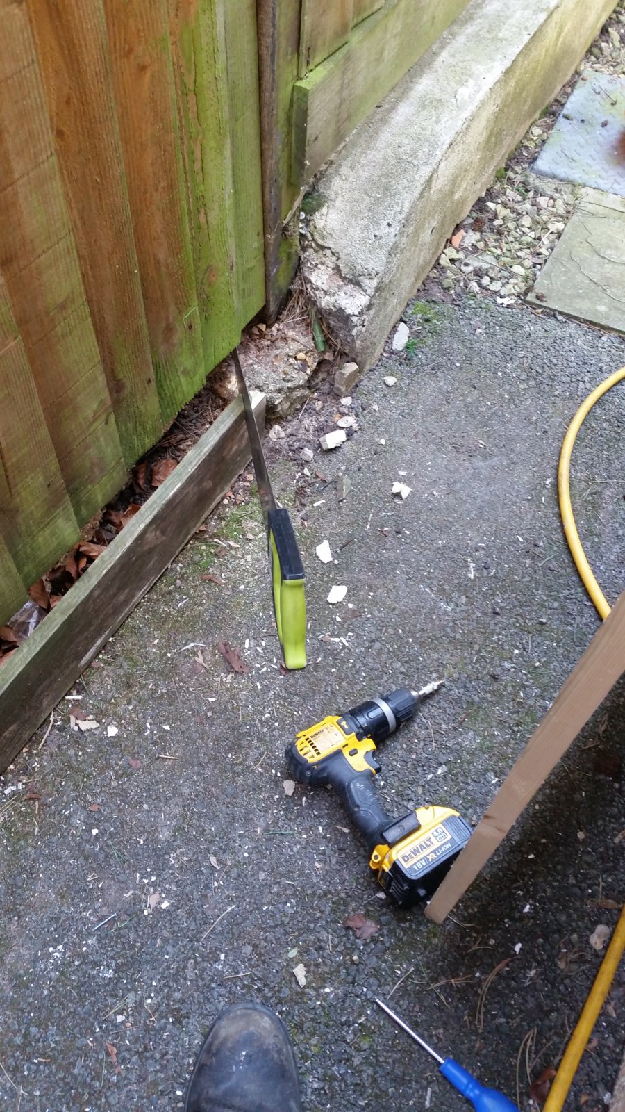

Would a reciprocating saw sort out that gravel board in photo I struggled with. And roots from trees in holes
On reviews I read the dewalt one was very powerful and could be dangerous, any safety tips?

No , you need room beyond timber to use recip saw , if it hits any obstruction the blade will bend .
The gravel board should be removeable in which case a jig saw would do the job
blup
Vibrating Multitool would be better doind that gravel board in situ maybe?.
Take a bit longer than a reciprocating saw but less chance if blunting a blade or kickback?.
Think I could get that out with a recip bit it would probably blunt the blade end..

Muti tool would do that gravel board ok.
Reciprocating saw can to branches and roots with care. If you're anywhere near soil with it you'll need a few spare blades though!.
