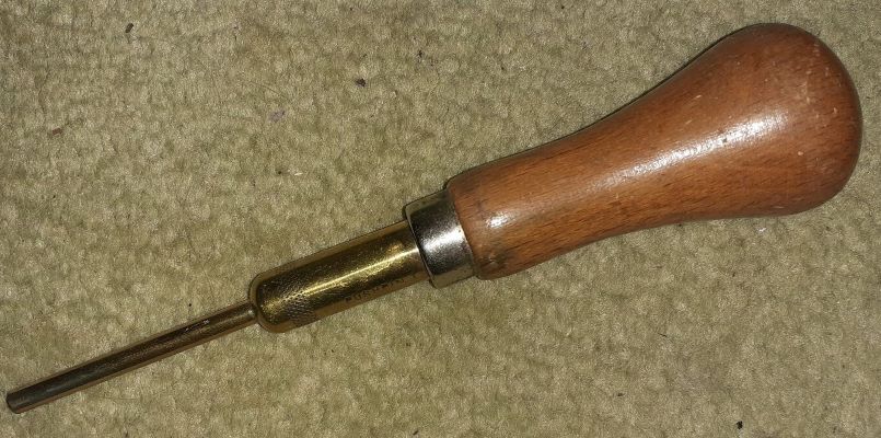

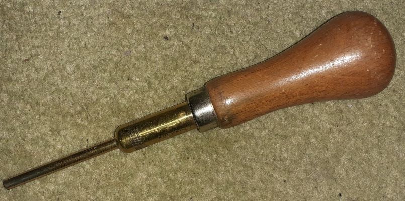

Face it @^woody^ - at heart you're a Yorkshireman. That really is old school, although there's nowt wrong with old school IMHO. The (minor) problem is that nobody makes them any more, do they? So it's probably flea market or eBay, but not expensive - a couple of quid
That's an older wooden handled one (Woden). Later ones (Record, etc) tend to have plastic handles
Yep, same sort of tool. I'd forgotten that Crown make them - the only thing I don't like is the price (circa £20)

On a busy day, it used to require three Shredded Wheat - plus a leather glove to try to avoid the inevitable blister on the palm after you use it a few thousand times in a day. That's why I preferred the wooden handled ones "back in the day"
