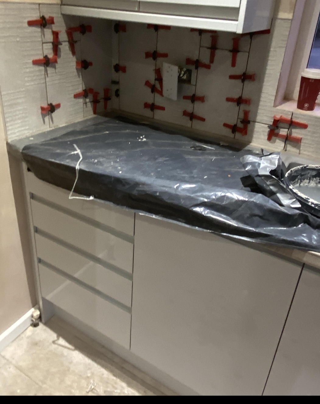

Hi guys
I am in a bit of a situation, our joiner has installed a kitchen and there's a drawer unit and fillet piece to the wall there is 60mm clearance between wall and edge of the drawers, I have been looking at the following options
1-an old type radiator 600mm high x 400mm wide with no convector (type 10 or p1 type) then wih modified brackets to pull the radiator closer in to the wall. The problem is I'm struggling to locate one as they must have stopped making and selling them. I have seen thin towel rails that would do the job many years ago on my travels but cannot seem to see anything currently available.
-2 a flat ladder towel rail of thinner construction that I can modify the brackets to pull it closer to the wall.
Trouble is the manufacturers don't advertise how deep the towel rail is.
If you have come across anything that will do or anything I can modify to do this I would appreciate any suggestions, after countless hours searching I am running out of options. I
have looked at renewing the drawer unit but they are £600+ and the client is an insurance company that has very tight rates so extra charges would be out of our own pocket.
Thanks in advance for any suggestions you can offer.

You can get plinth heathers that are wet type -> a fan blows air through a matrix that is heated by the central heating water, e.g. a Smiths SS5
I am going to try to use a white flat ladder towel rail and cut down the brackets and see how that goes, the customer is selling the house and just wants it done, failing that we will look to a plinth heater.

Bit late now but should have used a bigger fillet and narrower drawers. Can they be cut down or will that be too much work? You could possibly use a tall designer rad there.
A towel rad there will look ridiculous and may detract from the look. Don't forget, sellers are very informed these days and they will know that has been added as an afterthought/fudge. That then may make them think, ok, if that's been done like that, what else isn't right.
Towel radiators are only good for towels and they belong in the bathroom not the kitchen.
Without a doubt in that case a plinth heater is the proper way to go if there is no other wall space
Yep. I've got a drawer in my kitchen that looks like it's 600 wide but is actually 430 when you pull it open - it was 600, but collided with the pain in the ass crappy designer sink. I still wanted the storage space so I cut 170mm off the floor and rear and left the face wood as is; just had to drill new holes to mount the repositioned side rails in, and move the side of the cabinet holding the runners too. Easy job but more tricky if you have to modify the drawer fronts
