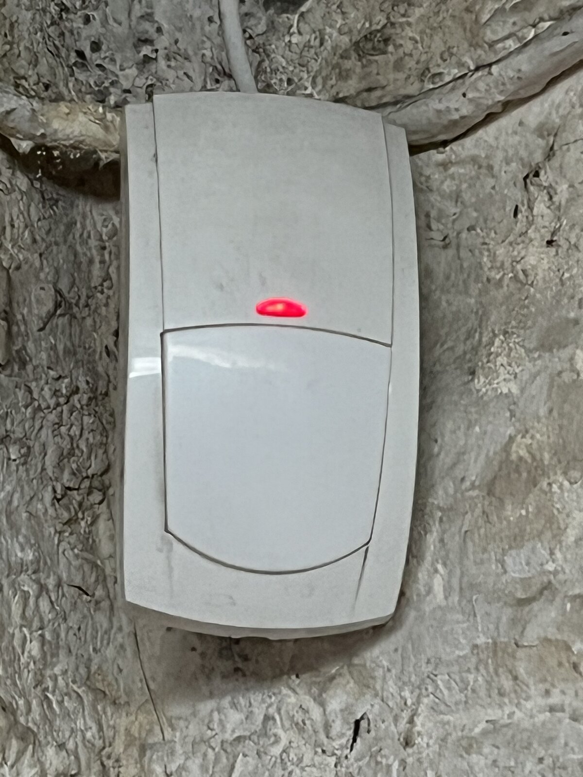

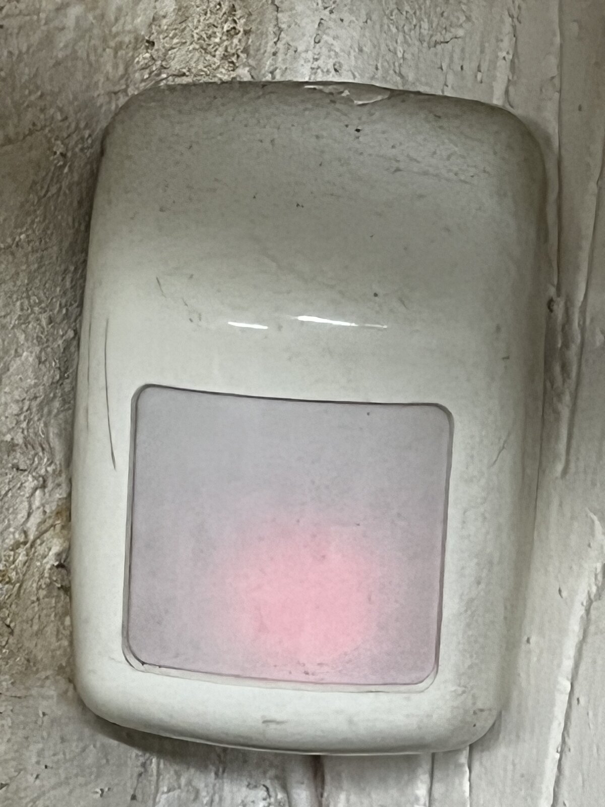

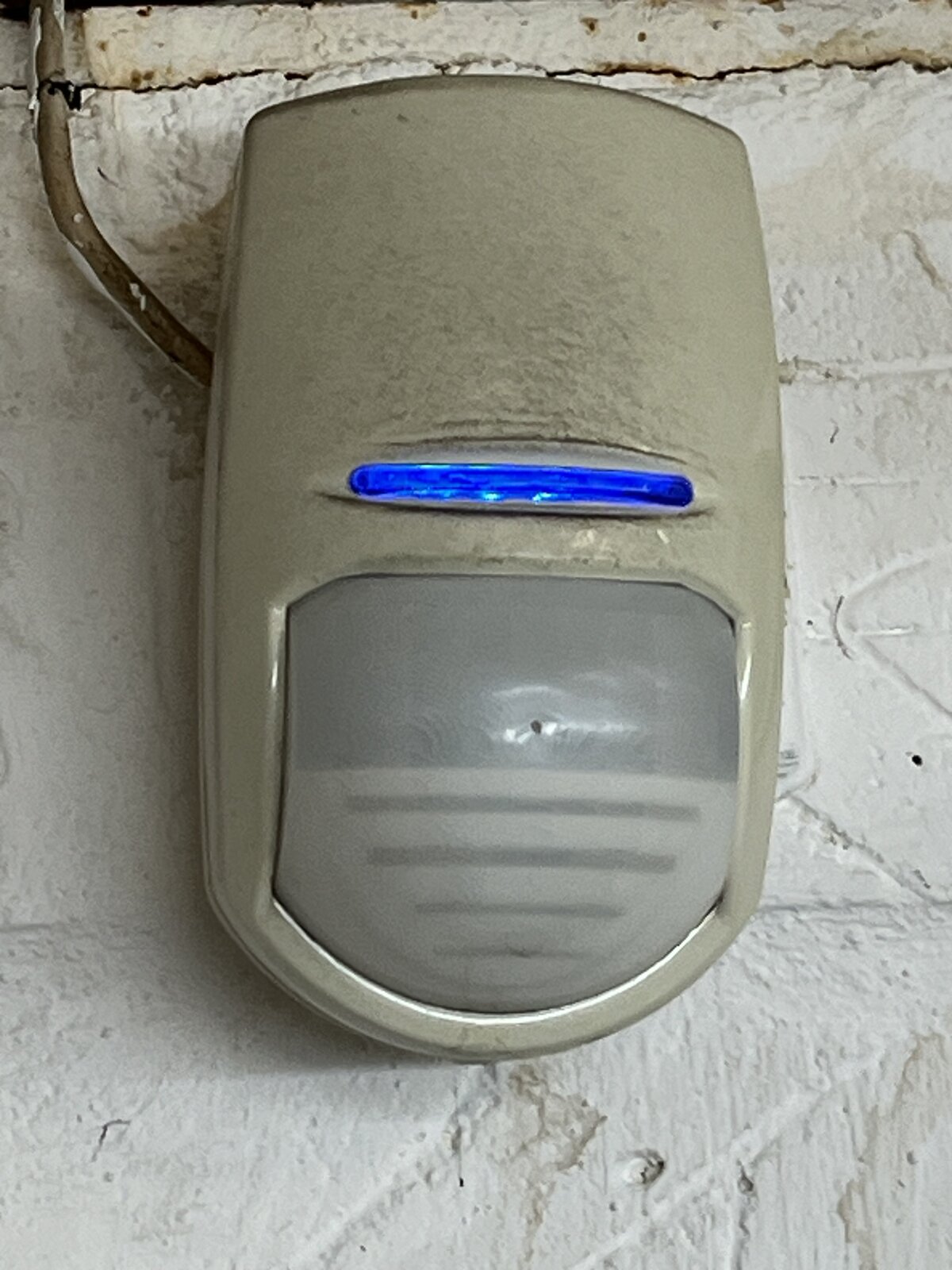

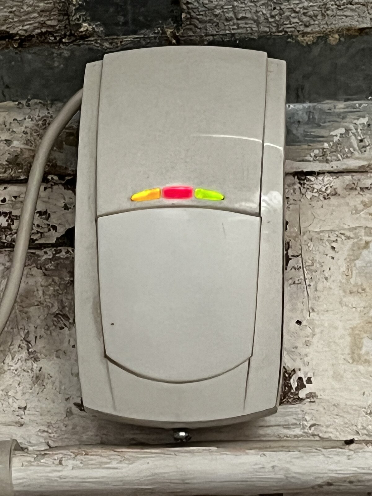

Images of the various sensors currently in situ - they are in an unheated warehouse and work OK but are old and throw an occasional false (probably not false but possibly trapped birds) and some have signs of water ingress.
Area covered is a long (40m) wide (10m) warehouse, placed every 10m down one side looking across and offices.
Want to update to new, DT in the warehouse and QD in offices and enable EOL.
What brands/models would you go for?

I would go for the pyronix same as the bottom unit in shape , standard case for all
Versions ….
I normally would use optex but they seem to have gone down the same stupid route as Texecom with the plastic cam instead of a screw to release the detector front …. Not a fan of this design

I assume apart from the physical design, from a technology perspective, there is currently not much to choose between Pyronix, Texecom and Optex and they are all good?
Optex was my ….go to detector ( not all ) ….started with the fx 35 in the late eighties…..then the rx40 …still. Just about available…..MX40 dt ….still just available…..no issues with these at all …other optex ….eg dx 40 /60 fantastic until they added the antimask technology…..then optimals….same again ….then CDX ….updated optimals ….a bit hit and miss …
Pyronix…..equinox E , then equinox 10 and 15 …..rock solid DTs
Texecom prestige range was ok … but had more failures
Problem is everyone has there own favourite devices depending on what reliable they have had !
