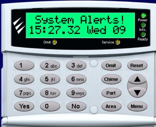

I've got a Texecom Premier Elite 12 which had been powered down for about a year until recently when I got it back up and running.
I've got 2 x door contacts and 1 x PIR that are wireless Ricochet devices and after powering up the system, the wireless PIR was reporting low battery which I replaced with brand new out of packet battery. PIR still reporting low battery. Tried the other new battery (2 in packet) but the same. Checked the batteries with a tester to confirm ok, and even the one originally in the PIR was showing as still pretty decent. As the PIR quite old and looking online which said sometimes problems with the tamper switches can report as low battery figured PIR must've gone faulty so removed it from the panel and ordered a new one.
My panel was on firmware version 2.10 so in the meantime I flashed the firmware to the latest v6 version which went as it should. The new PIR turned up yesterday so learned it with the panel which went as expected... but that too is showing a low battery fault! The new PIR came with a new battery too.
New PIR, another new battery, reporting a low battery fault - something other than the PIR must be generating the low battery fault...
Anyone any suggestions / ideas?

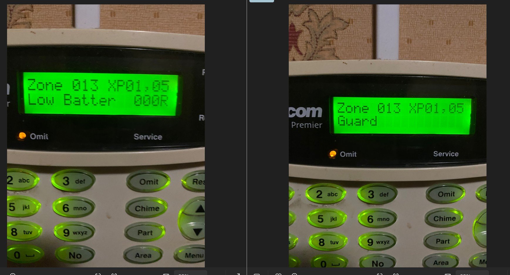

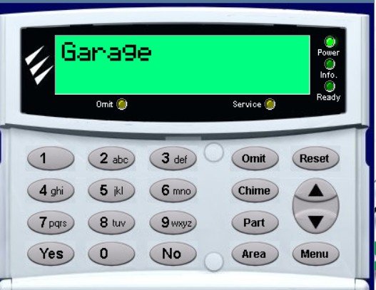

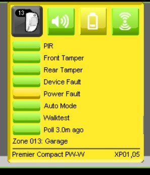

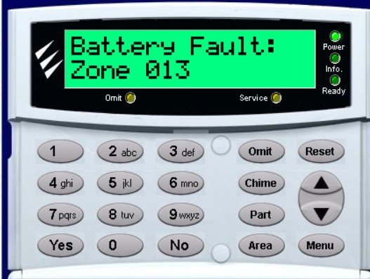

Some screenshots attached which will hopefully give you a better idea.
I have earlier today reset the ricochet expander removing all the wireless devices and re learned them again which made no difference.
The thing that seems odd to me is that when the PIR is first learned, the keypad and Ricochet monitor shows a tamper error because of course the front of the PIR is off, but only registers the low battery fault when the front cover is put back on - this was another reason why with the old PIR I thought maybe a tamper switch fault or something.

Zone 13 is a compact pet wise. They haven’t made these for several years now so certainly any replacements at best would be new old stock with batteries in them being old.
Cant speak for your tester as it may or may not be one for lithium batteries, tester I use gives a condition and voltage, from memory at 2.82V is the critical voltage for it to function may have to double check it’s been a while as we replace them every two years and don’t usually see power faults.There maybe a guide on the Texecom forum as what to expect based on voltages but can’t place my hands on it at the minute.

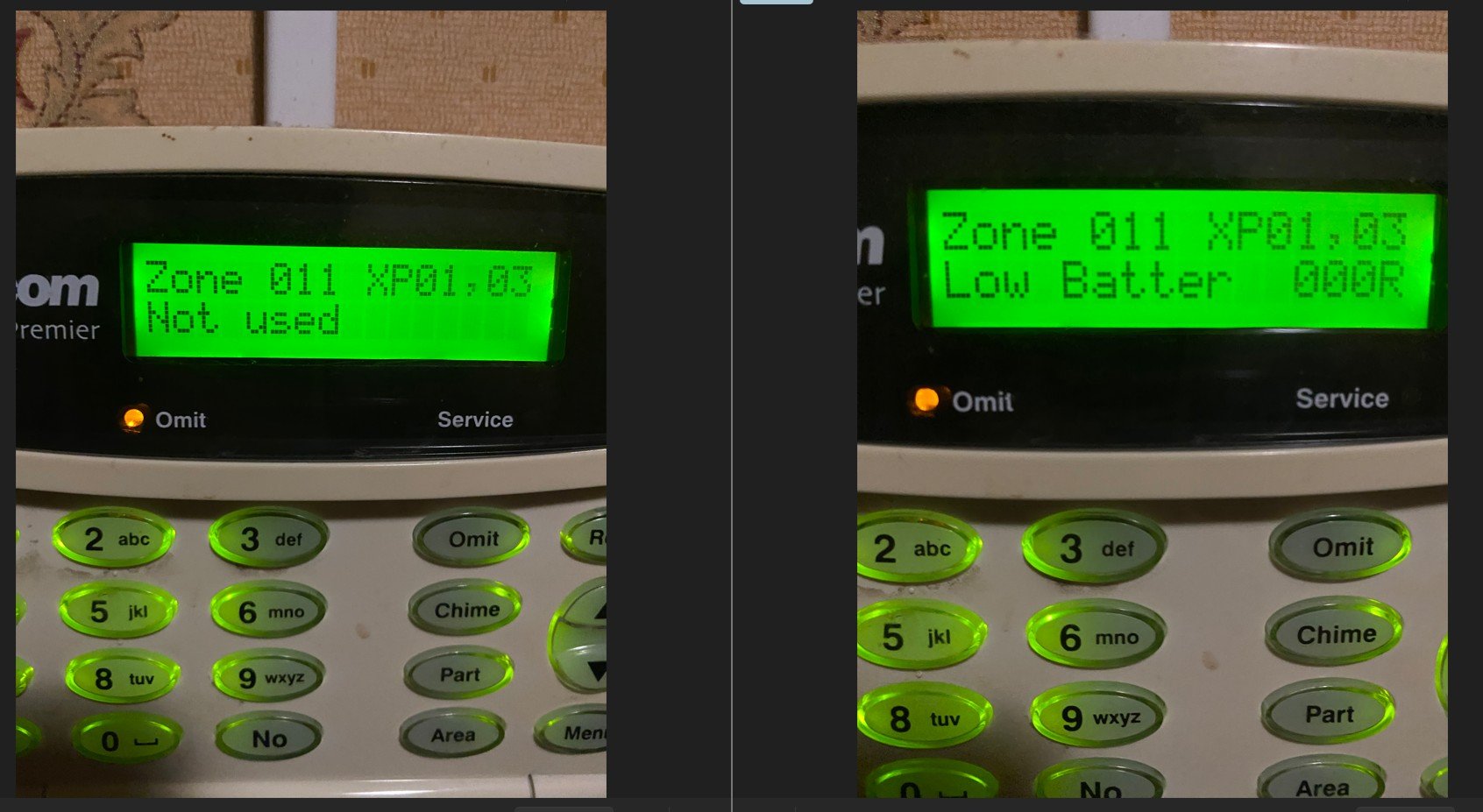

I also just noticed - the old PIR was attached to zone 11 which I completely removed ages ago before I even got the replacement PIR as it was the only way to stop the keypad fault tones (and since then I have completely reset the Ricochet expander and manually added the 2 door contacts and added the new PIR to zone 13 (thought using a completely fresh zone would give the best chance of no errors) - but when I check zone status from a keypad, zone 11 is still showing a low battery fault even though there is no sensor attached.

Well I don’t recall there being issues back in the day on this but it’s a long time ago, certainly know tamper showing up instead of a battery fault somewhere between v2 and v5 but slept since then.
Did you default the panel and manually reprogram it up?

Trying various things with the PIR earlier I discovered that when the front case is off it throws up the expected tamper fault, but no battery fault. I can see in the Ricochet monitor the panel still regularly polls the PIR but still only throws up the tamper. But as soon as the case goes back on - or you manually depress the tamper spring the tamper dissapears as expected and the battery fault happens. Then as soon as the PIR goes to tamper again the battery fault goes again. Is this normal behaviour for the PIR's?

My original PIR is a QD-W, which shows exactly the same fault and exactly the same behaviour. This is why I got the replacement as the QD-W was an original sensor from install which must be around 10 years ago so with the strange tamper / battery fault behaviour and the fact I'd just turned the system on after being off for a year assumed the PIR had developed a fault

The ricochet monitor shows lid tamper going secure and not battery fault if I understand correctly.
This suggest the panels interpretation, only way to attempt getting that cleaned up is default and a manual reprogramming.
