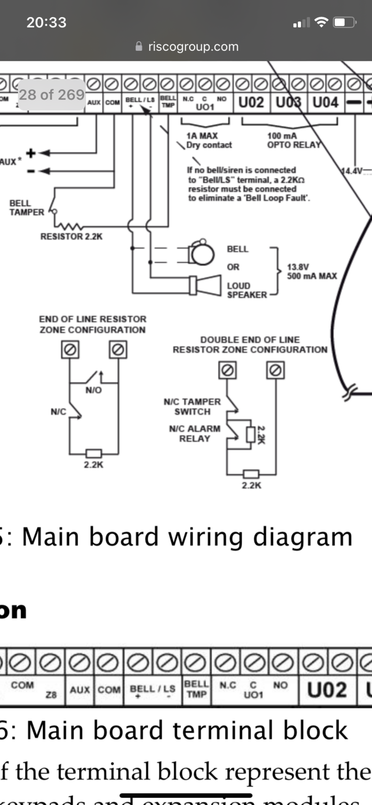

Thanks for that. Yeh your right with regards to the common terminal - its much better than this accenta set up! I’m familiar with EOL but not so much double EOL, Looking at the below manual it doesn’t look to bad, just two 2.2k resistors, I think I’ll go with Texecom PIRS as there seems to be a lot of guidance online if I get stuck!
I also guess the door/ shock sensors will be the same double EOL resistors too?

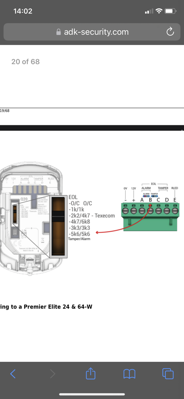

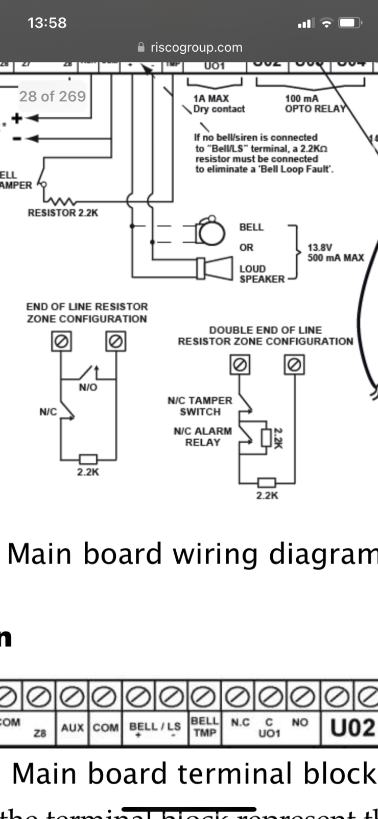

Hello everyone, I’ve purchased D20 PIRs but having a little issue with the resistor values,
I have the risco Lightsys2 panel and according to the manual it’s saying use 2x 2.2 resistors for DEOL, however these texecom D20 only have the option for 2.2 and 4K7 resistors on the variable switching options in the sensor, please view the attached images and please can anyone advise if 2 x 2.2 resistors would be sufficient in the D20s? Thanks again everyone.

you can select on the panel or you can select 0 on the pir and manually add the resistors to the PIR
