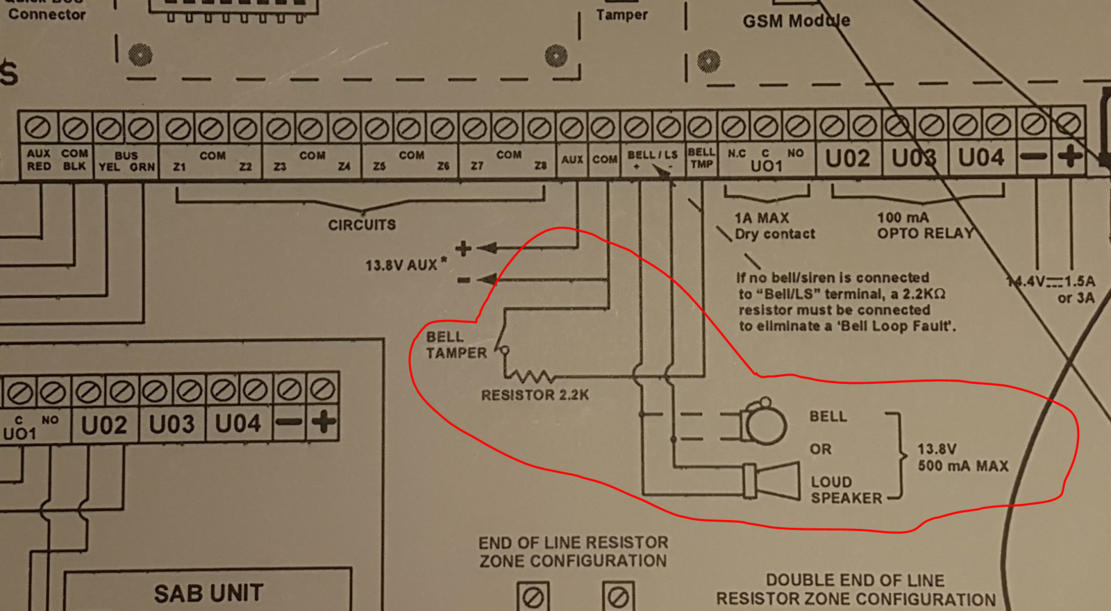

1 - Is there a wiring diagram for the PIR? I cannot find one that is simple enough for me, and shows exactly where the 6 terminals should be connected (for a given zone). Is the 7th terminal (LED) connected to anything?
2 - I cannot wire up the bell without the bell temper being triggered. There seemed to be instructions for connecting the bell in the wiring diagram which I'm pretty sure I followed (in the attached picture)
3 - Should each of the unused zones have a resistor between the Z terminal and the COM terminal? That's what I did to stop the zone tampers triggering. Is that right or is that mad?

Why on earth did you choose something like this to install with no experience!
The diagram you need is bottom left of picture ( cut off ) labelled SAB
you normally need 5 cores to connect most standard bellboxes
Ah yes, a Self Actuating Bell! Ok that should help with that.

The lightsys panel has zone terminal common and zone terminal, depending on what devices he has he can wire it to the bus(must be risco bus devices), or he can wire it to the zones, I would opt for DEOL if doing the latter as it will make things easier if they go wrong and one device one zone, otherwise its a global tamper.

I think the information I needed was the Double End of Line Zone Configuration, not sure if that will get me there or not. Anyway, I've given it to the electrician as he does have experience of wiring this type of alarm. I was just interested in learning.

To be fair you have answered some of your own questions but you probably don't realise it, we don't know whos bell you are using and how you have wired it versus how you think about wiring it, the panel from the diagram is looking for a resistance of 2.2K to be secure wrt to the bell tamper.
but if you was using one of the bus sounders from Risco you would use as many wires and you would be wiring to a different place on the bell and the panel.
