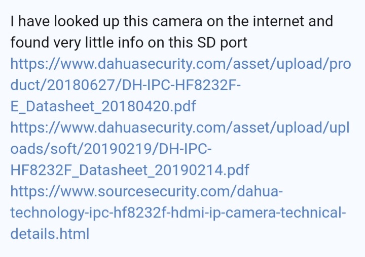

I have looked up this camera on the internet and found very little info on this SD port

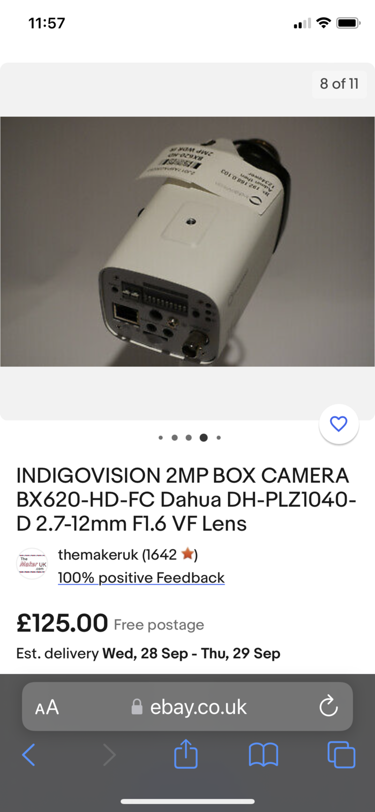

Indeed yes they do look old, however I recently saw some looking similar to these:

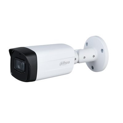

A Dahua network camera
probably still ok
Don’t use a car charger ….they may be password locked ….

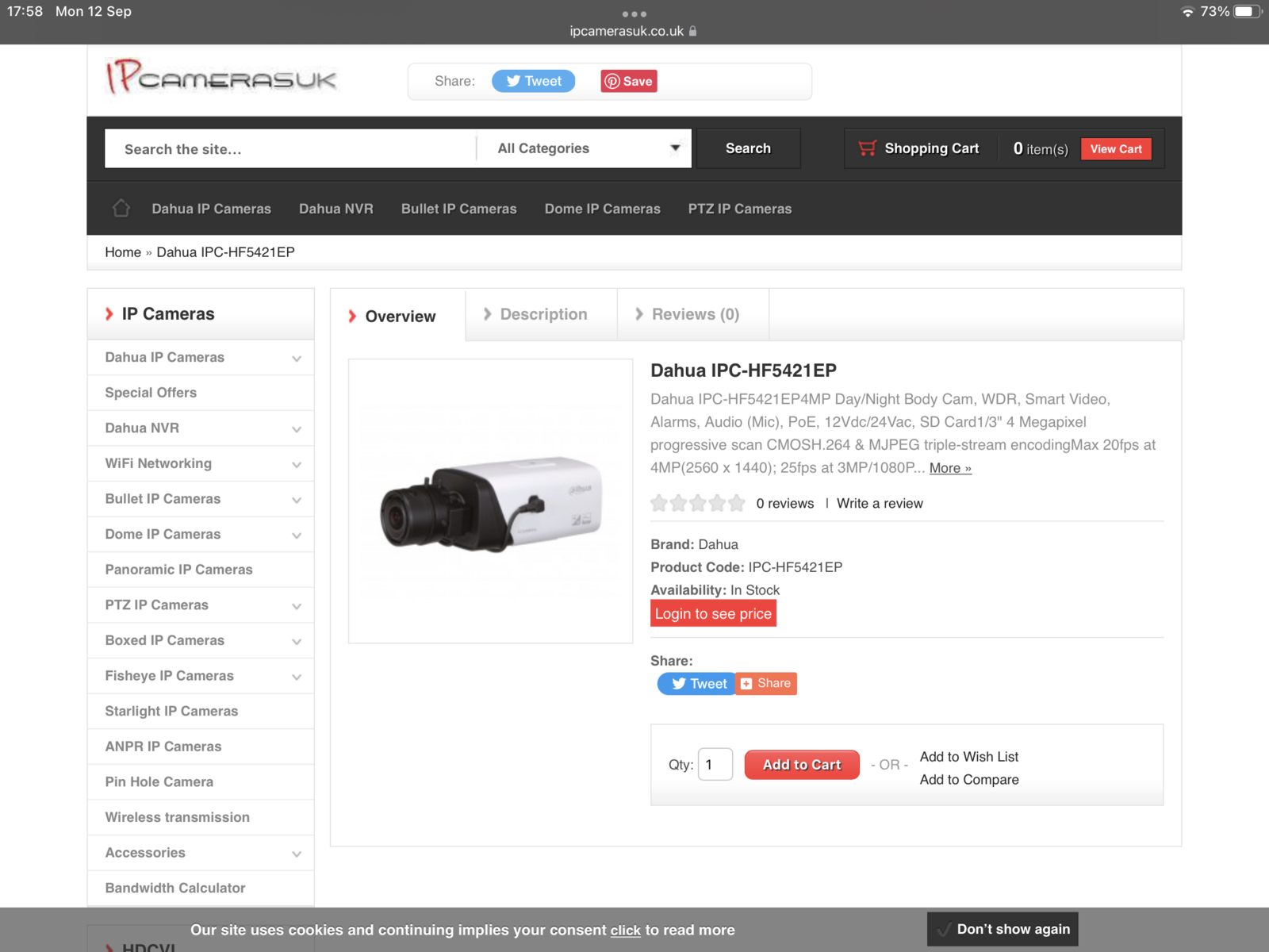

Data sheet: https://www.ipcamerasuk.co.uk/pdf/HF5421EP-Datasheet.pdf
It mentions "Video Output 1 channel BNC(1.0Vp-p,75Ω)" But as this is still a current model it wouldn't surprise me in the slightest if it's 4in1etc multistandard.
