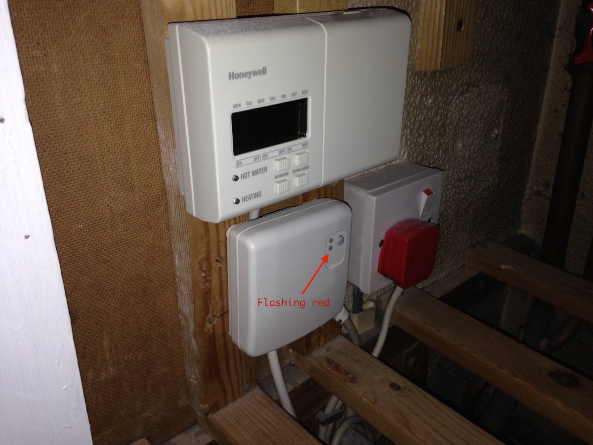

I have a box in the airing cupboard which I don't recognise. The box has two LEDs and one button. The bottom LED is flashing red. The other LED is off. See attached photo.
The original boiler was replaced about 5 years ago with a Valliant ecoTEC plus 415, but it looks as if the original Honeywell timer (ST6400C?) has been retained. I think the hot water cylinder was replaced about 2 years ago, but I don't have any info about it.
Looking around the internet, I suspect the mystery box might be a Honeywell BDR91 wireless relay box. Does that sound correct? If so, what does it do?
Do I need to worry about the red flashing LED? What does it mean?
If the red light is flashing then it's lost RF contact with whatever is paired to it (and gone into failsafe mode) - wireless thermostat possibly?

OK. Thanks. So is it likely that the relay is controlling the central heating or the hot water? Or could it be either? If it's in fail-safe mode, is it likely that either the central heating or hot water is not working...? What's the worst that could be happening...?
Most likely it's connected to you CH - what type of thermostat do you have?

All I know is that it's a "Honeywell wireless room thermostat" (as per an old invoice), although I've never actually seen it and I'm away from the property at the moment.
The most likely fault is the thermostat has lost communication with the relay - flat batteries is a possibility.
If that's the case, then the stat needs to be re-bound to the relay. Once you have the thermostat model no. then the Honeywell website will give the instructions on how to do this - simple process

Great. Thank you. In the meantime while I'm away, do I need to worry that the central heating might not be coming on in the cold weather...?
Depends how the system is controlled/configured - at the moment there is no feedback about room temperature to the system.
