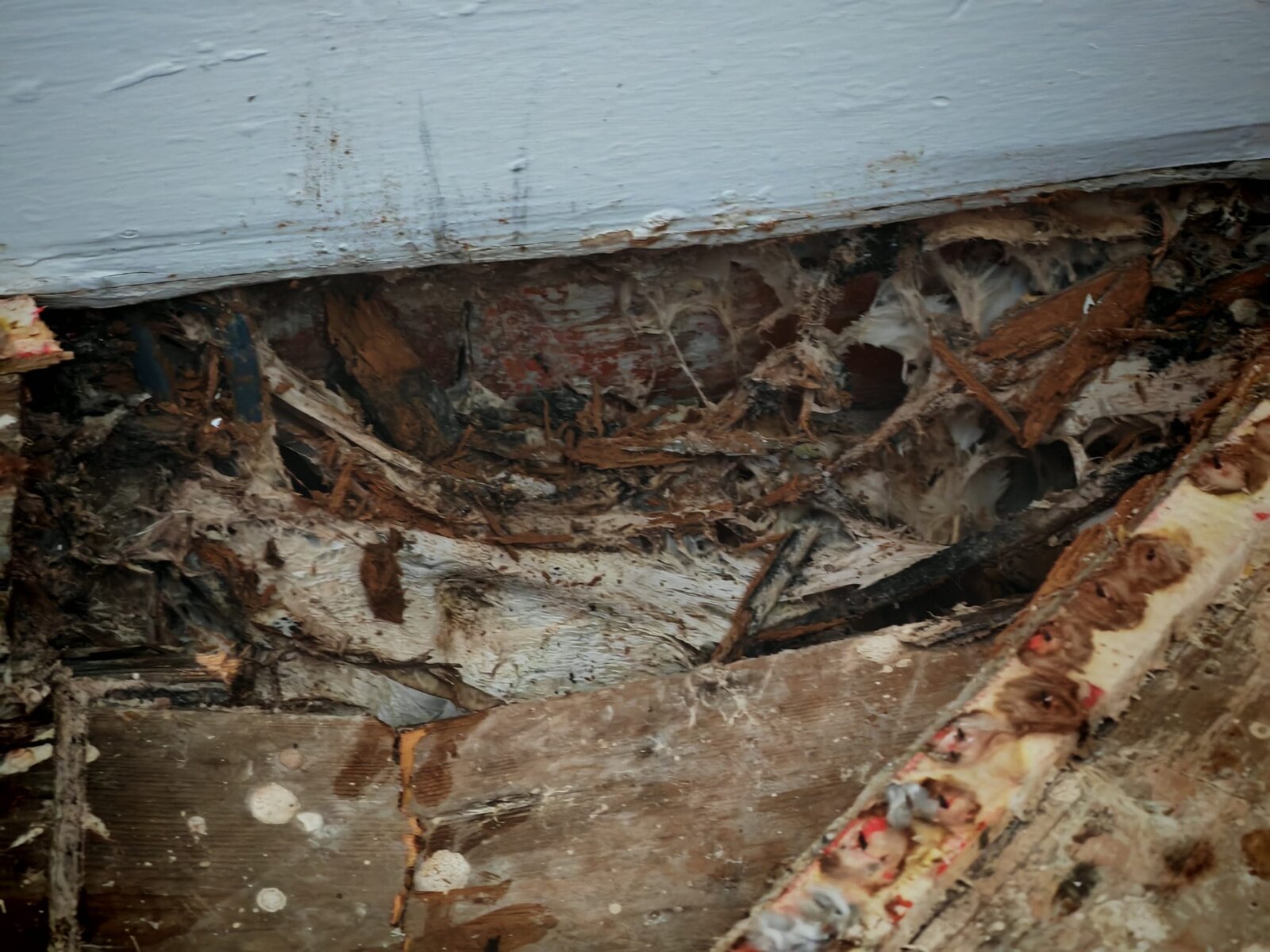

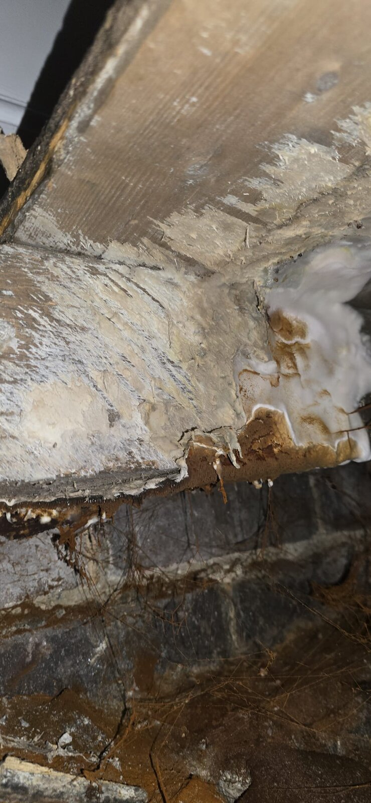

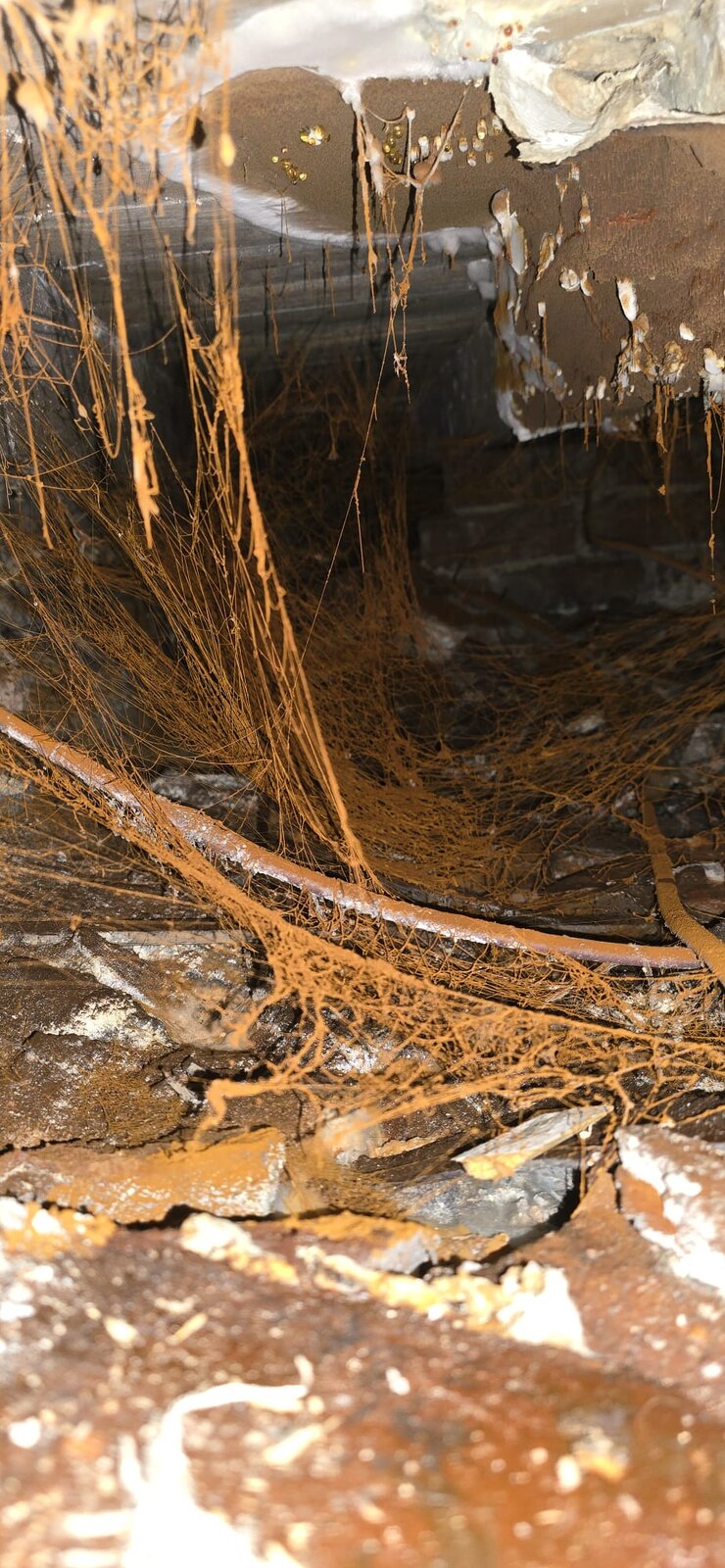

My lad bought a house recently , came across a damp soggy corner under tge carpets ,obviously lifted ,,the floor was like porridge. Upon inspection th3 under floor is covered in a red weed , obviously damp has got in ,,possibly airbricks too low , maybe a roof leak but for now, getting a few quotes on safe removal and treatment and repair of wherever the damp is,coming from.
My question please is is this weed a danger to health as his wife is pregnant and maybe spores,if we try and remove may create a bigger health issue than they already have .
One guy ballparked 10 to 30,000 to remove and secure safely, obviously I'm seeking various opinions and info from knowledgeable guys ( that's you !)
It's a big heartbreak for them right now .

Thanks , we are looking at maybe spraying in situ with bleach or something as much as possible and hopefully killing as much before we attempt to remove. He hasn't got that kind of money so its trying to do the things as he can as safely as possible and trying to keep the costs down , but with his Mrs up the duff its a danger they are concerned about .

What your pics show is dry rot, & your proposal for spraying it with bleach wont work & could cause further problems - dont do it.
The only spraying takes place after fully opening up the damaged areas - then you spray with a fungicide.
There's no cheap & easy way for dealing with what you show - the dry rot possibly extends much further than shown in your pics. There could also be a possibility of the floor collapsing.
Mortgage surveyors often try to cover themselves by claiming that they dont lift floor coverings but I suspect there were enough indications during the survey to require a further inspection at least?
The surveyors did say that,," floor coverings were not lifted etc " apparently the airbricks are very low outside and could be the issue but would think a surveyor might have noticed that . Not a great place for them to be right now. So no easy fix or cheap sticking plaster as I had hoped but who would have bought that if the survey was half decent ? Could be decades of it too .

It's dry rot not green monkey disease or asbestos. Yes not good for the pregnant missus, but nothing to stop you getting in there with overalls and masks and ripping out all the floor and anything that looks affected. Bag it and skip it.
Then get a company in to spray everything. Also find the source of the moisture. It's going to be an expensive job but you can mitigate some of the cost by getting your own hands dirty.
That was my outlook 3 days,ago but All the talk of the spores getting airborne and finding new places to infest if disturbed... curtains, bedrooms, etc its almost asbestos like the way its portrayed if not dealt with safely that's the worry, id gladly get stuck in but any long term issues, I may create doesn't bear thinking about .
