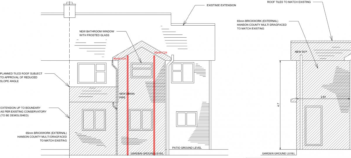

I should have seen this coming really but the council came back on Building Regs plans and noted the reduced return on the back door. We'd like it to be 415mm with a 900mm opening. They've asked for "justification".
What is this usually? It seems from Part A that there is an unclear reason for the 665mm limit, and doing the simple calc in there limits us to 150mm if that wasn't in place.
Is this all down to buckling therefore? and is it:
a) calculatable
b) justifiable without calculation?
We're up to floor already (they didn't have any comments on anything below ground) so keen to continue.
Many thanks
Some SE calcs are in order here, BC are unlikely to be satisfied with any other method. Prolly £50-100 if you can find a little one man band type of chap and provide him with all necessary information.
Is the 415mm return internal or external? - seems an odd size (ie not brick-length).
As above, it is 'calculatable', and it actually helps that you have a second storey on top. The issue is not one of the brickwork 'buckling' or crushing, more one of lateral stability under wind load.
The wind load exerts lateral pressure on the return, which induces tension in the mortar joints, which is definitely a no-no. The compressive load from above tends to counter the tension and helps maintain stability.

Bit of a late reply on this one, however speaking to an SE he wants to either write "correspondance" with the ECO, or else insert a steel and calculate. Different price for both.
Is he on the wrong track or were the above answers assuming a steel would be necessary?
It sounds more like he knows it will be OK but can't calculate it without a steel being in place in the calcs?
It's purely an issue of wind loading. By 'steel', does he mean windpost?
If so, those are expensive and - in this instance - almost certainly unnecessary.
Does he know how to prove stability under wind load without additional steel?

However the BCO is likely to require a calculation and the engineer won't win him over with just words. It should not need a steel post either, and any slender masonry corner can be justified in a domestic situation

I'm at a loss at the moment. The guy we appointed now wants to install 95x45 C24 in the cavity either side of the window. From DPC to wall plate.
I think it's back to the drawing board, or rather yellow pages. What a nightmare!
What in the name of Heaven would sticking two 4"x2"s in the cavity do??
Avoid them like the plague - they don't even know what the issue is.
