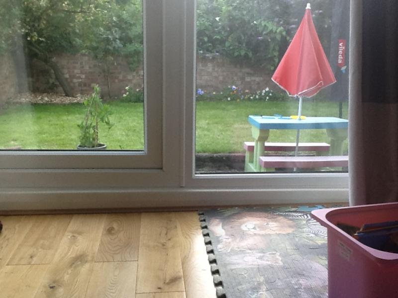

Hello, am planning to have our back door replaced with double french doors.

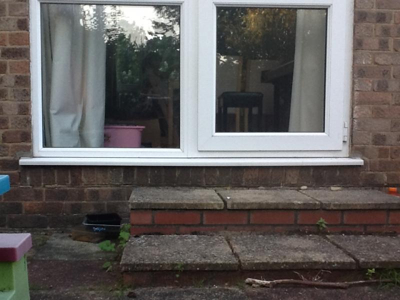

Am wondering whether it is practical to have a row of bricks removed so that the door threshold is lower, to reduce the height of the step out into the garden. Have attached a picture.
Concern is whether this makes the project massively more expensive / complicated. Best quote I've had for a new french door so far is £1200.
The row of bricks under the current door is right on top of the DPC. Is it a problem if is damaged when the bricks are removed? I presume not as the french doors will have PVC frame.
Thanks for any tips
muppetina
The pvc cill of the new doors can sit on the DPC, just make sure when the doors are measured they take the removal of bricks into account
