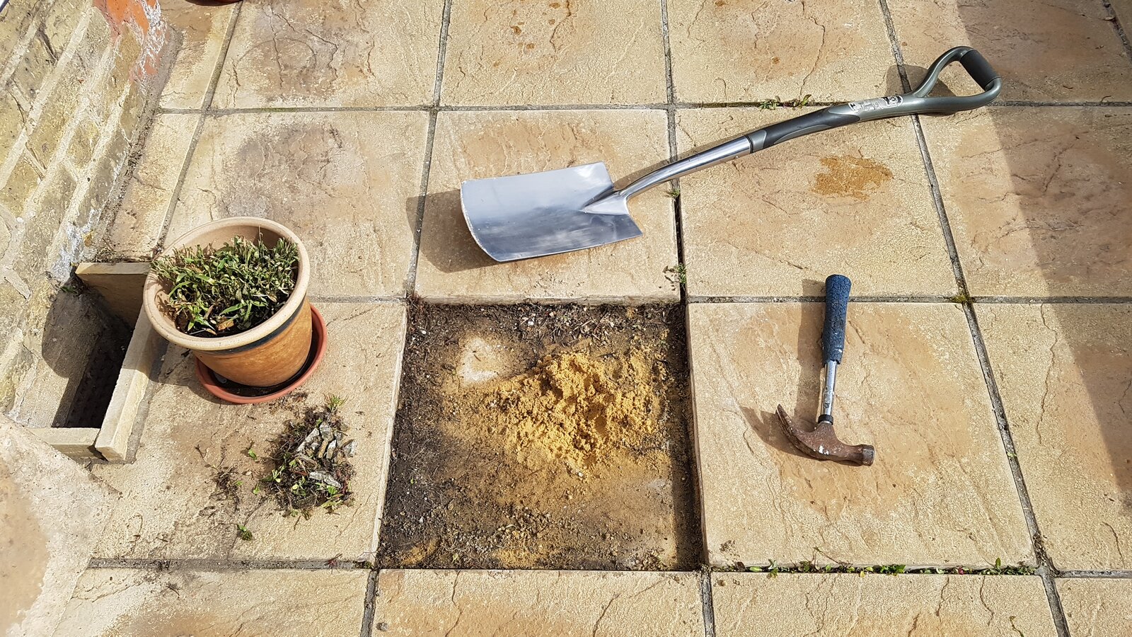

Hi guys. I've lifted a patio slab that was rocking when stepped on and also had some broken pointing.
There's loose sand underneath which I've piled to one side and it was covering a bit of a cavity or dip in the area under the slab. I'm wondering whether to pat the sand back down and just put some large blobs of sand and cement mix in each corner?

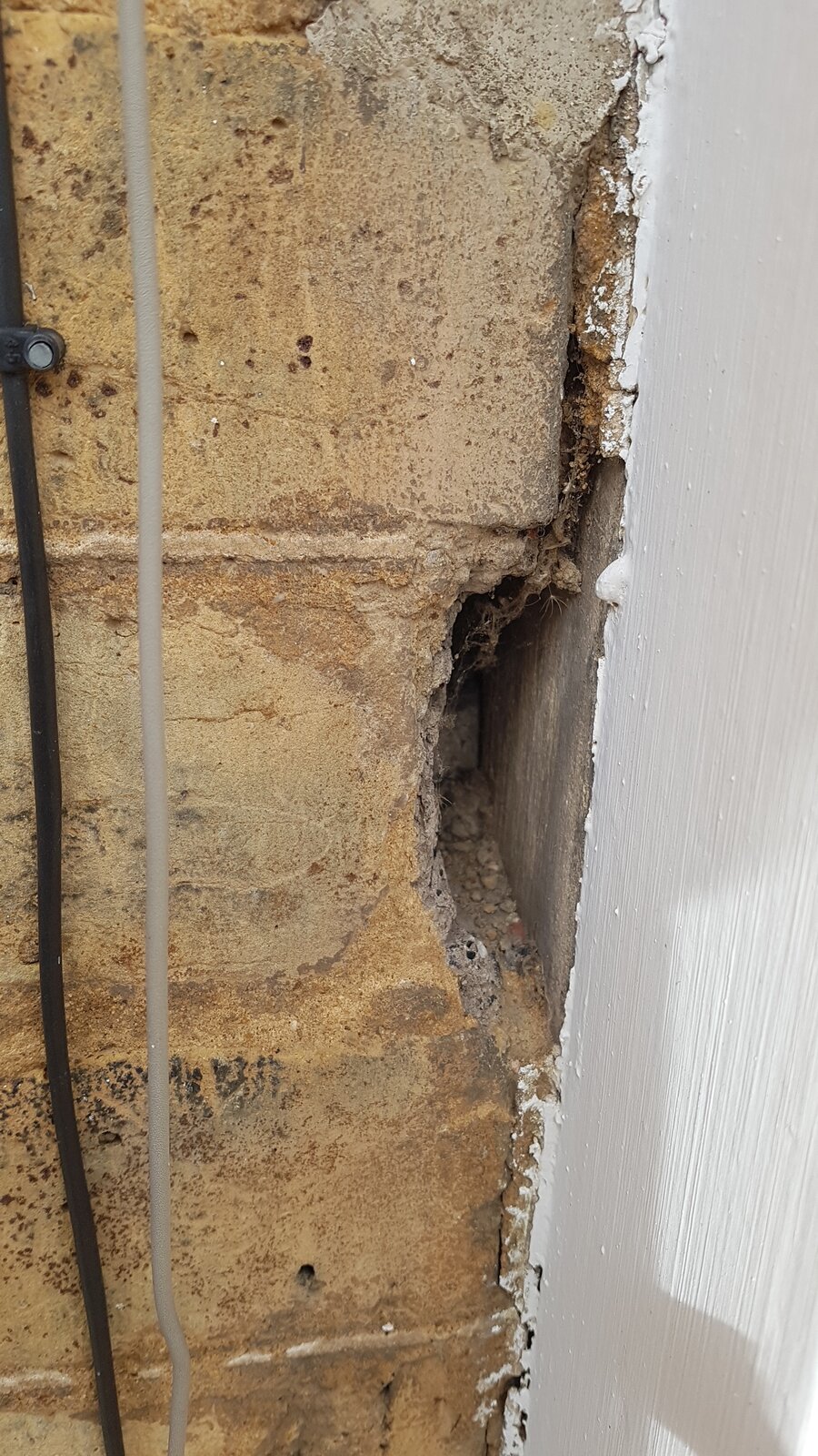

Do I need sharp sand or building sand or it doesn't matter, and would you recommend mixing 4 parts sand to 1 part cement? That's what I've been seeing on YouTube videos. And 3 to 1 for mortar joints? And a gauging trowel? I also want to fill a small 3 inch by 1 inch hole in my front wall.next to the window frame.

Lay the slab on a dry bed of sand/cement 3 parts sand to 1 cement.
1 bag of sand and cement will do both jobs, you'll have plenty of cement left.
Building sand will suffice

At that price it's probably around the 20kg mark.
Mix the sand and cement dry and fill the void under the slab, level off, lay your slab and water afterwards. This should be sufficient. If you want to mix wet you'll need to dig out the base that's currently there under that slab.
Thanks. How do I water after the slab is laid, and shall I make up a 3 to 1 for the pointing and add water to that I presume?
If what is in there already is sand - then dig out 3 or 4 inches, mix a shovel full of cement into the sandy stuff that has come out - put it back in (without adding water), lay slab on top and tamp it down until it is in the correct position - repoint - job done. (the natural dampness in the ground will help the cement go off and semi bond it all together.)
You may very well get away without using cement, plenty slabs are laid very successfully onto sharp sand.

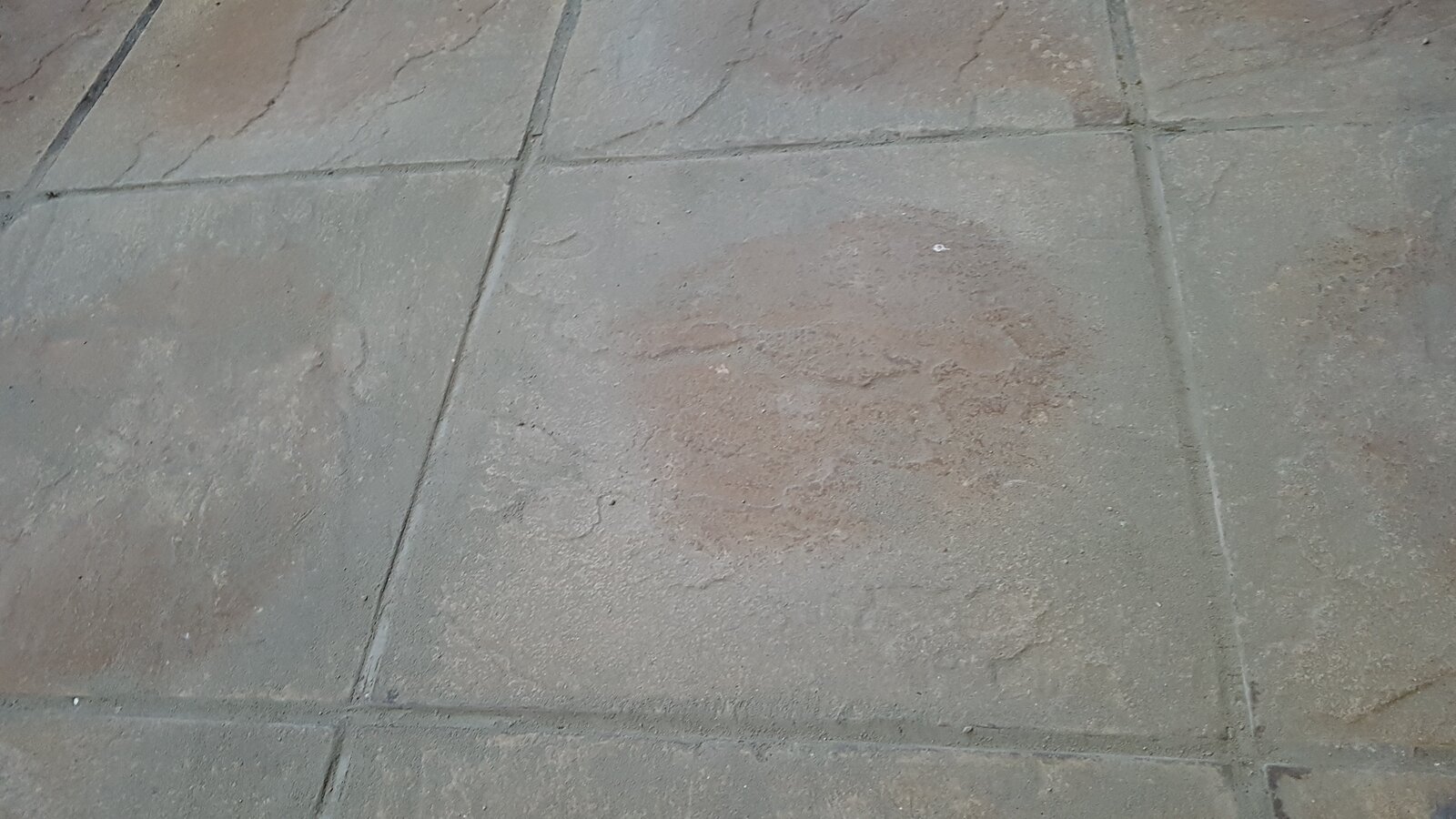

All done. Took a few minutes of relifting the slab a few times to remove excess sand and cement and smooth it down because the slab was sitting a bit high, but now it's pretty flush with the rest. And then pointed the surrounding gaps with the leftover sand and cement. No water added to anything.
