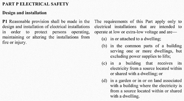

Regs for extending RFC and lighting circuit
Part P of The Building Regulations:
That's it; there is no more.
So, they probably mean something else.
Yes, you may do all the work and certificates if the BCO deems you competent.
I'll have a chat with them and see what they say. I suppose it will come down to if I can convince him that I'm competent or not..... seems a bit flakey really, that it basically comes down to someone's opinion.
I might have been thinking of notifiable work where you have to employ a registered electrician OR pay the BCO a fee before the work is started (might be included in the building notice) in which case they will then deem you competent or not.
For non-notifiable work I suppose you could just get on with it BUT if the BCO then finds something they don't like you would be back to square one anyway so you would be better off talking to them in the first place.
