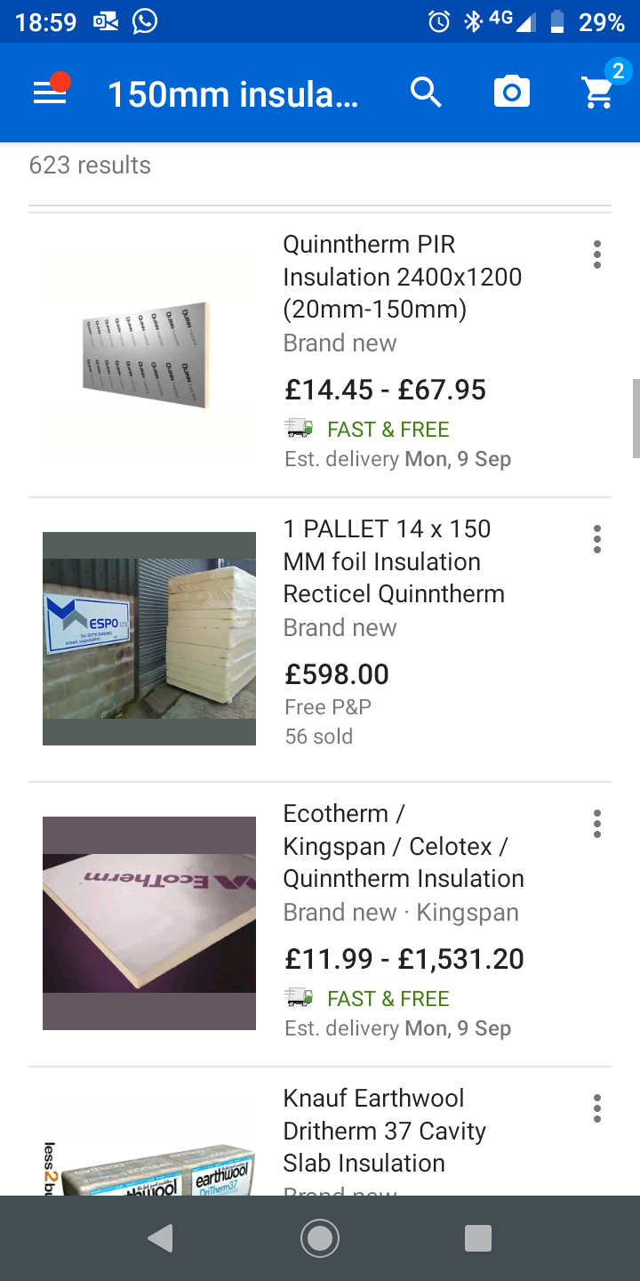

Cant you just take 50mm insulation off the wall and stick it on the floor?
I mean its the same amount of insulation, right? (y)
