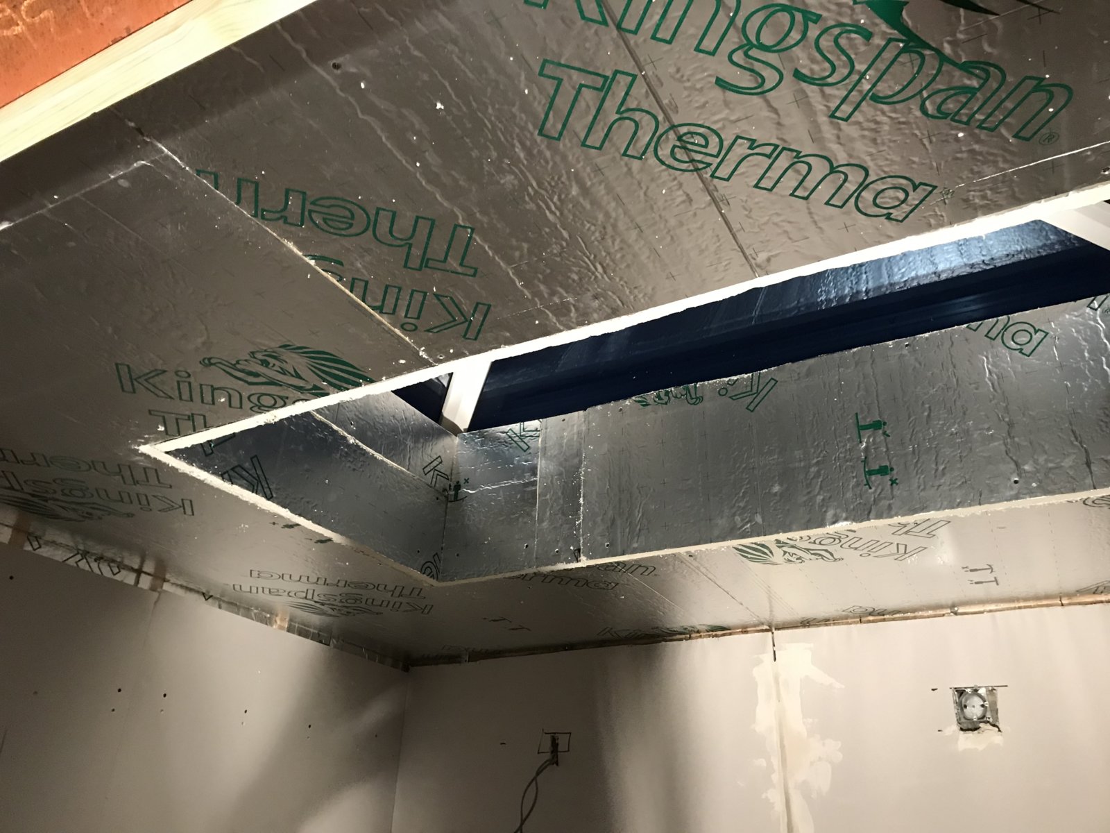

Hi,
We’re part way though an extension and are doing some bits ourselves. The builder did the construction, but we’re doing the roof insulation and the boarding.
We’ve used 10cm kingspan between the rafters, and will then cover the whole thing in 2.5cm Kingspan, which is what building control want.
Do we need to tape the rafters between the 10cm insulation with foil tape to meet bulidng regs?
Many thanks,

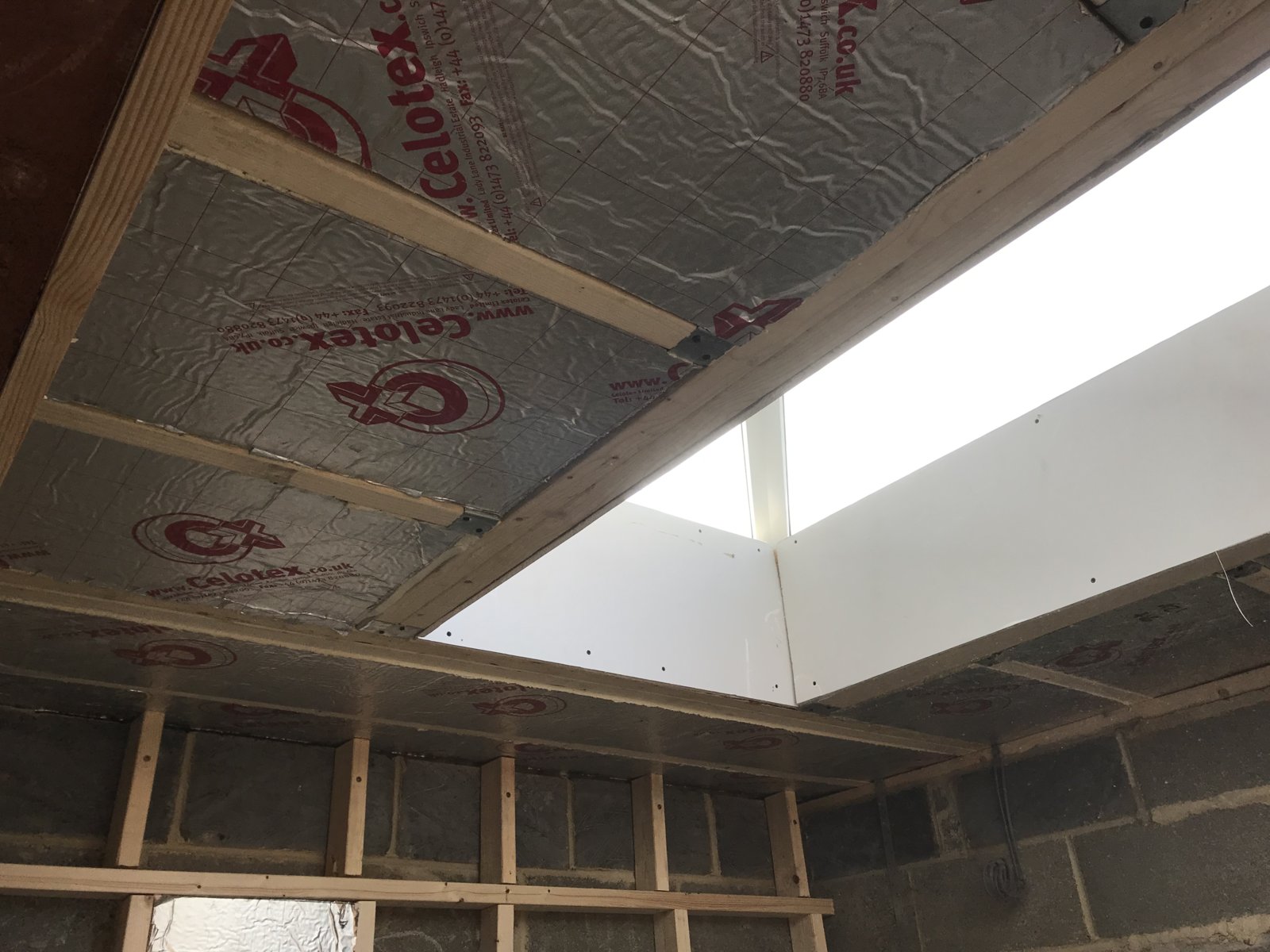

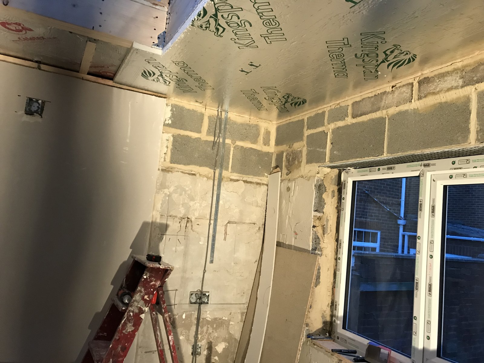

Thanks for the replies,
John D v2.0, the 25mm is also a aluminum lined PIR board, so would it need another sheet?
I’ve attached some images of what each layer currently looks like...

either tape the joints or a poly sheet. In your case tape as suggested by Ian would do it easiest.
I did both when I internally insulated our ensuite shower, as the old walls are solid uninsulated decorated walls i.e. no permeability on the cold side, and the shower would obviously be humid. But once you understasnd the principle you can make your own decision.
Also as an aside, make sure it's clear where the joists are above, as someone will need to put the plasterboard up.
We foil tape both layers - i.e. those between the rafters and the next layer across the rafters. And we use foam in larger gaps....
