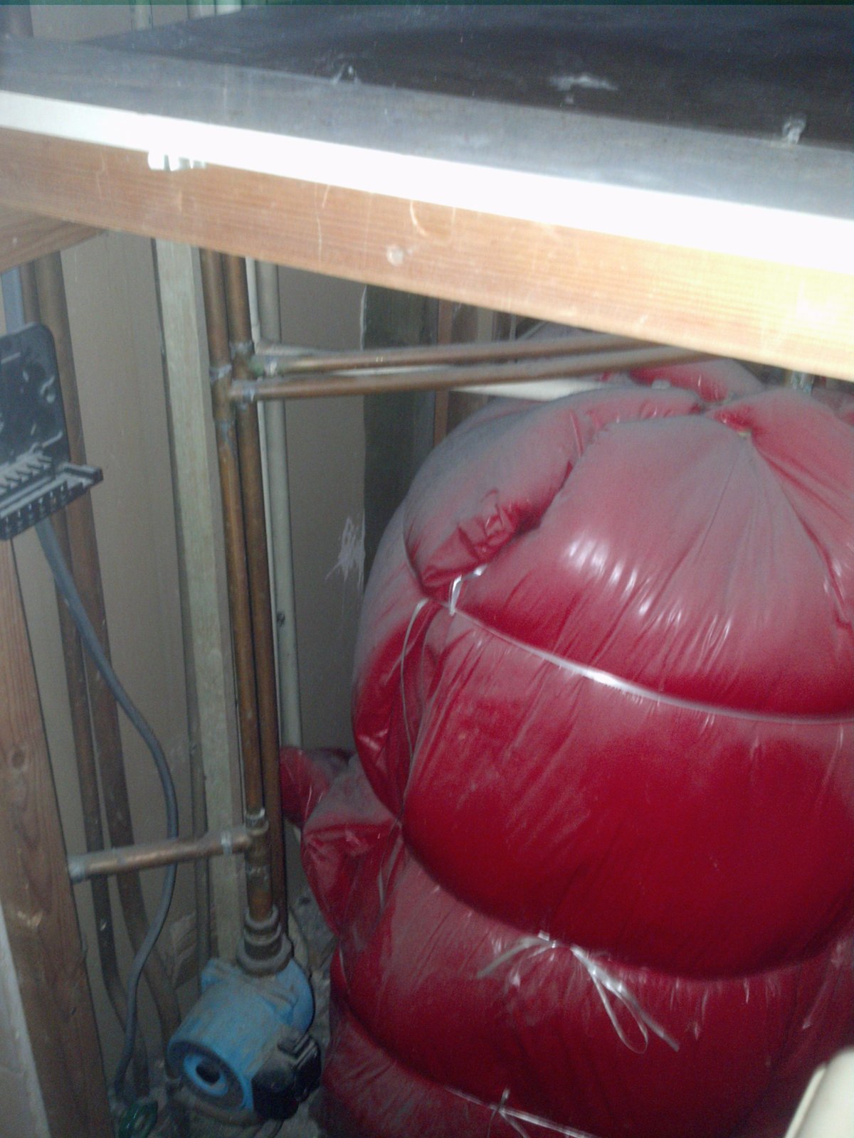

Hi,
I've had this problem before, and it somehow went away on its own, but now it's happened again. I've got a regular boiler, F&E tank in my loft and a cylinder tank in an upstairs airing cupboard. The CH has always been fine, but the water was taking longer and longer to heat up until now it never gets more than tepid.
Into the cylinder tank goes 2 pipes which are level with each other. One gets hot and everything beyond it is hot. The other is cold and everything beyond it is cold.
Any suggestions on things I can try, or some background info that might help me understand?
Many thanks
The two pipes that you refer to ,going in to cylinder at top ,are connected to a heat exchanger inside the cylinder ( bit like a radiator in there ) its that what heats the water around it. You have no flow through through it ,its probably blocked. It looks like a very old set up.

The two pipes are connected to the flow and return pipes of the boiler. ,the pump delivers water ,heated by the boiler, through the flow pipe ( which is the hot one ) and it runs through cylinder exchanger and out the other pipe returning to the boiler. So yes they would both be hot under normal running conditions. If there isnt a total blockage ,but a severe restriction ,you will get domestic hot water at a very low temperature ,and limited amount. Are there any motorised valves on your pipework ,none in your pic , they would have an electric cable running to them .
Thanks again. No, I don't think I have a mororised valve - that green tap/gate in the very bottom corner is supposed to allow me to switch between CH/HW, but doesn't seem to do much. Also, I noticed this morning that the overflow pipe (in the loft near the F&E tanks) in dripping water???

You mention a green gate valve that is "supposed " to allow you to change between ch and dhw. Is that the only thing you have to enable one or the other ? So in summer when you want only dhw and no ch ,what do you do ?
Gate valves are notorious for failing to either fully close or fully open
you have what I call a Hot water Blade as that is what it was called when I was an apprentice 30 years a go, was designed to go into an immersion heater socket in your HW cylinder, very prone to airlocking but could be blocked as will be very old , no reason why it cant be cleared though , more so if you still have some circulation ask an experienced engineer to help you out , not a youngster who puts an analyser in your boiler and tells you that you need a combi
