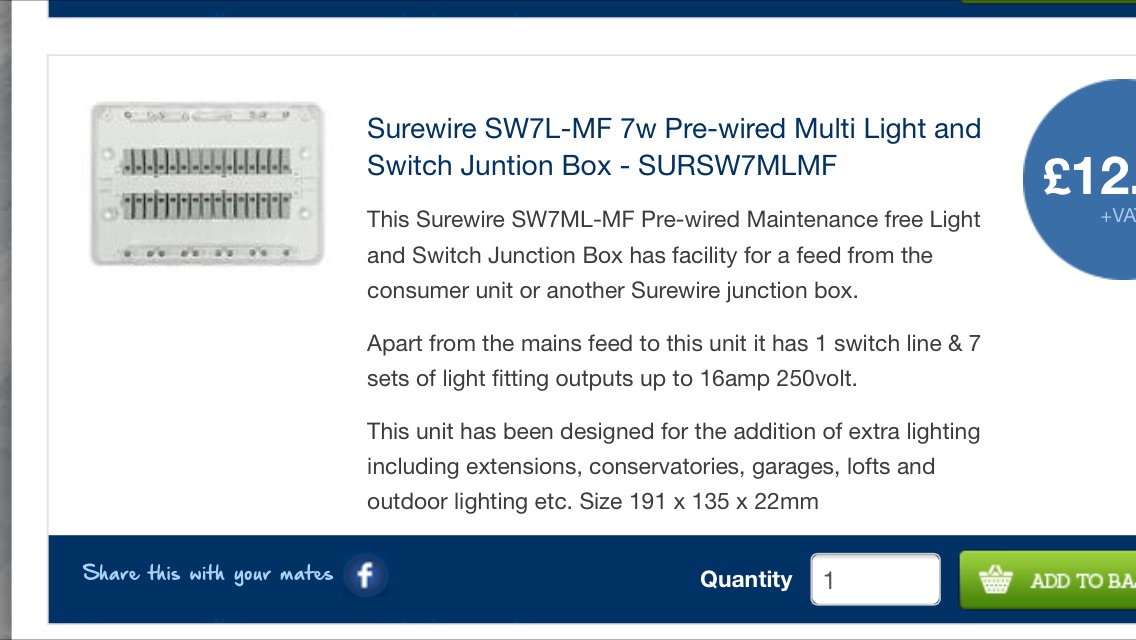

So your saying I don't need a junction box ? The ceiling rose has a live and neutral terminal ?
If I get a new improved JB and link the circuit I'm working on it gives me experience to link all the other lights when I'm ready to do that what is the problem I'm just trying to learn like anyone what's so bad I've draw you a circuit that you said would work if I can draw it I understand it :/
Could this be used to "divert" the live to a switch?
Possibly, and back again.
There are several configurations obtainable so it depends what you need.
It is anyone's guess what is happening inside your present junction box with twelve cables and a maximum of six connectors.
