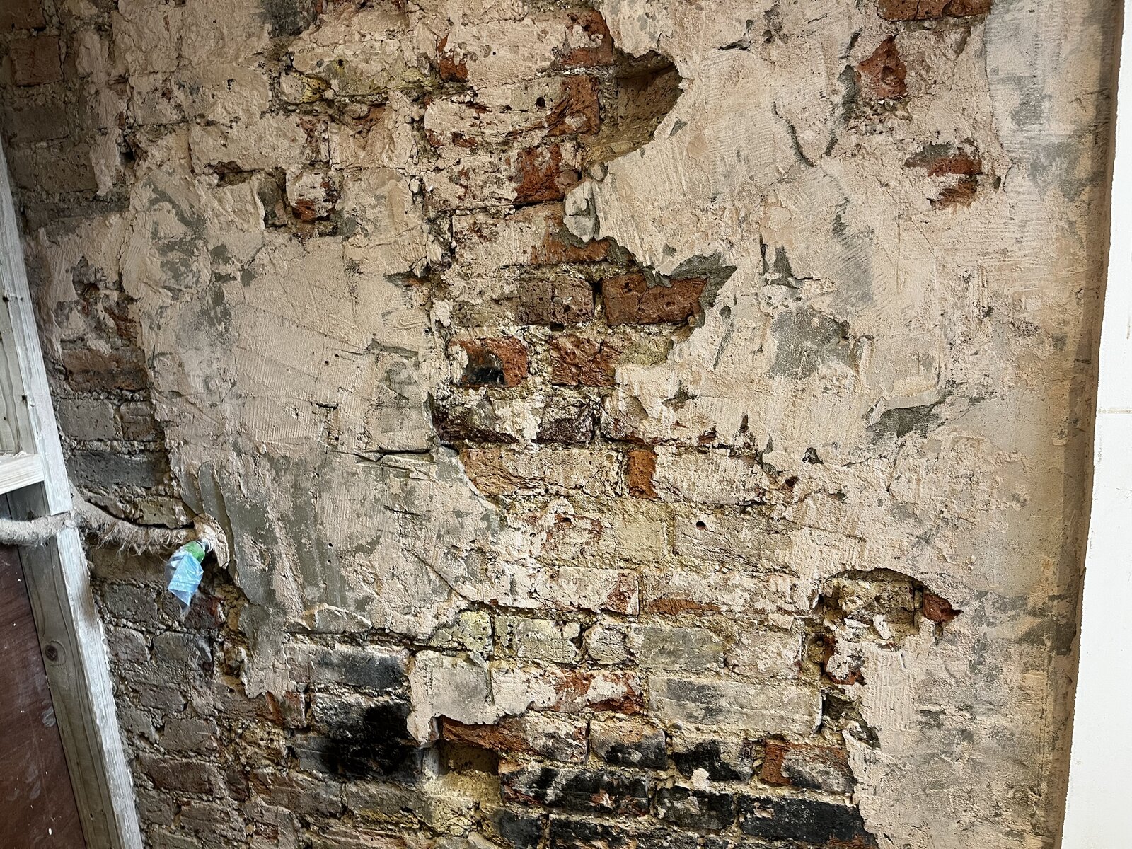

I’ve finally managed to carve out time to reinstall the shower in our main bathroom, which developed a leak. On investigation, it turns out this was yet another botched install — plasterboard in the wet zone, tiles dot‑and‑dabbed directly on, and a few other horrors.

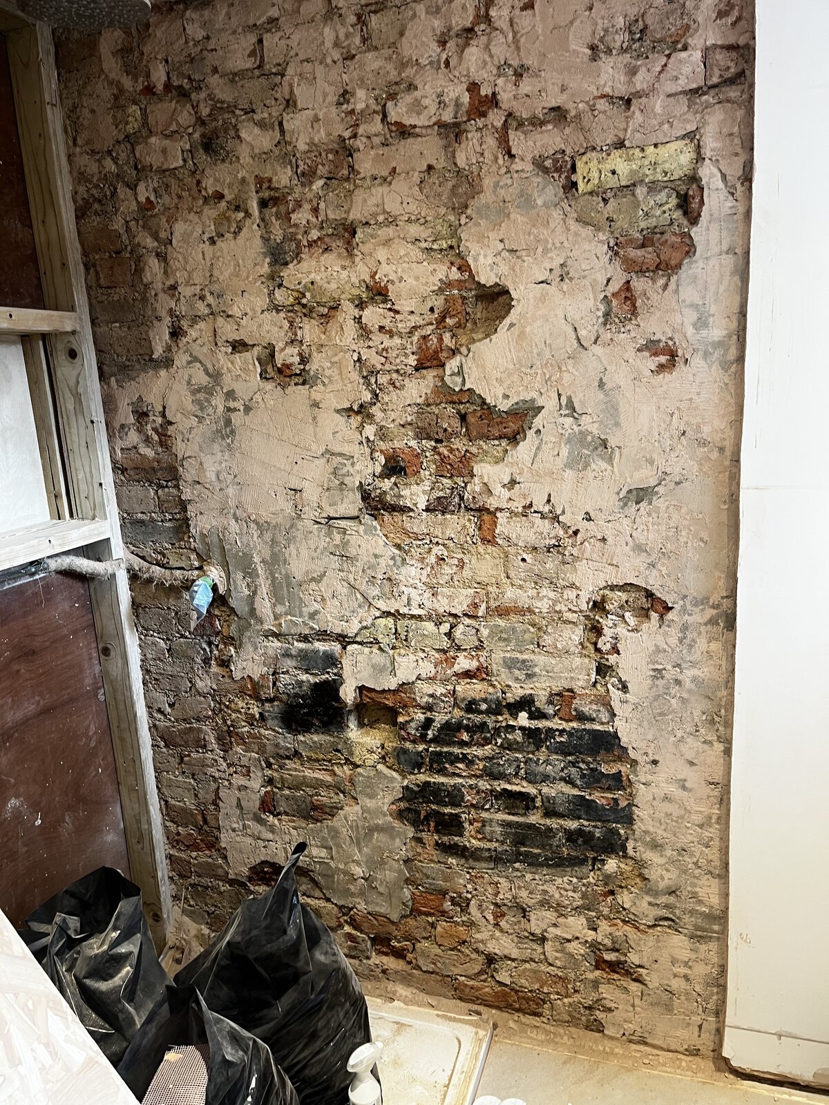

The attached photos show the current state. I’ve treated the walls for mould, but the black staining hasn’t shifted with strong bleach/mould treatment, so I suspect it’s soot from an old chimney — the house is 100+ years old.
My plan is to use Abacus Elements backer boards on both shower walls. The main challenge is the rear brick wall:

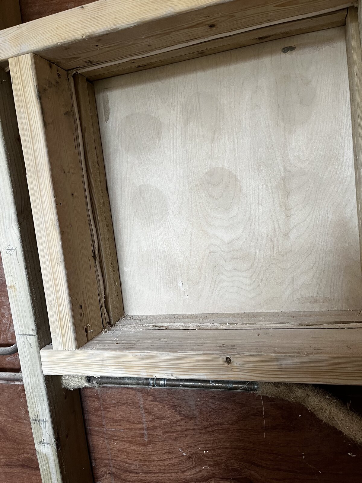

I plan to include a tileable, waterproof niche on the other wall in the niche cavity shown in the photos. As you can see, it has some gaps internally — would you recommend closing this off internally with marine ply before installing the niche box, to prevent moisture getting into the stud cavity or something else entirely?
- Bricks are crumbly.
- I can’t remove more of the existing plaster/cement — when I try, chunks of brick come away.
- I only have 20 mm total to work with from brick face to final backer board face. The backer board is 12 mm (Abacus also do 6 mm, but I’d prefer 12 mm for stiffness).
- Prep wall – Stiff wire brush to remove loose material.
- Prime – Everbuild 503 SBR.
- Fill hollows – 4:1 sharp sand : cement + SBR mix for deep voids, allowed to cure ~24 hrs.
- Fix boards – Butter the back of the Abacus boards and comb Abacus KST‑Fix adhesive onto the brick with a notched trowel, then press boards into place.
- Mechanical fixing – Once adhesive is cured, add concrete screws and Abacus washers through boards into the brick for belt‑and‑braces fixing.
- Seal joints – Follow Abacus method with sealing tape and waterproof compound.
- Does the above approach seem sound, or is there a better method given the limited fixing depth and crumbly brick?
- Is Everbuild 503 SBR the right primer here, or is there a better option for bonding to dusty, old brick?
- Is Abacus KST‑Fix the right adhesive for this job, or would you recommend something else?
- Any other tips for getting a waterproof, bomb‑proof install on a wall like this?
