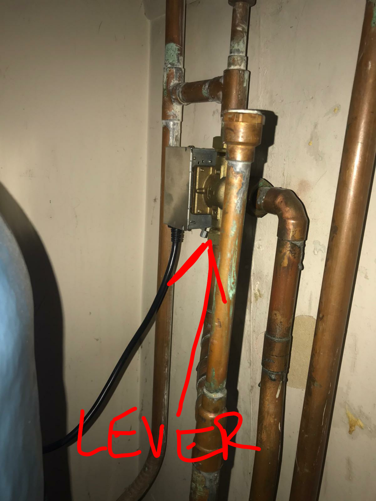

The bit you've taken a photo of certainly isn't a relay, it's a standard 3-port valve. The changeover lever is here. As others have said though, it won't fire up the boiler moving it to the manual position, it'll just let heated water through to the radiators when the boiler fires up.

That is definitely NOT a relay, it is a 3-port valve - forget the word 'relay' your boiler guy didn't know what he was talking about.
The 3-port comprises two main components, the actual water valve and the head or proper name the electrical motorised actuator. On the side of the actuator is a lever (not a switch) moving that will manually open the valve and should cause the boiler to fire up and heat the radiators. Moving that, may even free it up to work normally if it was simply stuck.
The actuator is supposed to turn the valve, to the correct position to supply either HW, or CH, or maybe even both at the same time.
Roughly how it works is - Your HW thermostat or CH thermostats click on with a demand for heat, those signals then go to the actuator, the actuator then turns the pump and boiler on once it has moved the water valve to the correct position.

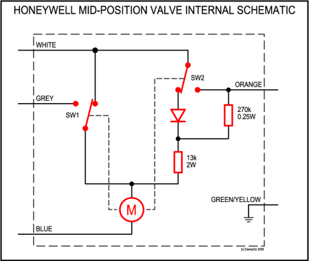

The motorised valve has V3 micro switches inside it that can stick causing the fault you have, some times as a temporary fix if you latch the bleeding leaver over the heating will work again, however when summer arrives you will find the radiators get warm when the DHW is heated, so only a temp fix.
With the two port valve it acts as a relay, but with the three port valve it is more complex than that, this is how it is wired inside the valve

The guy who came to repair the system it seems was not a heating and ventilating engineer, anyone trained to over level 3, i.e. an engineer would have known that was a motorised valve, not a relay, I will admit as an electrical engineer the first time I came across the Y Plan I found it hard, as those resistors and diode inside the unit gave me reading I had not expected. But it was not really my job, although it was a micro switch failed, normally either the motor or whole valve is changed, depends if you can get the motor head on it's own.
Must admit I was bamboozled the first time I had to fix my own heating system, there is nothing conventional about how those 3-port actuators function. They are a rather clever design, to make them cheap, simple to make, simple to install, but not much to them once you study the diagram and fix a few.

Holly - Turn both the room and the hot water cylinder thermostats to maximum and try moving that lever on the 3-port. Then let us know the result, if the boiler fires and you get some heating. You will have to control it manually, turning the whole heating system on and off via the switch, but at least you will have heating and in the meantime can get a proper engineer out, telling him you have an issue with the 3-port actuator.

As the boiler and pump are obviously working when the valve is closed (De energised h/w position). It is my experience over a long working career that 99% of the time it will be a failed motor. Stalling them in the mid position for long periods even when in off periods cannot help.
I used to buy 10 per month when I had a Housing Association maintenance contract.
Well they are stalled by putting them on a DC supply (diode) and via a dropper resister, so maybe not all that drastic. Which component fails first, is maybe down to the make and model of actuator.
