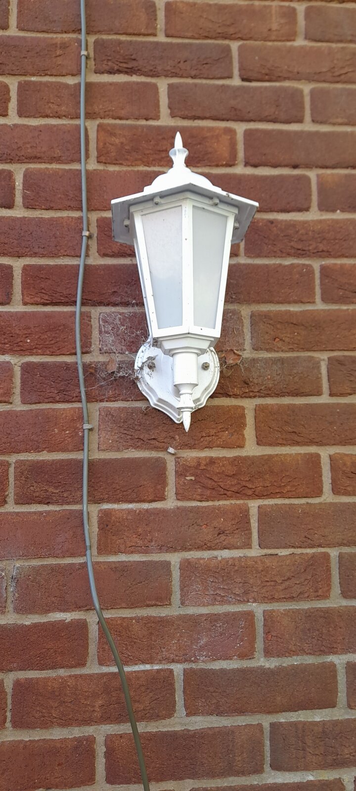

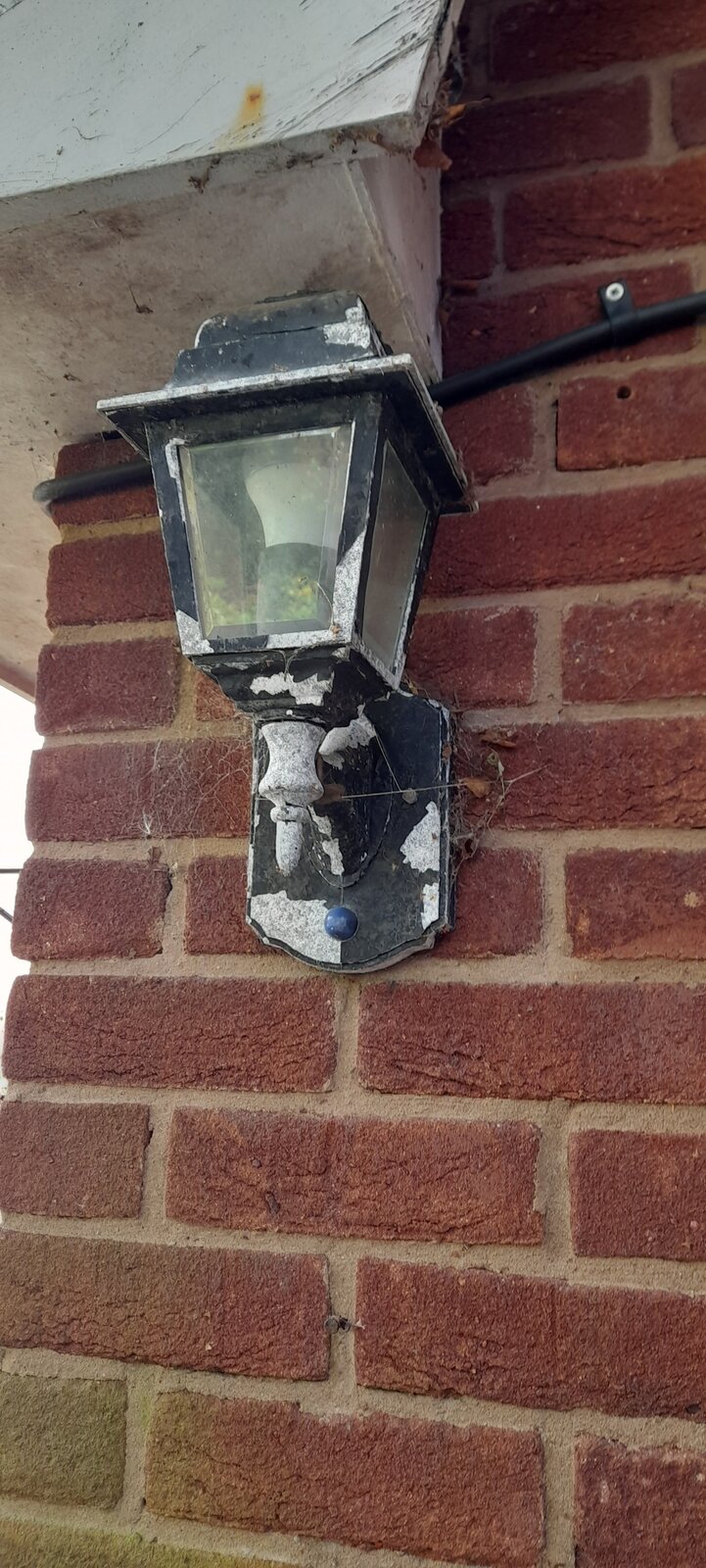

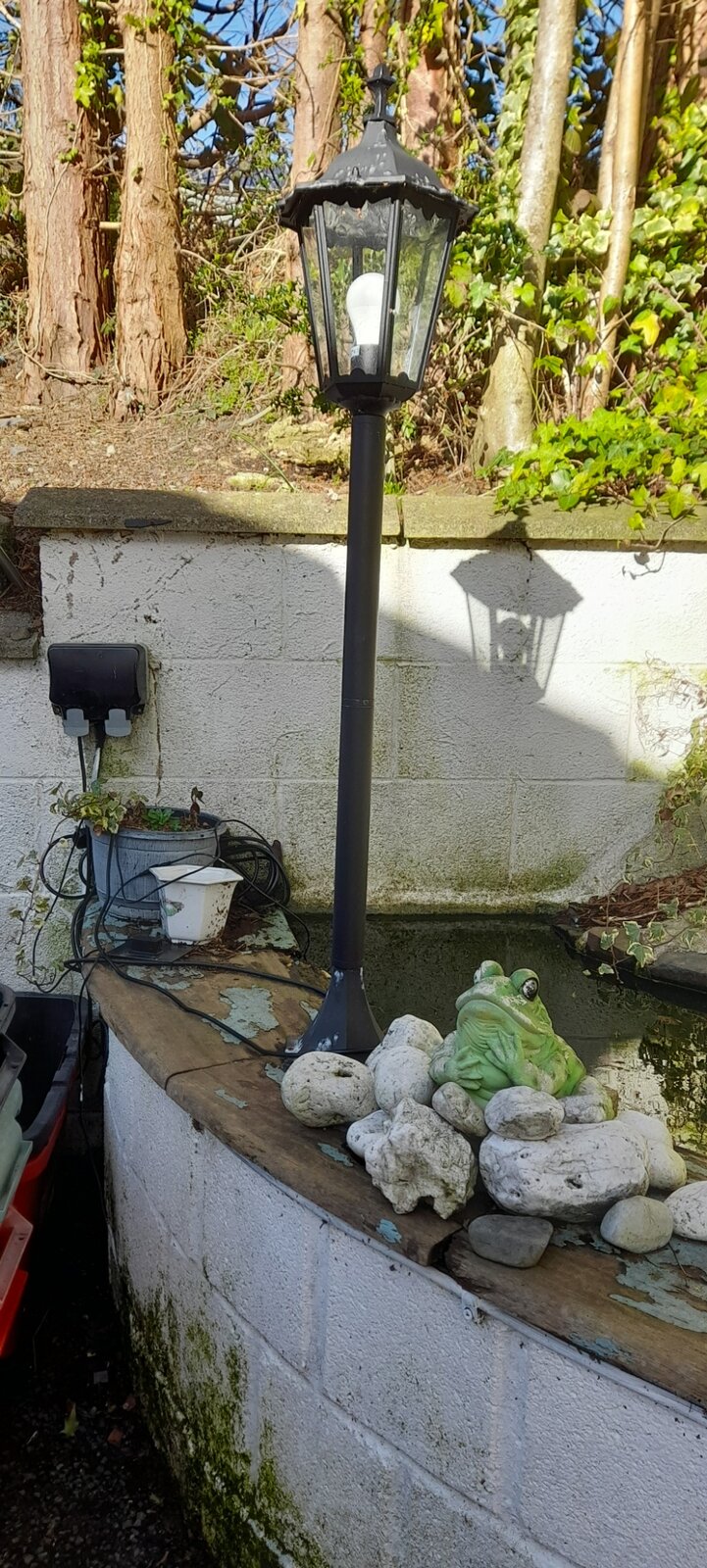

I find most have the PIR on the bottom. 1740483575113.jpeg But if placed where they have some protection from the weather, still work OK, without a PIR often all electrics at the top, 1740483692197.jpeg so it would need to be full to the brim of water for it to matter, the same when on a post 1740483861347.jpeg the water may get in, but will also get out before it causes damage. The second pictured lamp cost me £4 with integral lamp, not what I would normally go for, but has proved good, as light directed where wanted, the last one I modified putting silver foil in the top to redirect the light down.

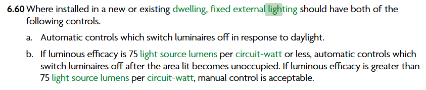

Yes very true, I did the same many years ago with the paths between us and next door, used a 6 watt CFL from Ikea as the boiler would trigger the PIR, Part L approved document states.
So with my lighting in the main, I can set dusk until dawn, or other set times, and it only says you should have the controls, it does not say you must use them, and technically I suppose my control does not comply as it responds to when the Internet says daylight should start and finish not directly from daylight.
But the lights turning off while I am halfway up the steps from where I park the car to the kitchen door I regard as dangerous, so turning on with my phone and off with voice control to me is far safer. And in the main it was the PIR which failed, not the lamp, so a lamp without a PIR is a lot less likely to fail.
