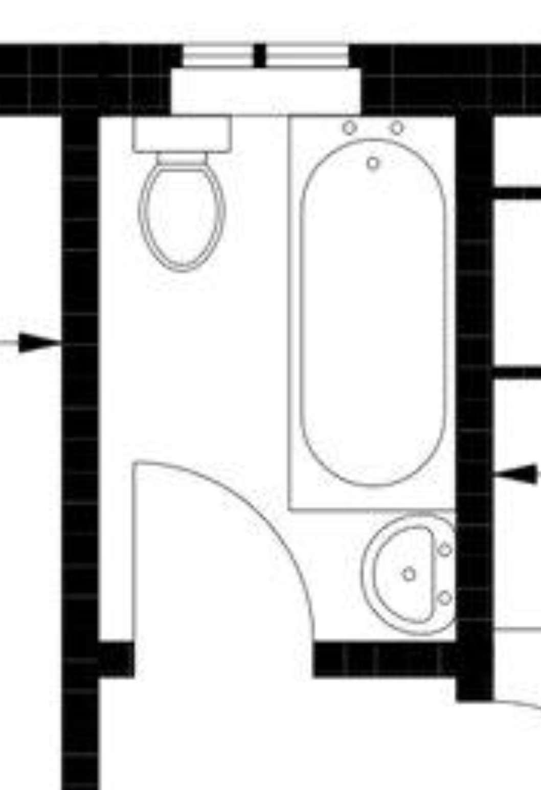

Hi everyone
I want to relocate the toilet from where it is and move it next to the sink.
How hard it will be? And how much would cost if done by a plumber?
It's a concrete floor.
Thank you

There is a bath, a wall and a door in the way. Some more explanation is needed.

The bath will be removed and became just a shower close to the window.
So the toilet would be between the shower and the sink.

Is the soil stack outside by the window, does current pan outlet go down through the floor or straight out of the wall behind it?
For rough costs need to know roughly where you live, city, town or in the sticks somewhere.

Dont worry, I'll not expose myself :)
Yes, the soil sack is just outside the left side of the window. The pan outlet goes through the floor.
The toilet would be moved between 1.5 / 2 m diagonal from where it is.
The wall where we want to move is a fake wall
We live in London, Greenwich
So new soil pipe will run under the shower tray (?) at around £250 a day for London labour charges I think I would just replace bath for shower or put shower over bath if it is the only bath as some people still like a bath and would be put off buying the house if you decide to sell up and move.
