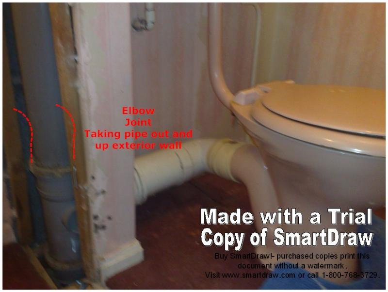

I hope I've done this right but I have attached a few of pictures to try and make it clearer.
Excuse the crudity of the drawing.
Option 1
Taking the soil pipe outside and up the exterior wall
Option 2
Rerouting the soil pipe vent across to the side wall and up into the loft to reconnect back to original exit in the roof. According to building regs it seems I could reduce the venting portion of the pipe to 75mm.

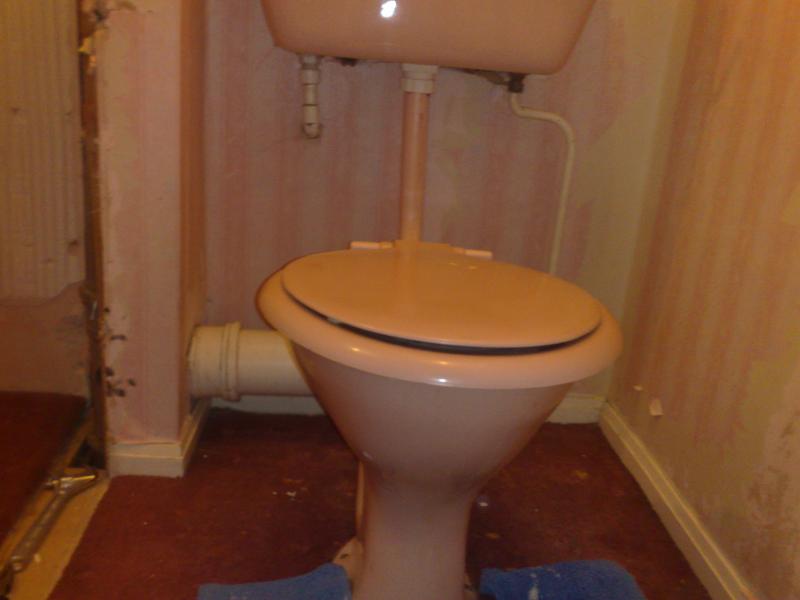

Also another view of the area:
Thanks in advance for your opinions and advice,
Daz
The vent should really be on the vertical part of the stack so I would go with option 1 but it’s not exactly elegant; check the BR’s with regard to location of the outside termination of the stack & any windows. Do you have another open stack on the system? If so you could cap off & terminate inside with an AAV but it must terminate above the highest overflow so you will still be left with a stub stack in the centre of the room.

I've read the Building regs and even emailed building control who replied back:
"I am sorry but we are unable to answer your querie as we can only comment on work not covered in the Building Regulations.The only advise I can offer is as long as you keep the vent open if it is terminating outside,or fit an air admittance valve if it terminates in a roof space."
Hmm not particularly helpful and I thought the whole idea of their department was to know things like this! It does not mention anything in the building regulations about rerouting a vent pipe. It does mention about the height of the end of the pipe from windows and loft space etc... But I am ok with that aspect as option 1 would just mean I would take the pipe up the side of the house to the height it is currently. Option 2 would reconnect to the exisitng exit anyways.
I am a little surprised that the reply suggests fitting an air admittance valve in the roof space though as seeing as it's the only soil pipe that doesn't quite sound right to me. Anyways, tis not something that helps me.
So by that answer I asume I could use either option.
