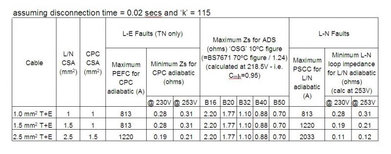

In an attempt to drag this thread back onto topic ...
The conclusion of the last few pages of discussion is probably that it is reasonable to assume a disconnection time of no more than 0.02 seconds, since it seems that will probably achieved by most/all MCBs with a fault current equal to the "Ia" of the MCB (e.g. 5*In for a Type B). What we have seen so far suggests that, at least with some MCBs, getting down to 0.01 secs may require a current higher than “Ia” (e.g. perhaps 6*In for a Type B, per Hager curves), and therefore would probably not be appropriate for calculations if one wished them to remain correct for all possible levels of fault currents.
On that basis, I have re-tweaked my earlier tabulation to reflect a disconnection time of 0.02 secs (and, to be conservative, I've used the reduced 'maximum Zs' figures which will probably come into force next year, and have also included 'minimum Zs' figures based on 253V, as well as 230V):
As can be seen (and as would be expected), on this basis the range of Zs values for which CPCs are adequately protected against fault current becomes much wider. For example, in terms of one of the early extreme examples we discussed, it appears that the CPC (and live conductors) of 1mm² T+E would probably be adequately protected by a B50 MCB for Zs values in the range 0.31&#937; to 0.70&#937;.
Kind Regards, John

John, The discussion has always been on track and, due to the discourse that has taken place and feedback you have received, you have revised the figures you believe acceptable for minimum Zs downwards from 0.63 to 0.28 ohms in your latest table (in the case of 1+1 T&E). Therefore, you must believe that the discussion is relevant and on track.
You sound a little defensive, but I was in no way being critical of you, nor was I underestimating the importance of the part of the discussions you initiated - which, as you say, have led me to feel that it is reasonable to examine CPC protection on the basis of an assumed disconnection time of 0.02s, rather than the original 0.1s. My comment about getting the thread back 'on topic' mean literally what it said - considering what the revised calculations meant in terms of fault protection of the CPC of an 'undersized cable' in which it was being assumed that overload protection was not required.
FWIW, on the evidence that we have so far seen, I don't think it is 'safe' to assume a disconnection time of 0.01s if one wants one's calculations to be generally applicable to all compliant circuits. The t/I curves from at least two of the three (and probably also the third) manufacturers we have seen indicate that a disconnection time of 0.01s is not necessarily achieved at a fault current of just "Ia" (i.e. for a circuit just compliant in terms of ADS), whereas all three would achieve 0.02s at that current.
